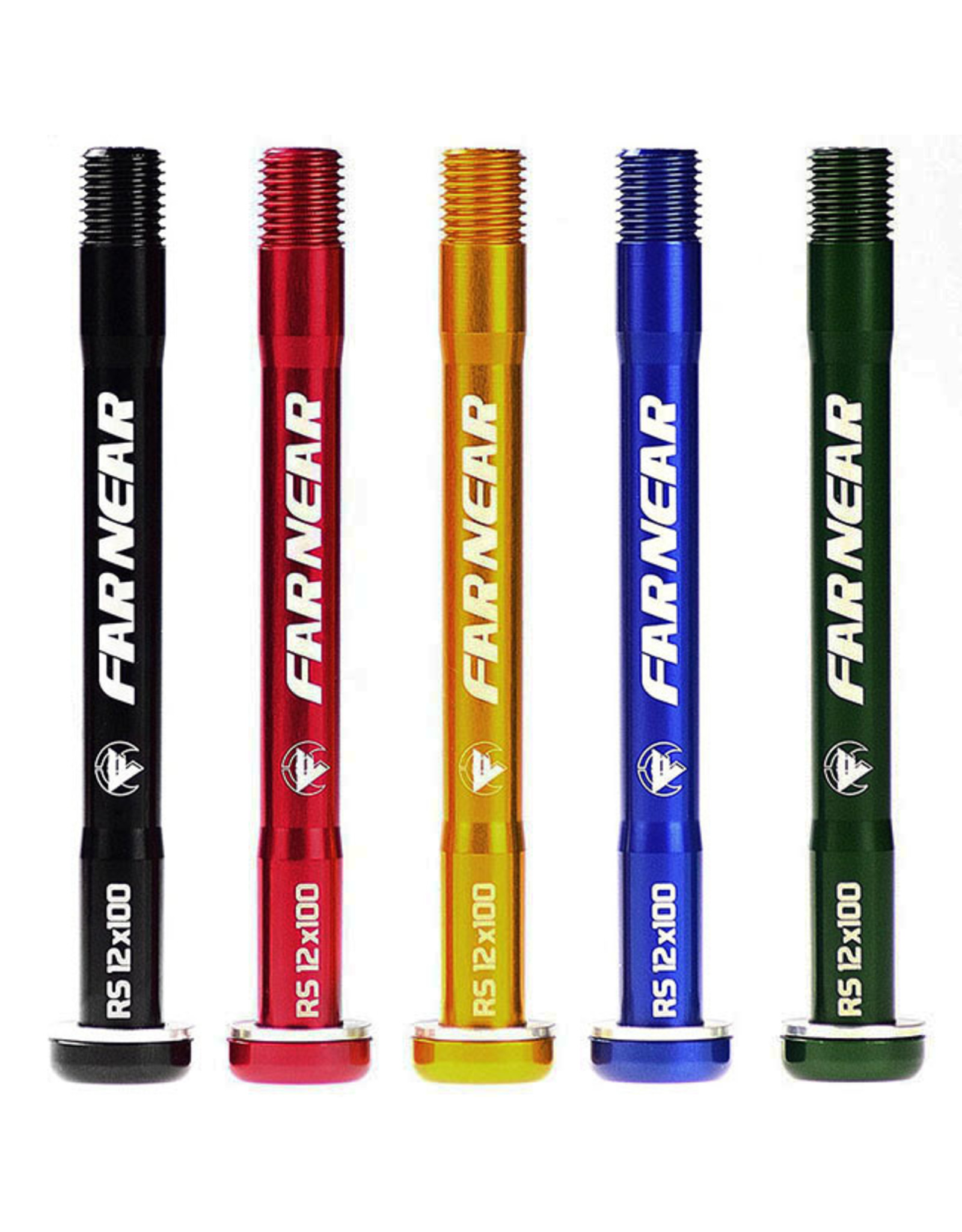

Far and Near provides a comprehensive range of components to meticulously coordinate every element of your next bike build. Their commitment to simplicity and functionality ensures that each part is not only elegant but also highly reliable.

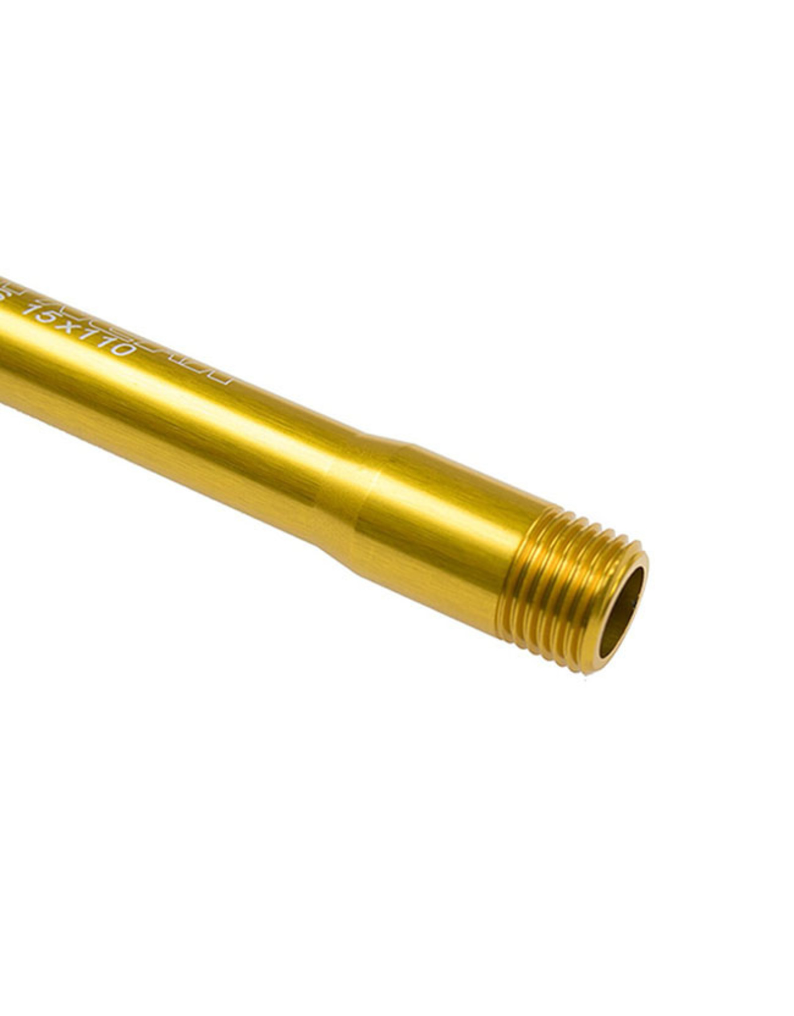

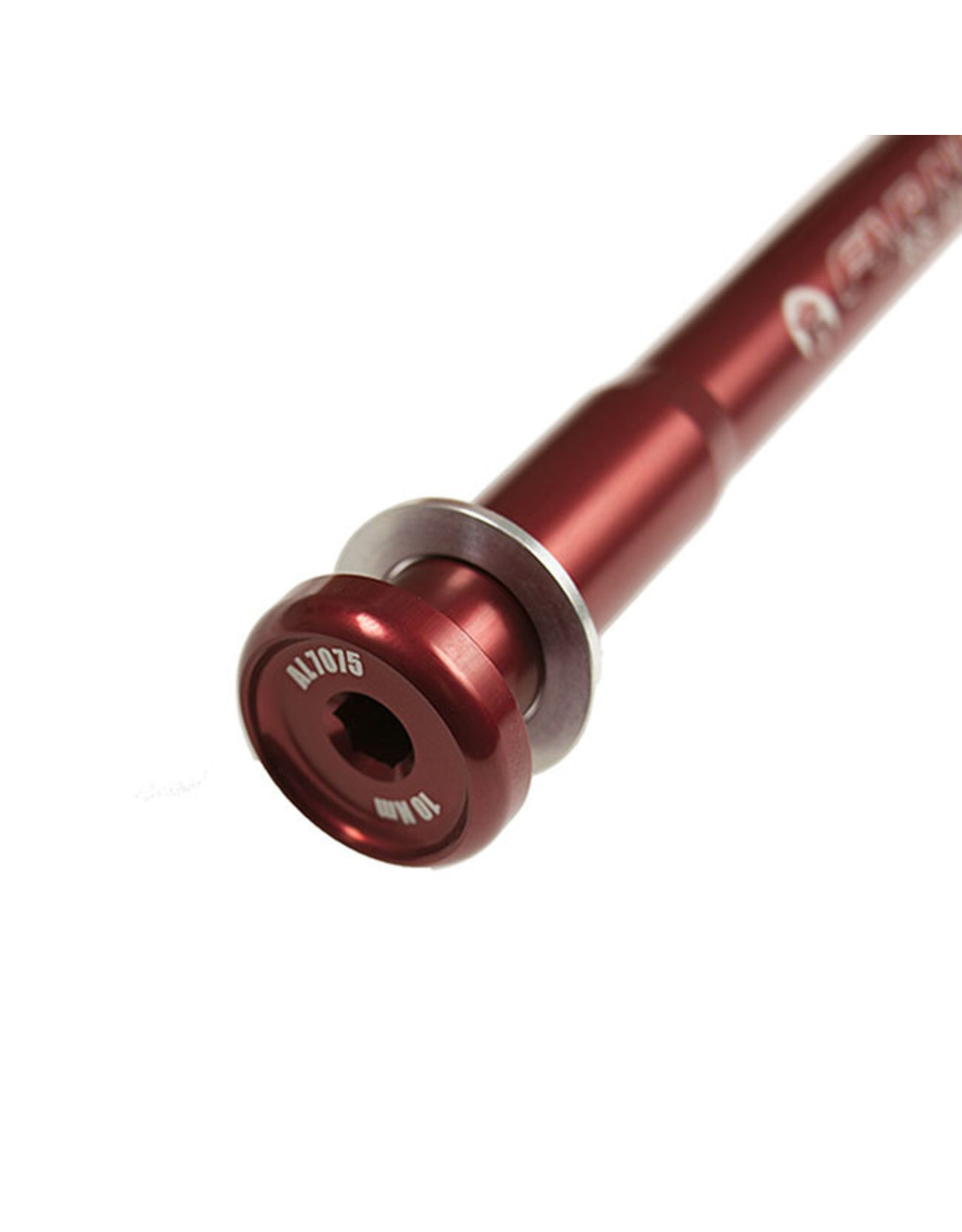

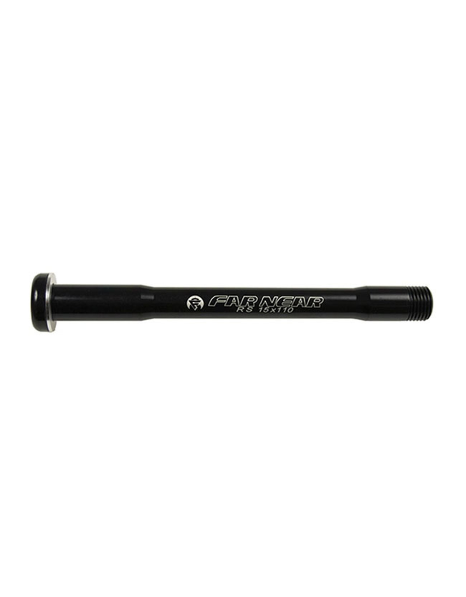

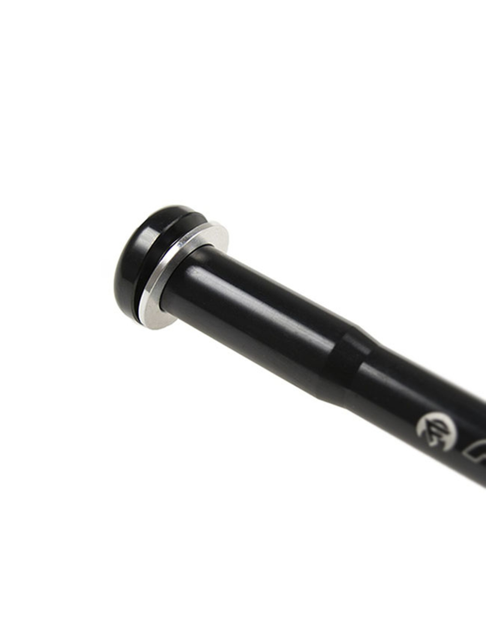

One of their standout offerings is the low-profile thru axle, available in the two most common designs for Fox and Rock Shox. Crafted from robust 7075 Aluminum and anodized in rich hues, these axles feature a sturdy head and deep 6mm allen wrench grooves, ensuring a secure fit once installed. Additionally, their tapered design in the center reduces weight without compromising strength, making these axles capable of withstanding the most demanding riding conditions.
For complete sizing details on all of our thru axles please look HERE
| Model | Interface | Length | Pitch | Thread Length | Weight |
| Fox | Flat | 146 mm | 14 x 1.5 mm | 13 mm | ~37g |
| Rock Shox | Flat | 147 mm | 15 x 1.5 mm | 11 mm | ~37g |
| Fox Boost* | Flat | 155 mm | 14 x 1.5 mm | 13 mm | ~39g |
| Rock Shox Boost* | Flat | 155 mm | 15 x 1.5 mm | 11 mm | ~39g |
| Material | 7075 Aluminum | ||||
| Tool Fitting | 6 mm Hex | ||||
| Hub Compatibility | T/A 15 x 100 | T/A 15 x 110* | ||||
| Recommended Torque | 10Nm | ||||
