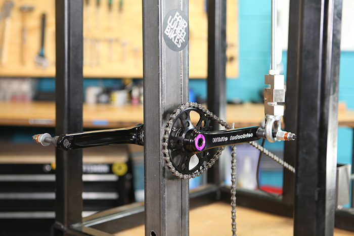

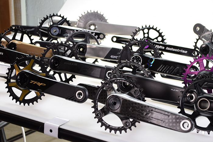

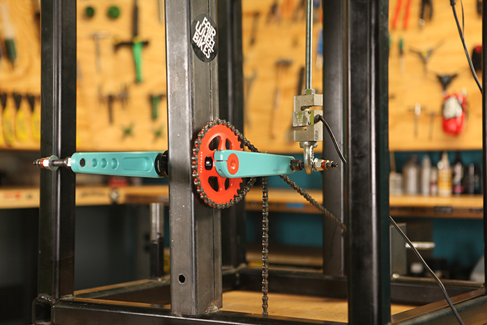

After months of collecting really cool mountain bike cranks we decided it was time to treat all of you to one of our famous 'crank stiffness tests' where we put a bunch of cranks in our jig, test them, crunch the numbers and leave the results so that you can choose your next dream crankset.
After a 2 year break we are back with a new crank test.

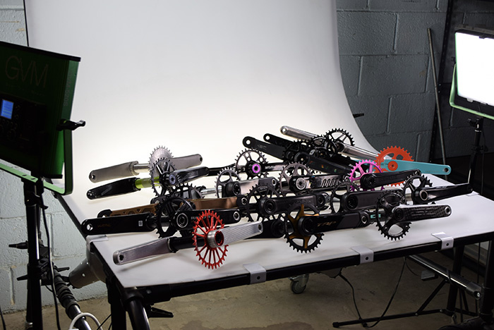

This time we decided to throw some of the most popular mountain cranks in the test jig, and see what the results are. We reached out to many different manufacturers and ended up with a great group of 24 cranks! Some chose not to be a part of the test, some never got back to us at all, and although this is not a totally comprehensive collection of what is out there, we do plan on continuing to get more cranks to test, and releasing updated test lists in the future.

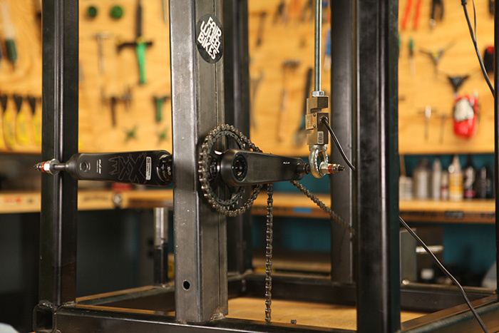

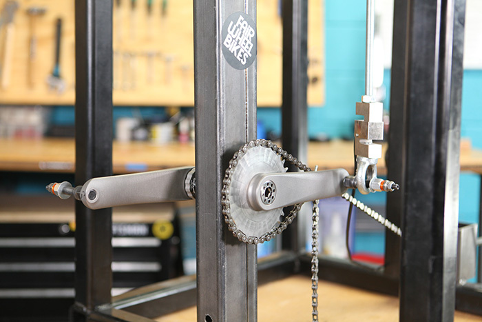

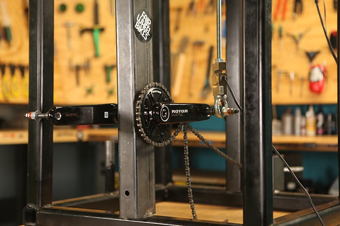

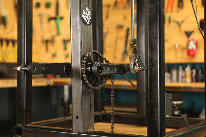

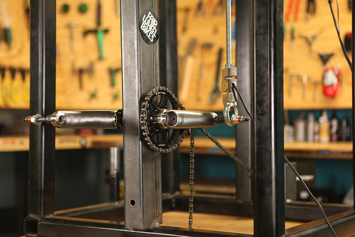

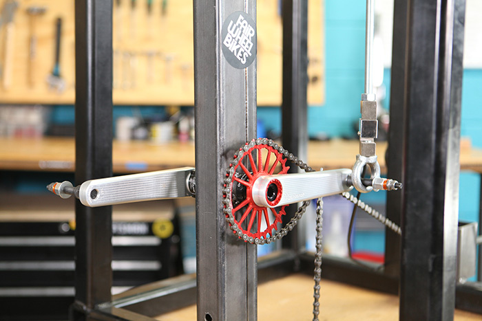

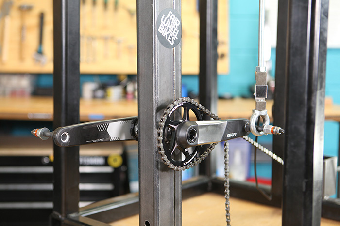

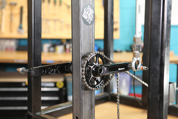

To bring consistency to the test all cranks tested were 170mm in length and we used 32 tooth chainrings on all of them as well. For each crank we will you give you all the important specs; deflection for both sides, as well as average deflection, the weight for each part of the system as well as total system weight, stiffness to weight, price, which lengths are available and Q-factor.
Enjoy the results!

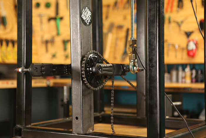

Appleman 2 x R
Shimano Image 1
  • - D.S Deflection: 7.99mm
  • - N.D Deflection: 10.27mm
  • - Avg. Deflection: 9.13mm
  • - Arm/Spindle Weight: 565.7g
  • - Chainring Weight: 81.9g
  • - Total Weight: 647.6g
  • - Stiffness To Weight: 1.7
  • - Price In USD: $600.00
  • - Sizes: 100mm-175mm
  • - Q-Factor: 168mm

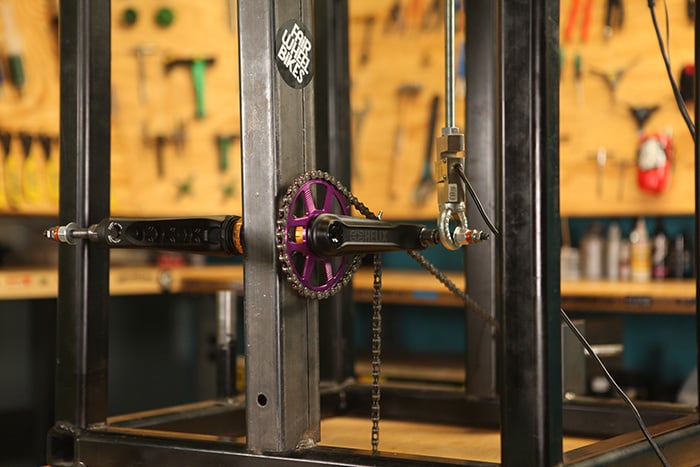

Cane Creek eeWing
Shimano Image 2
  • - D.S Deflection: 6.84mm
  • - N.D Deflection: 9.07mm
  • - Avg. Deflection: 7.96mm
  • - Arm/Spindle Weight: 412g
  • - Chainring Weight: 68.3g
  • - Total Weight: 480.3g
  • - Stiffness To Weight: 2.62
  • - Price In USD: $1270.00
  • - Sizes: 160mm-175mm
  • - Q-Factor: 176mm

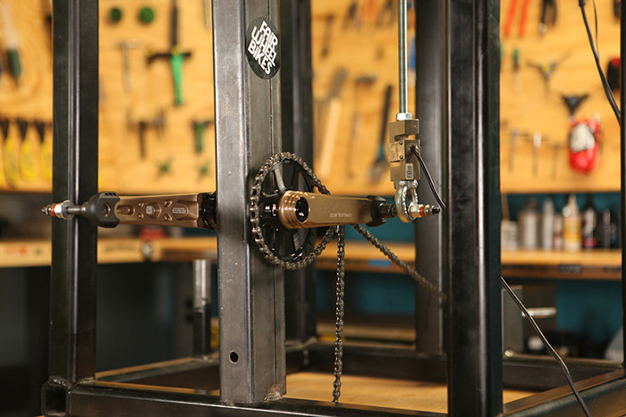

EliLee X310
Shimano Image 1
  • - D.S Deflection: 8.9mm
  • - N.D Deflection: 11.8mm
  • - Avg. Deflection: 10.36mm
  • - Arm/Spindle Weight: 316.1g
  • - Chainring Weight: 53.7g
  • - Total Weight: 369.8g
  • - Stiffness To Weight: 2.61
  • - Price In USD: $500.00
  • - Sizes: 155mm-172.5mm
  • - Q-Factor: 162mm

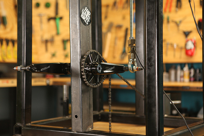

FSA Gradient
Shimano Image 1
  • - D.S Deflection: 6.65mm
  • - N.D Deflection: 9.02mm
  • - Avg. Deflection: 7.84mm
  • - Arm/Spindle Weight: 568.6g
  • - Chainring Weight: 74.7g
  • - Total Weight: 643.3g
  • - Stiffness To Weight: 1.98
  • - Price In USD: $400.00
  • - Sizes: 165mm-175mm
  • - Q-Factor: 177mm

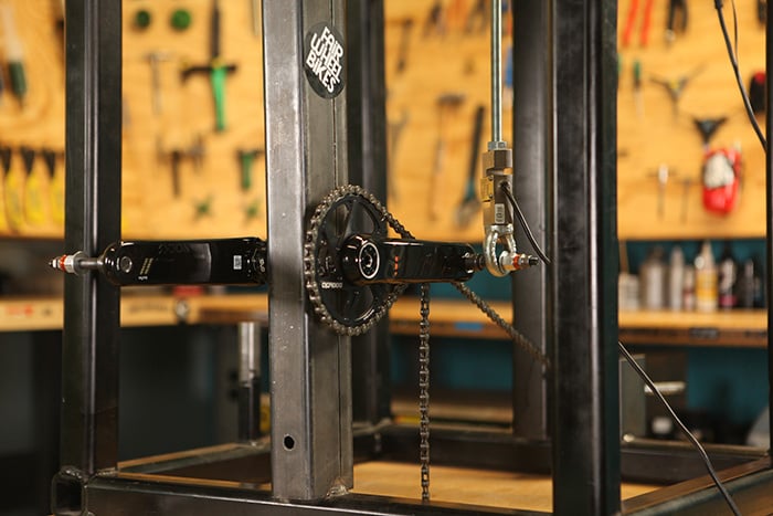

Garbaruk XC
Shimano Image 2
  • - D.S Deflection: 8.1mm
  • - N.D Deflection: 10.42mm
  • - Avg. Deflection: 9.26mm
  • - Arm/Spindle Weight: 402.2g
  • - Chainring Weight: 52.7g
  • - Total Weight: 454.9g
  • - Stiffness To Weight: 2.37
  • - Price In USD: $560.00
  • - Q-Factor: 170mm

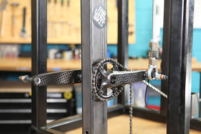

Grigio Carbonio
Shimano Image 1
  • - D.S Deflection: 7.37mm
  • - N.D Deflection: 10.69mm
  • - Avg. Deflection: 9.01mm
  • - Arm/Spindle Weight: 266.6g
  • - Chainring Weight: 37.8g
  • - Total Weight: 304.4g
  • - Stiffness To Weight: 3.64
  • - Price In USD: $1925.00
  • - Q-Factor: 174mm

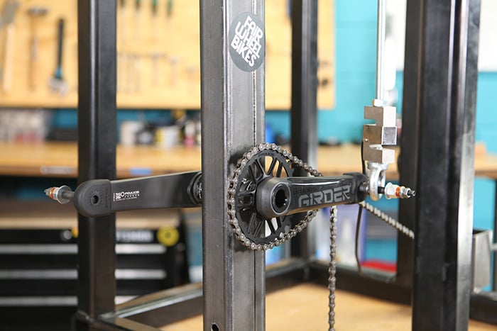

Praxis Girder HD
Shimano Image 2
  • - D.S Deflection: 7.06mm
  • - N.D Deflection: 9.71mm
  • - Avg. Deflection: 8.39mm
  • - Arm/Spindle Weight: 524.8g
  • - Chainring Weight: 57.4g
  • - Total Weight: 582.2g
  • - Stiffness To Weight: 2.05
  • - Price In USD: $380.00
  • - Sizes: 165mm-170mm
  • - Q-Factor: 178mm

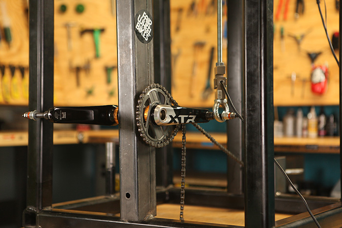

Shimano XTR 9220
Shimano Image 1
  • - D.S Deflection: 6.85mm
  • - N.D Deflection: 9.7mm
  • - Avg. Deflection: 8.28mm
  • - Arm/Spindle Weight: 527g
  • - Chainring Weight: 63.6g
  • - Total Weight: 590.6g
  • - Price In USD: $460.00
  • - Q-Factor: 176mm
