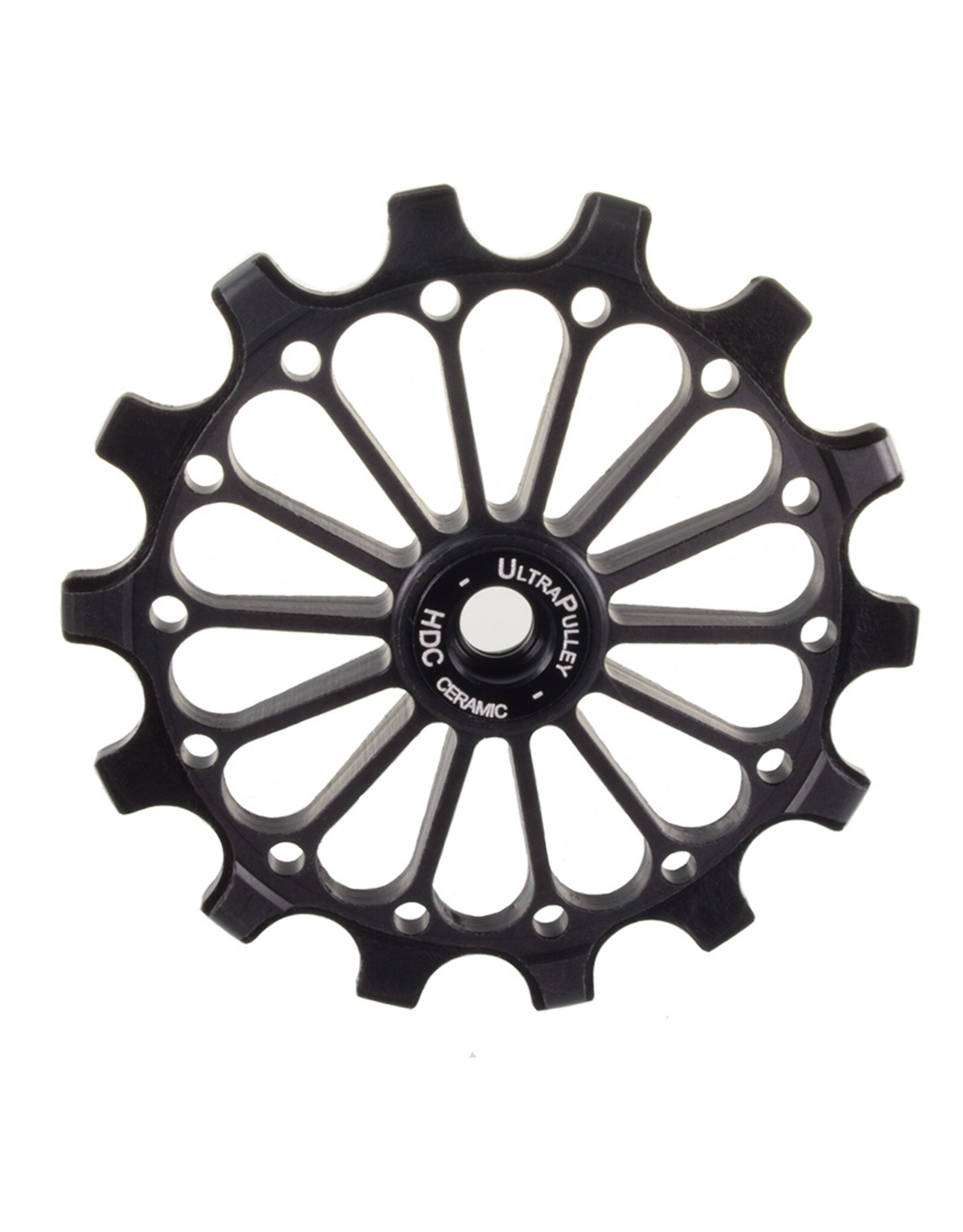

The Extralite UltraPulley (Single) provides the same world-class performance as the UltraPulley Set but allows individual replacement or tuning of specific derailleur pulleys. Machined and assembled in Italy, each pulley combines a self-lubricating hi-tech polymer body with 7075-T6 aluminum inserts and Extralite’s renowned twin-bearing system—two precision micro-ceramic bearings per pulley.
The result is a pulley that’s ultra-light, exceptionally smooth, and impressively durable. Low-friction 2RS seals keep out contamination while maintaining near-frictionless rotation. Available in both phased (PH) and non-phased versions across several tooth counts (11T–16T), UltraPulleys are compatible with Shimano, SRAM, and Campagnolo mechanical and electronic drivetrains (10–12 speed).
