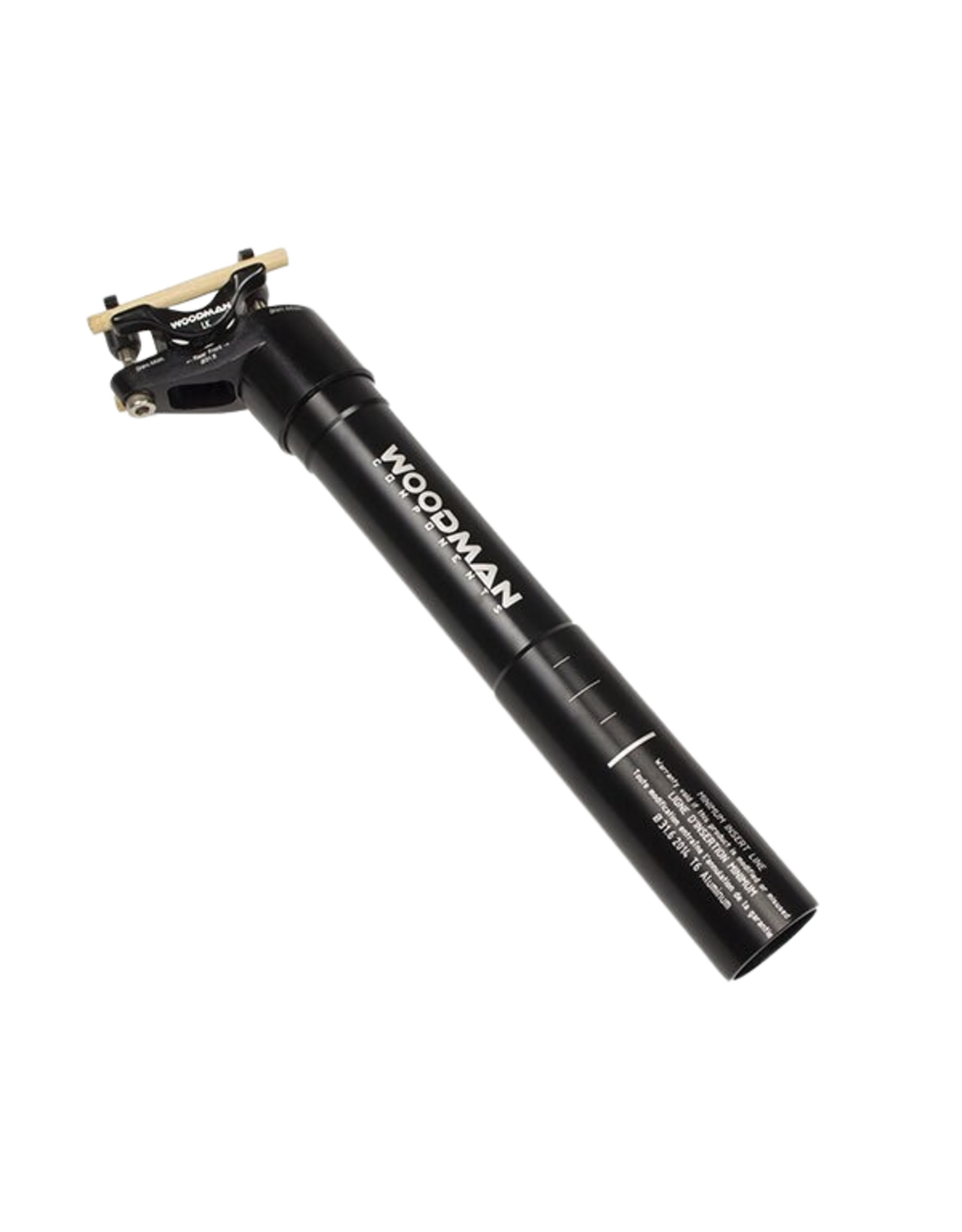

Woodman Post DX Seatpost is a lightweight alloy setback seatpost built for riders who want reliable clamp security, practical fit adjustment, and proven everyday durability. Machined from T6 aluminum and finished with titanium hardware, it offers a strong balance of low weight and long-term usability for road and light XC builds.

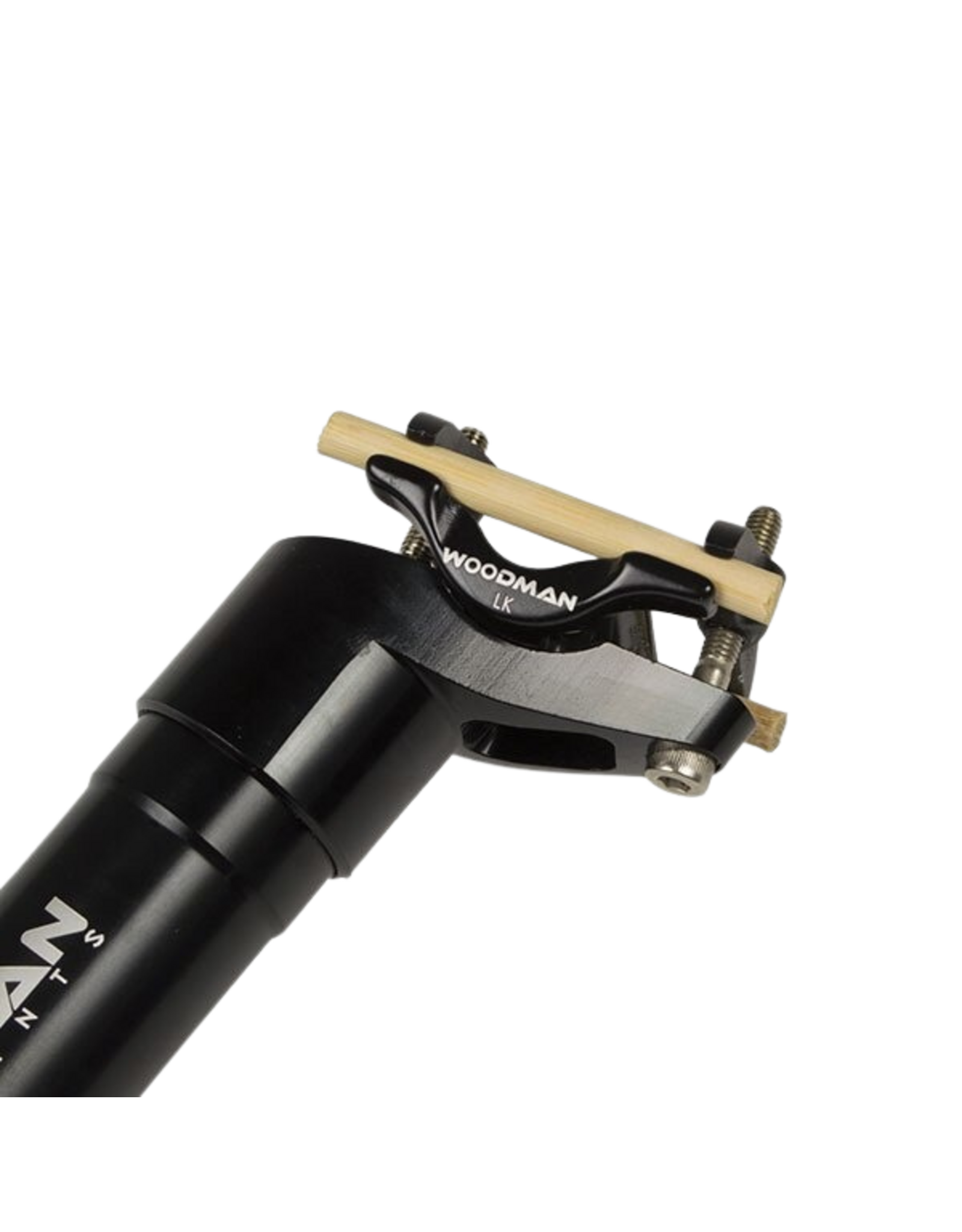

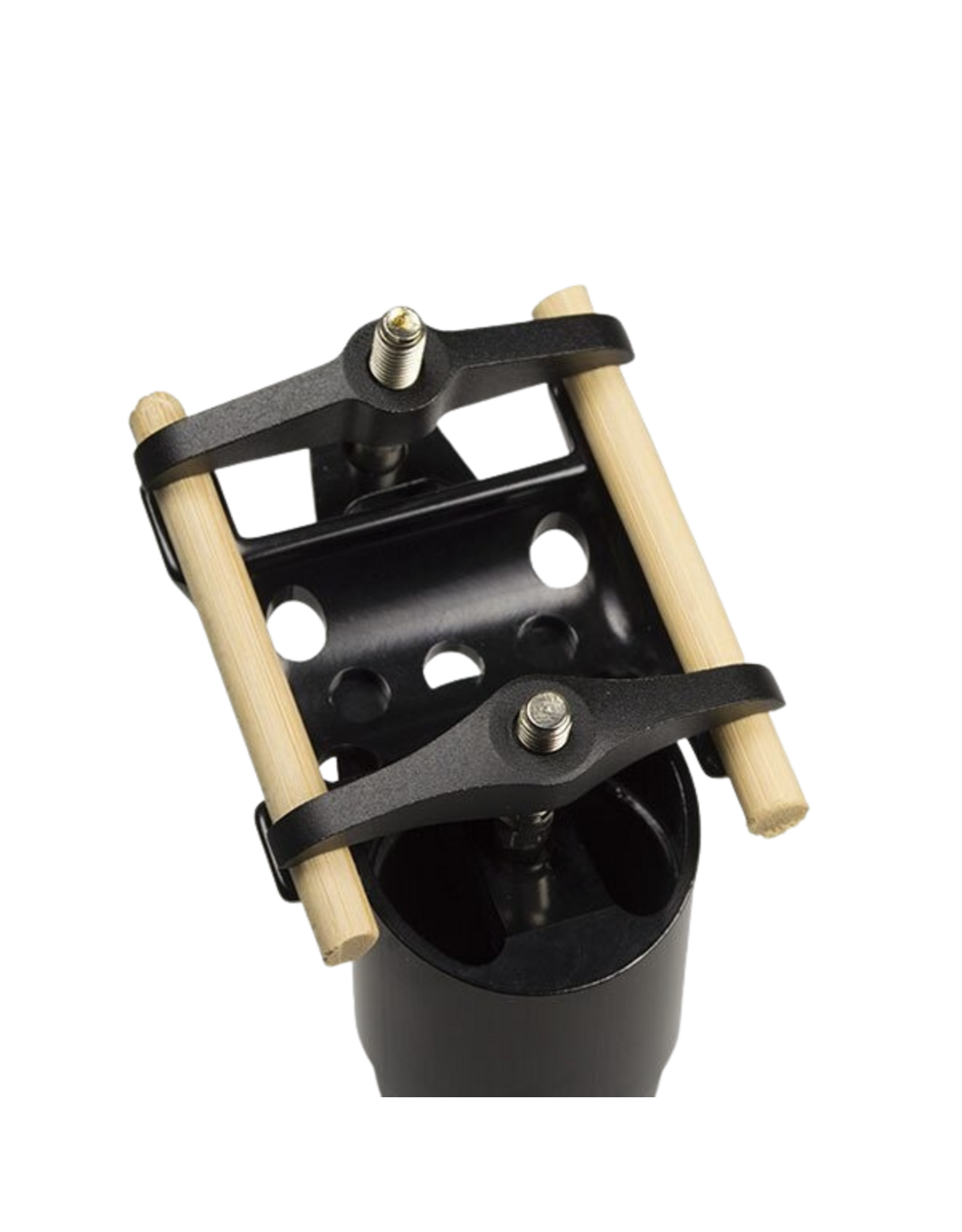

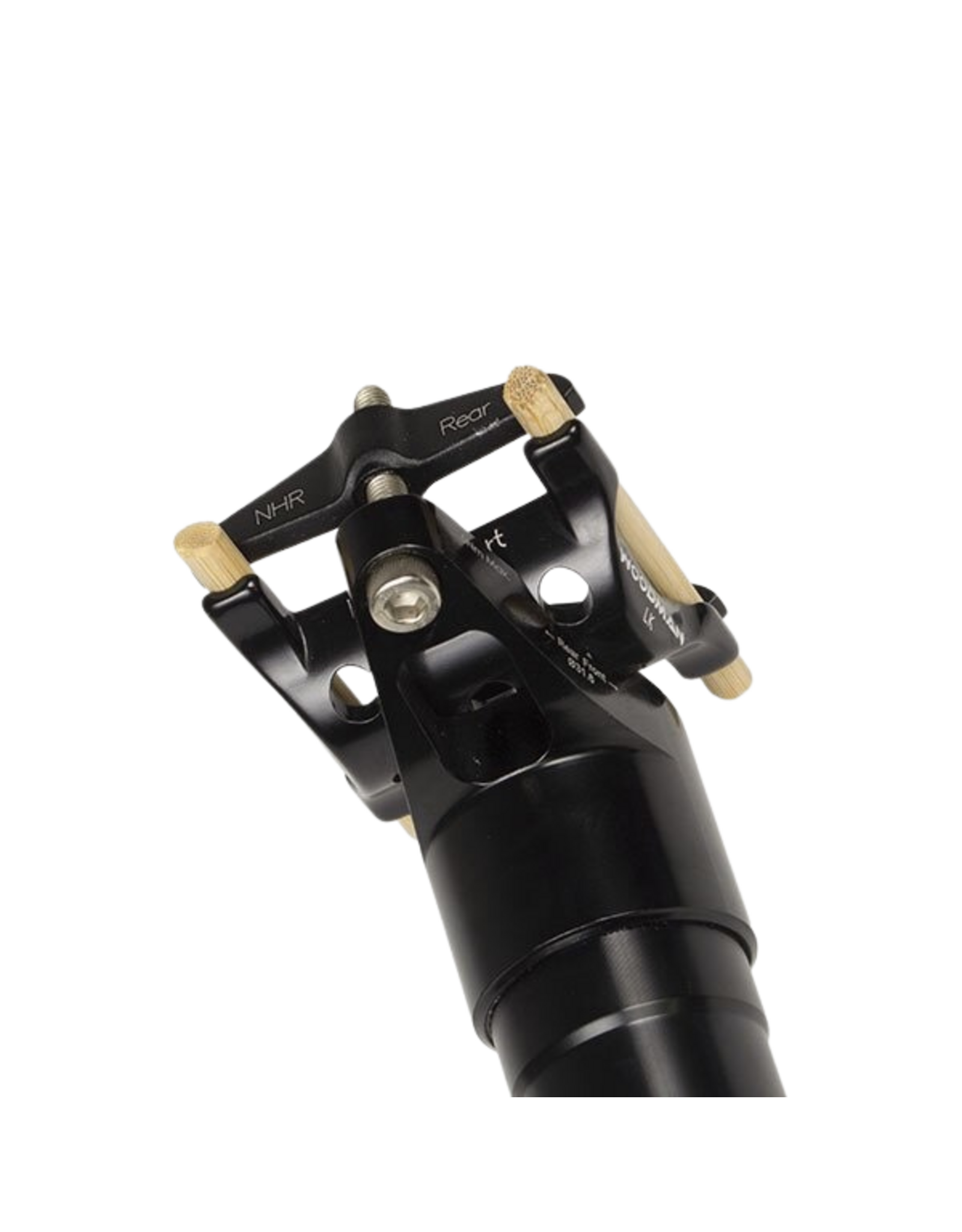

The tapered tube design removes material where possible while maintaining strength in higher-stress areas, and the 25 mm setback gives riders a more rearward saddle position for fit, comfort, and pedaling balance. Its cradle-and-yoke clamp supports both metal and carbon saddle rails in 7 x 7 / 7 x 9 / 7 x 10 mm formats, making it more versatile than many alloy posts in the same weight range.

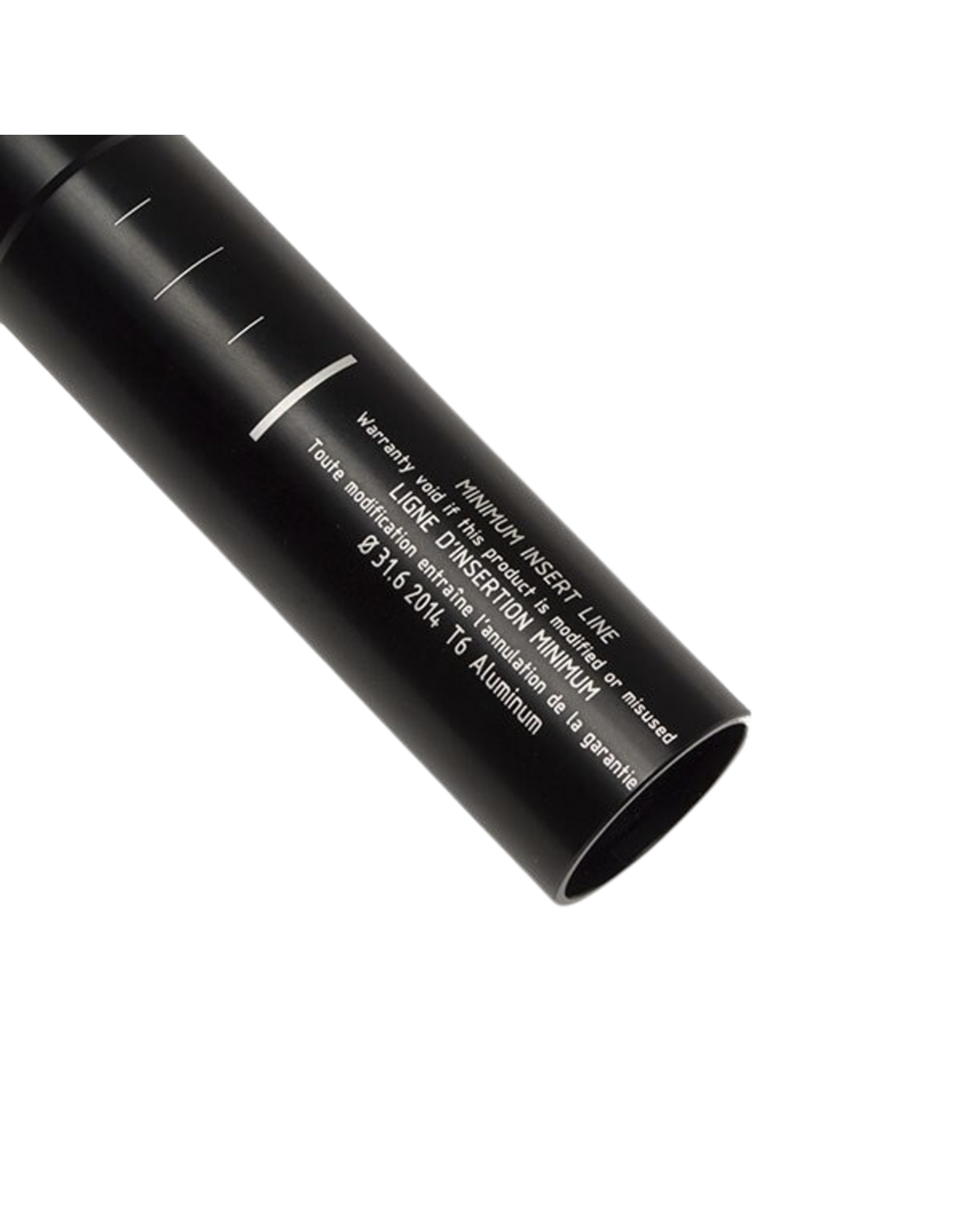

Important: Do not cut the seatpost. The clamping load is engineered around the original unmodified post length.
