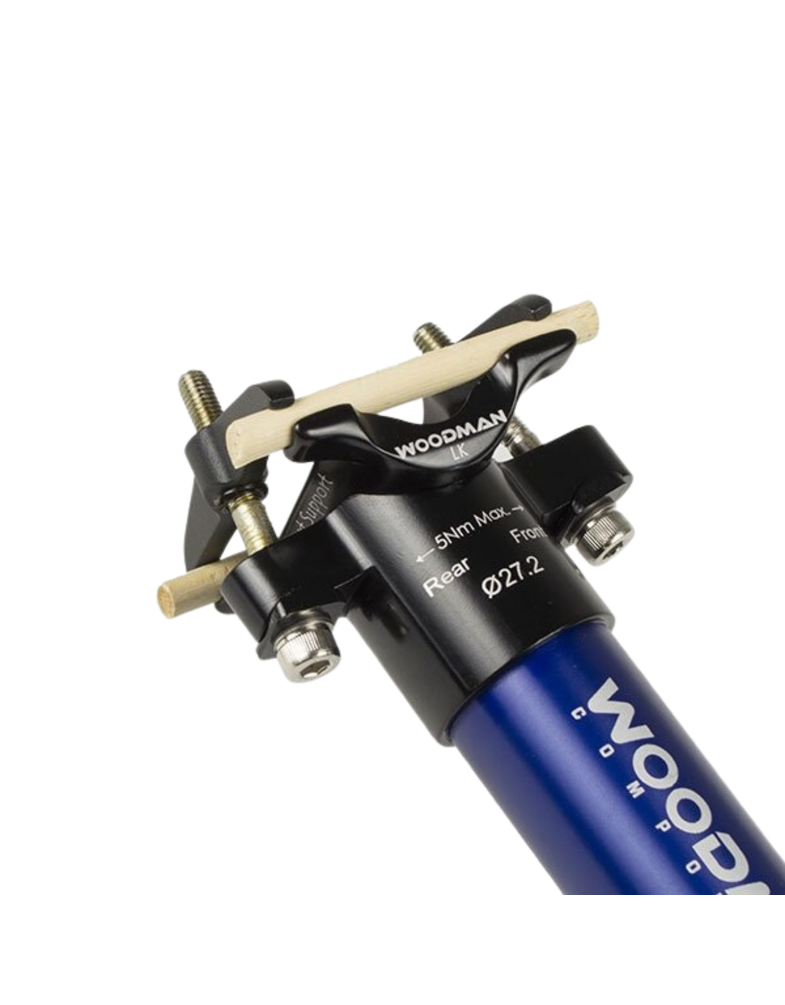

Woodman SL Plus Seatpost is a lightweight zero-offset alloy seatpost built for riders who want reliable clamp security, good saddle support, and a lower-cost alternative to carbon without giving up a refined design. Its 6061 T6 aluminum construction and CrMo clamp bolts keep the package durable and practical for performance-oriented mountain, gravel, and XC builds.
The wider lower cradle increases support across the rail interface to help hold the saddle more securely under load, while the clamp fits both round and ovalized rails in 7 x 7 / 7 x 9 / 7 x 10 mm formats. With 0 mm offset, the SL Plus suits riders who prefer a more centered saddle position and a direct pedaling feel.
Installation Note: Fair Wheel’s current listing specifies a maximum torque of 5 Nm. Minimum insertion is 90 mm for 350 mm versions and 111 mm for 400 mm versions.
