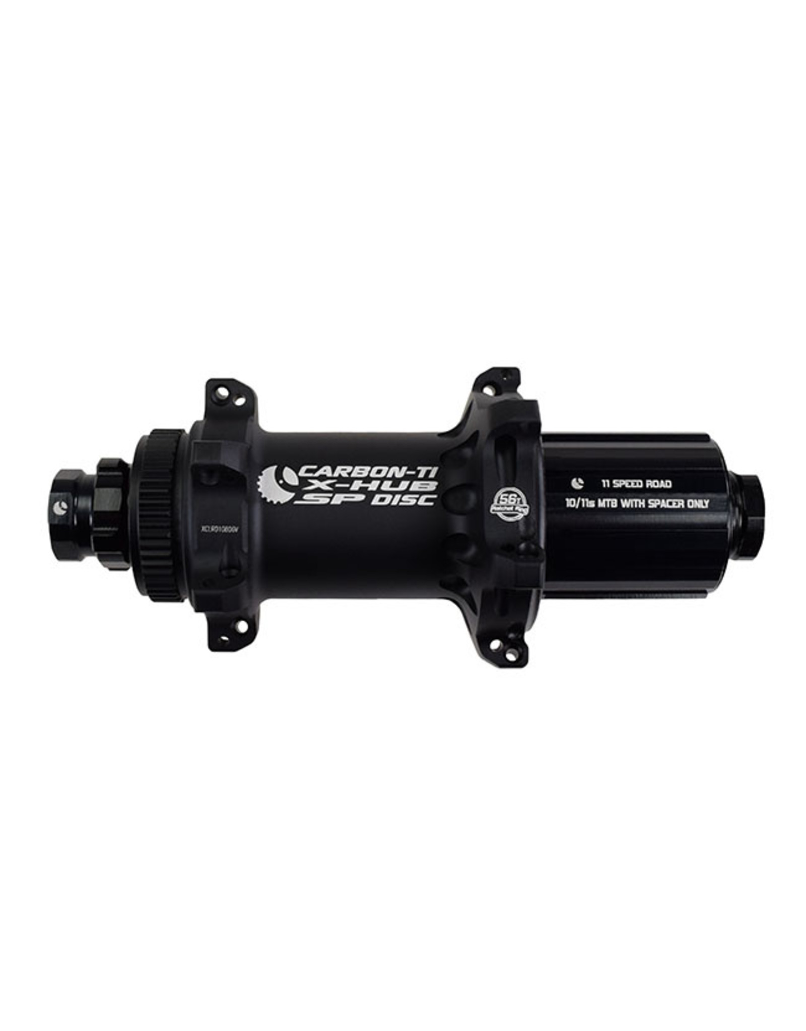

Carbon-Ti X-Hub SP Centerlock Rear Disc Hub
$509.95
Article number: 008-05-01
The Carbon‑Ti Rear SP Centerlock X-Hub delivers ultra-lightweight performance engineered for modern disc-brake road, gravel, and cyclocross wheel builds. Machined entirely from 7075-T6 aluminium in Italy, the body and axle integrate precision CNC construction with a toolless external preload ring for effortless bearing preload adjustment. Paired with a 56-tooth titanium engagement ring and 4 pawl system, it offers rapid engagement and durable reliability. The hub accepts multiple freehub options (Shimano/SRAM standard 11-speed, SRAM XDR, Campagnolo N3W, Shiumano MicroSpline) making it a highly flexible choice for high-end builds.
Technical wheel-builder specs include left flange 48 mm / right flange 54.5 mm, centre-to-flange 36/18 mm, straight-pull 2.5 mm ― all optimized for stiffness in a lightweight package. With a claimed weight of ~189 g, this hub allows elite wheelbuilders to minimise rotational mass without compromising serviceability or longevity.

 Weight ~189g
 Spoke Holes 24h
 Axle Standard 12 x 142 mm
 Bearing Size 6903 - (1) / 6803 - (1)
 Brake Interface Centerlock
--Wheel Building Dimensions--
  LEFT RIGHT
 Flange Diameter  48 mm 54.5 mm
 Center to Flange 36 mm 18 mm
 Spoke Hole Offset 2.0 mm
 Spoke Hole Diameter 2.5 mm
 Material 7075-T6 Aluminum
