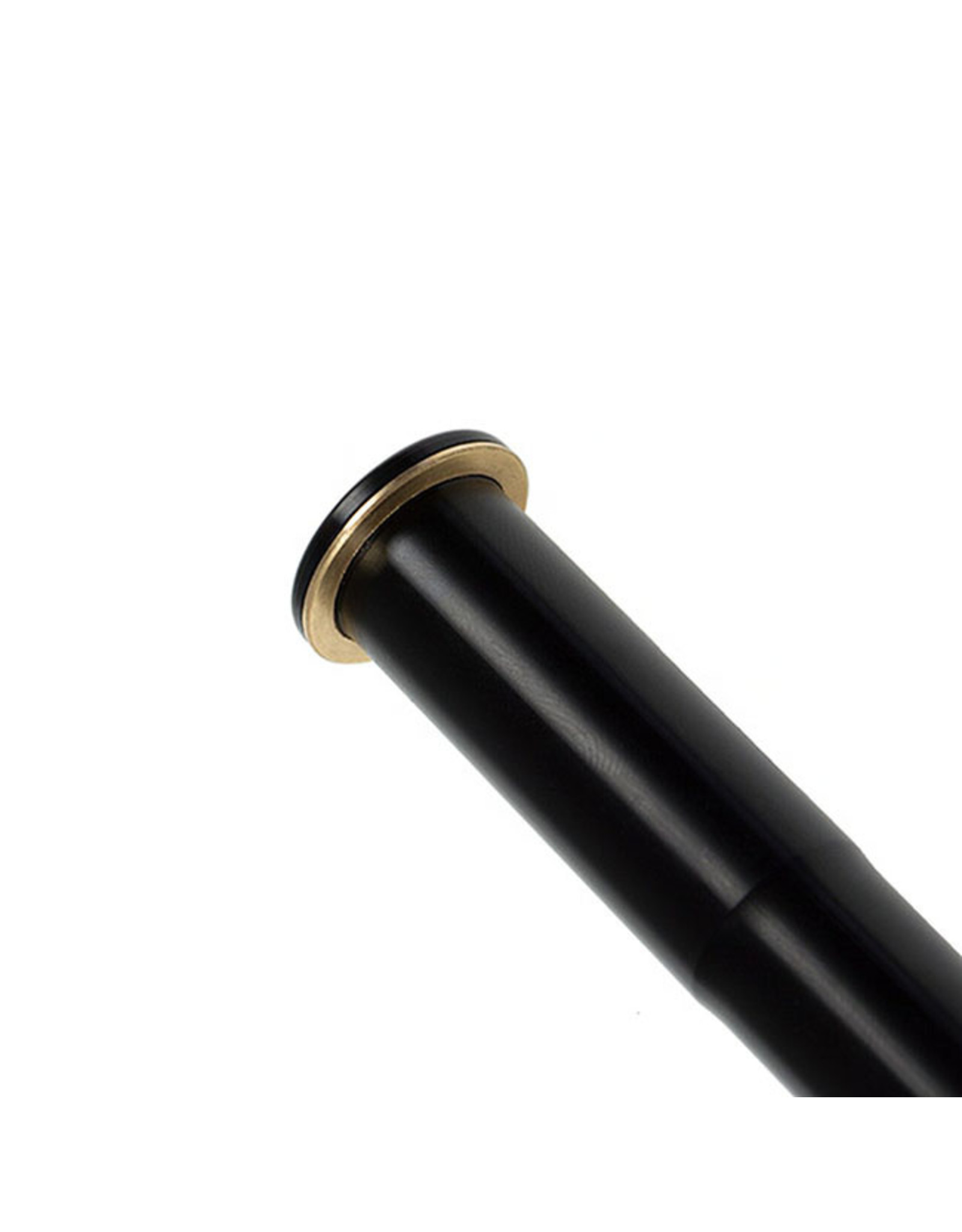

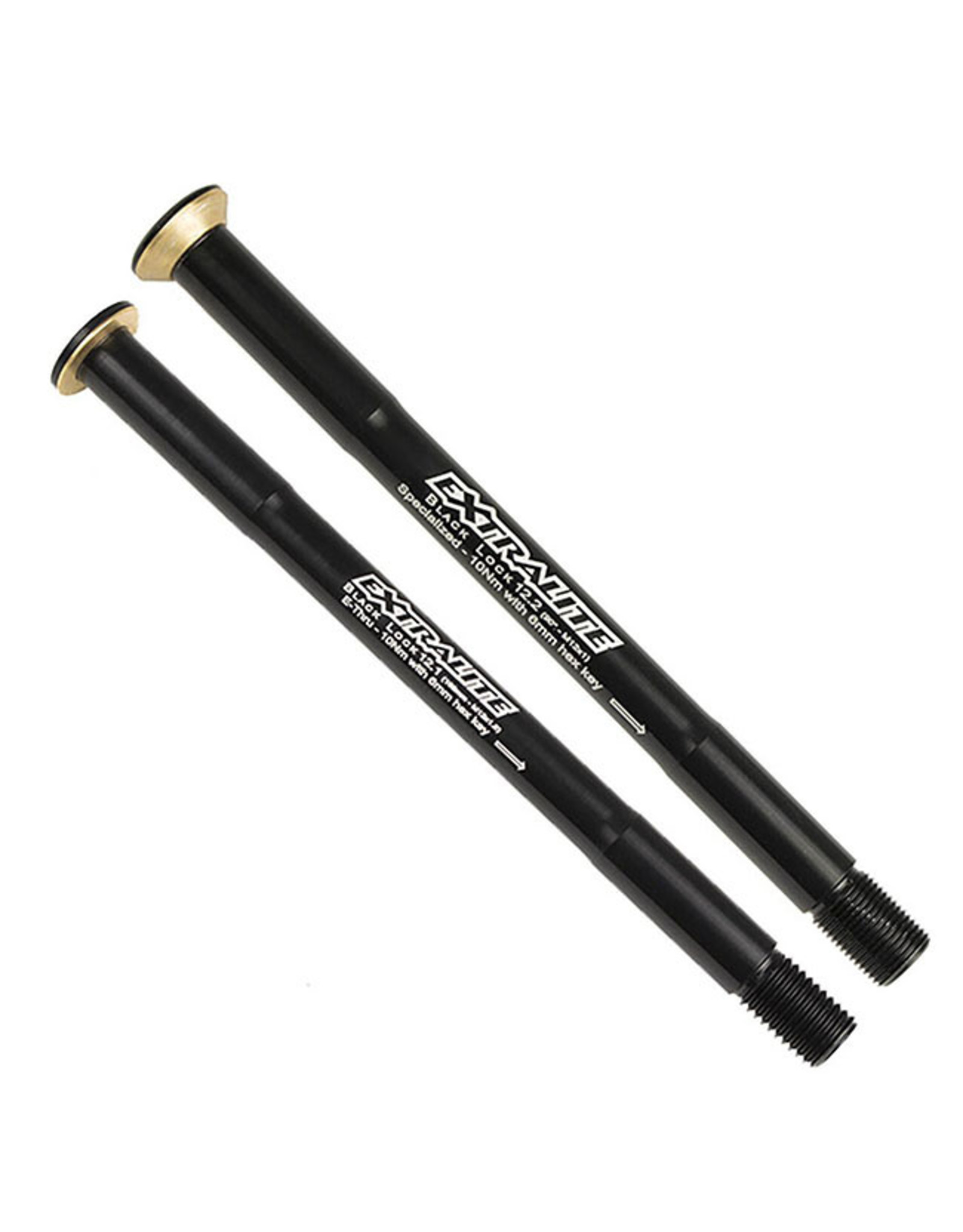

With the rising popularity of thru axle designs being used by nearly every major fork and frame manufacturer, companies like Extralite have immediately filled in the niche for quality performance tuned parts that many discerning cyclists desire. With this in mind, Extralite has produced the BlackLock, a surprisingly lightweight thru axle skewer. Utilizing a unique externally tapered surface and precise dimensioning, Extralite is capable of shaving as many grams as possible while still maintaining a sturdy design that’s tough enough to withstand the abuse of a typical mountain bike ride. To ensure proper installation that’s as smooth as possible, each BlackLock comes with a self lubricating brass washer that is designed to reduce friction between the skewer and frame/fork.

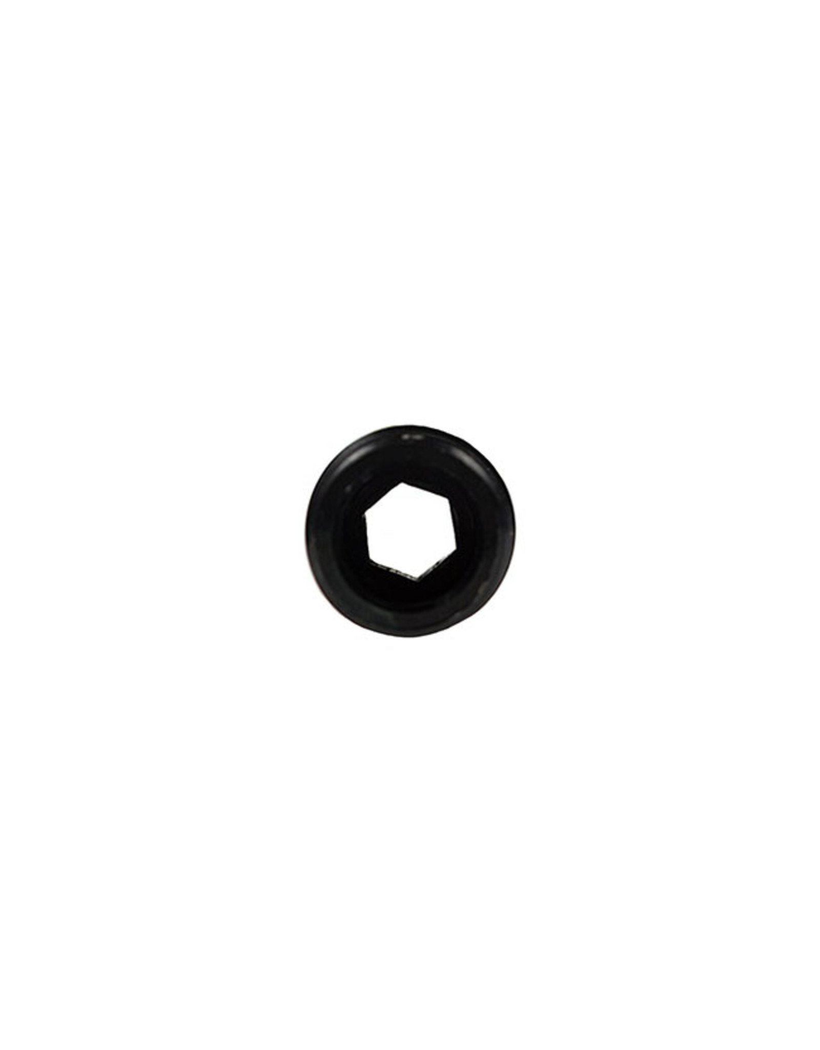

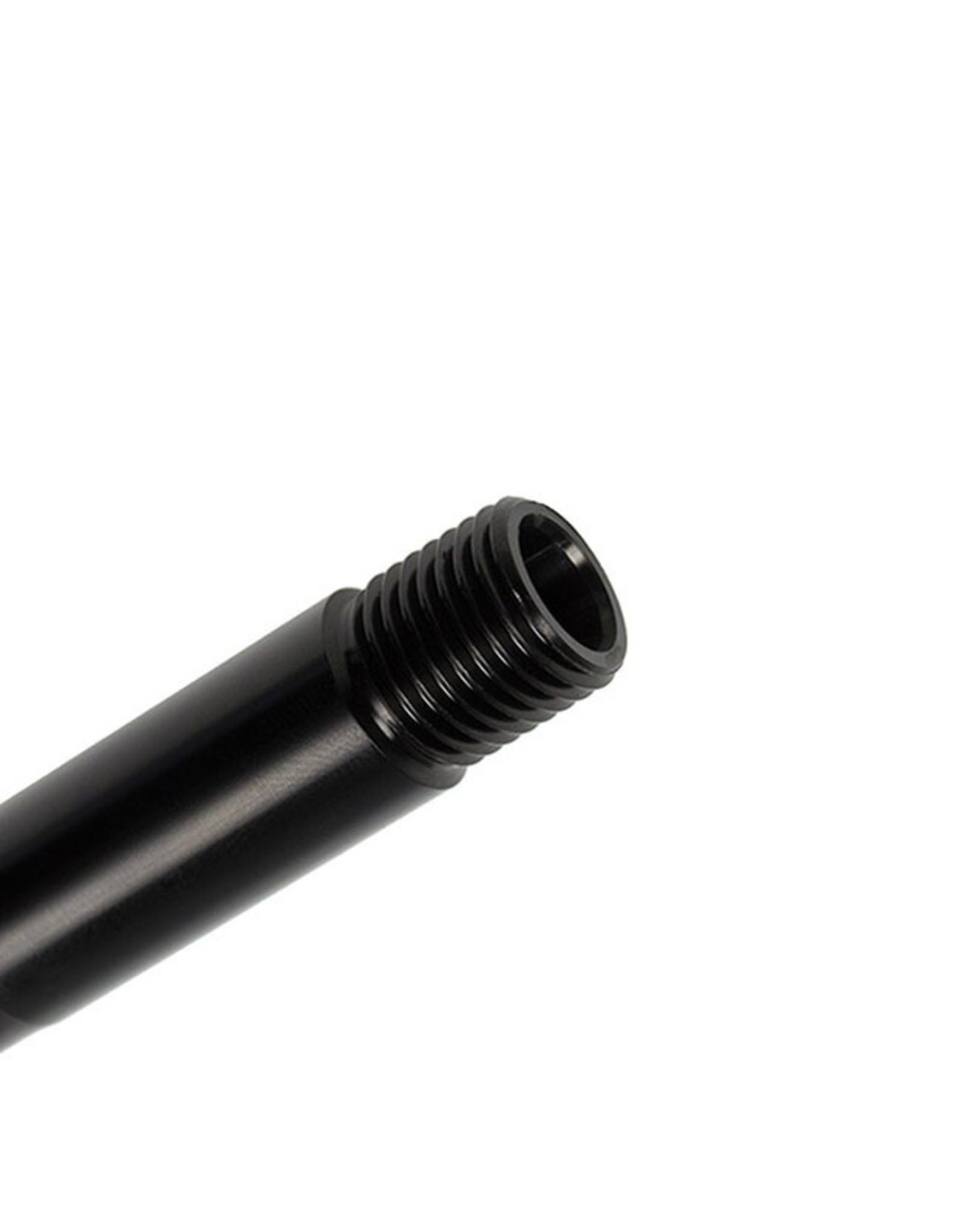

Each BlackLock skewer is simply installed using a 6 mm allen wrench at a torque rating of 10 Nm. It is highly recommended that the threads are greased prior to installation to ensure a proper torque rating.

Model Interface Length Compatibility Length Weight
X-12 / Syntace (12 x 1.0 mm)
12.2 Tapered 161 mm Specialized 17 mm ~29g
12.2-B* Tapered 166 mm Specialized Boost 17 mm ~30g
12.4-B* Flat 172 mm Scott Boost pre-'22 17 mm ~29g
12.4-C Flat 178 mm Scott Spark '22+ 13.5 mm ~30g
12.6 Flat 185 mm SRAM UDH 15 mm ~31g
E-Thru (12 x 1.5 mm)
12.1 Flat 172 mm E-Thru 18 mm ~29g
12.1-B* Flat 178 mm E-Thru Boost 18 mm ~31g
12.4-RA Flat 158 mm Scott Road pre-'20 13 mm ~27g
12.4-RB Flat 163 mm Giant Road 13 mm ~28g
12.4-RC Flat 168 mm Scott Road '20+ 13 mm ~29g
Maxle (12 x 1.75 mm)
12.3 Flat 176 mm Maxle 19 mm ~30g
12.3-B* Flat 182 mm Maxle Boost 20 mm ~30g
12.4-RE Flat 166 mm Trek Emonda 19 mm ~28g

 Tool Fitting 6 mm Hex
