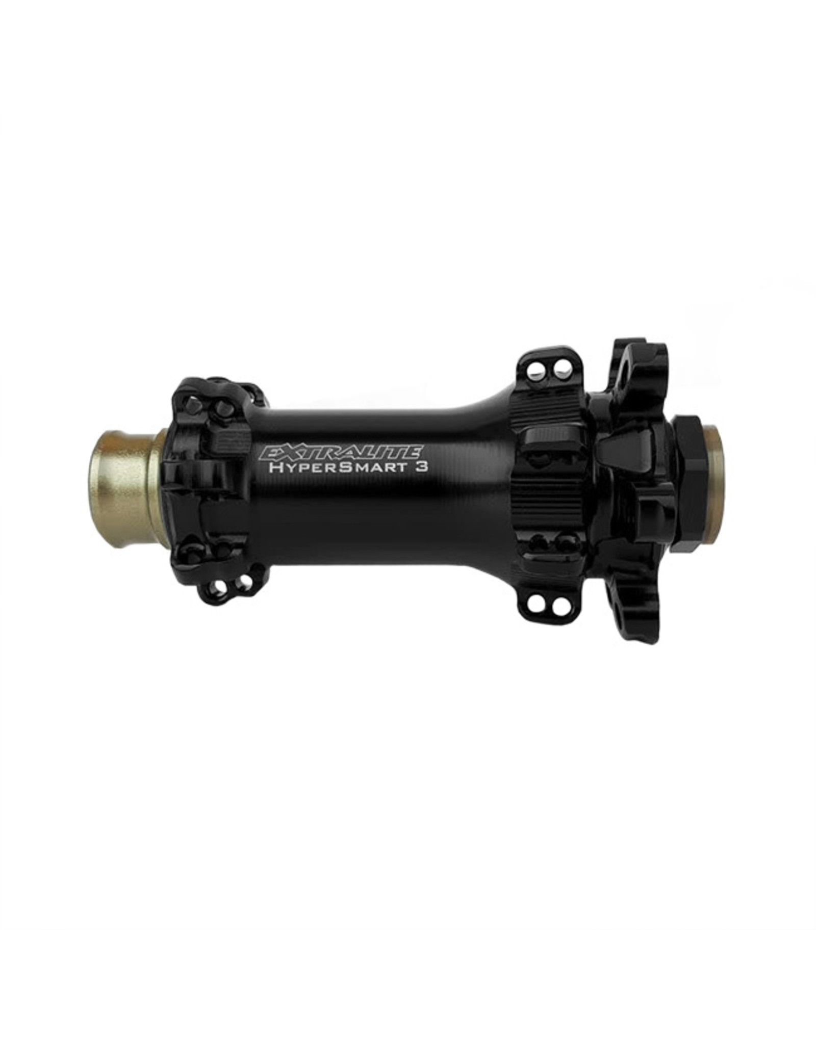

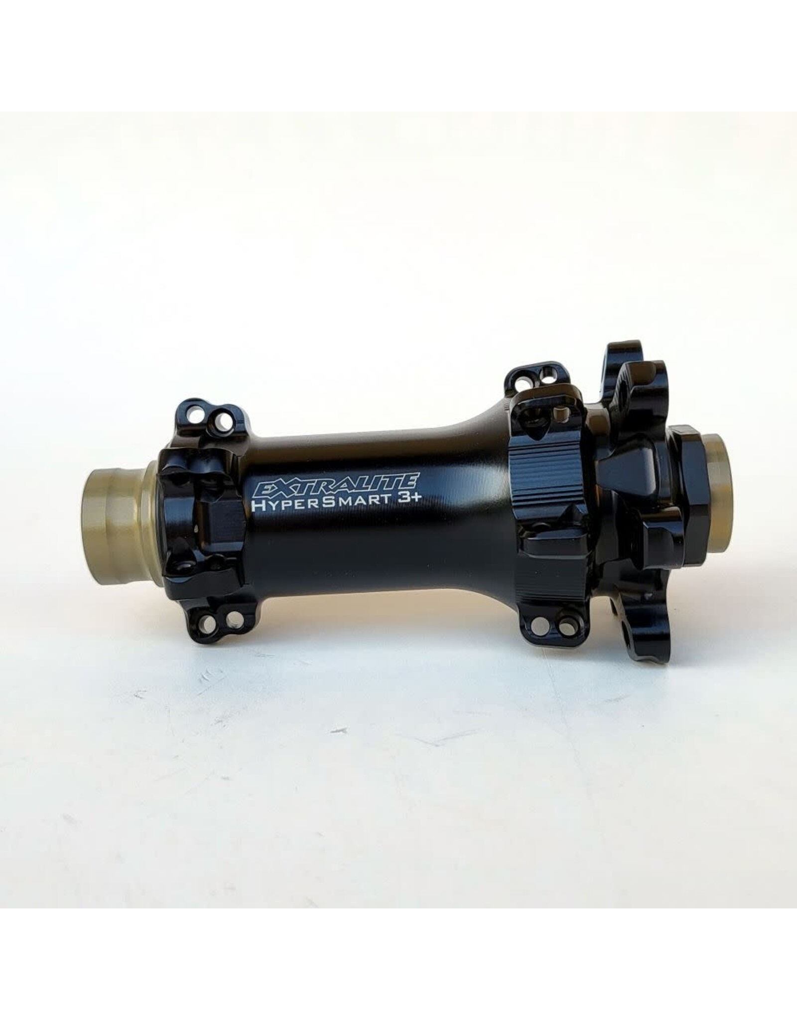

Extralite HyperSmart 3+ Front Disc Brake Hub
| Article number: | 010-02-07 |
The HyperSmart3-F front hub offers axle stiffness with 12mm thru-axle and 15mm quick-release setups. Its 17mm axle is precision-machined with 6803-2RS bearings. The multi-shaped profile and micro-tuner allow precise bearing preload adjustment, minimizing friction and maximizing life. Soft-Touch O-ring seals protect against contaminants. The wide disc-brake flange reduces spoke stress, and straight-pull spoking enhances rigidity. Made from 7075TXX aluminum, it weighs 68 grams and is available in 24 or 28 hole drillings, compatible with 100mm quick-release forks and 12mm and 15mm thru-axles.

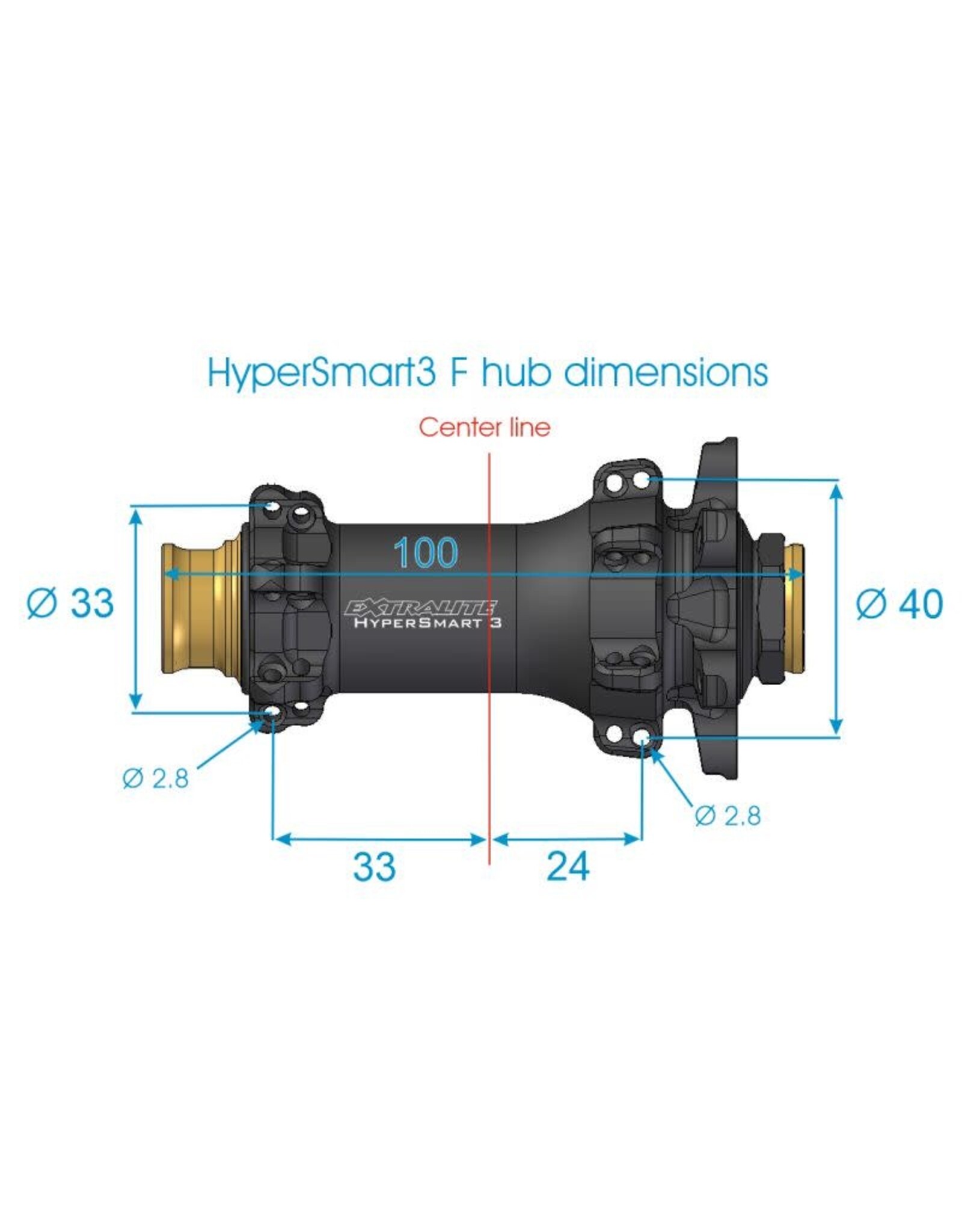

| --Wheel Building Dimensions-- | ||
| LEFT | RIGHT | |
| Flange Diameter | 40.0 mm | 33.0 mm |
| Center to Flange | 24.0 mm | 33.0 mm |
| Spoke Hole Offset | 1.5 mm | |
| Spoke Hole Diameter | 2.8 mm | |
| *for accurate spoke lengths, please use Extralite's Hyper hub Lacing Instructions | ||
