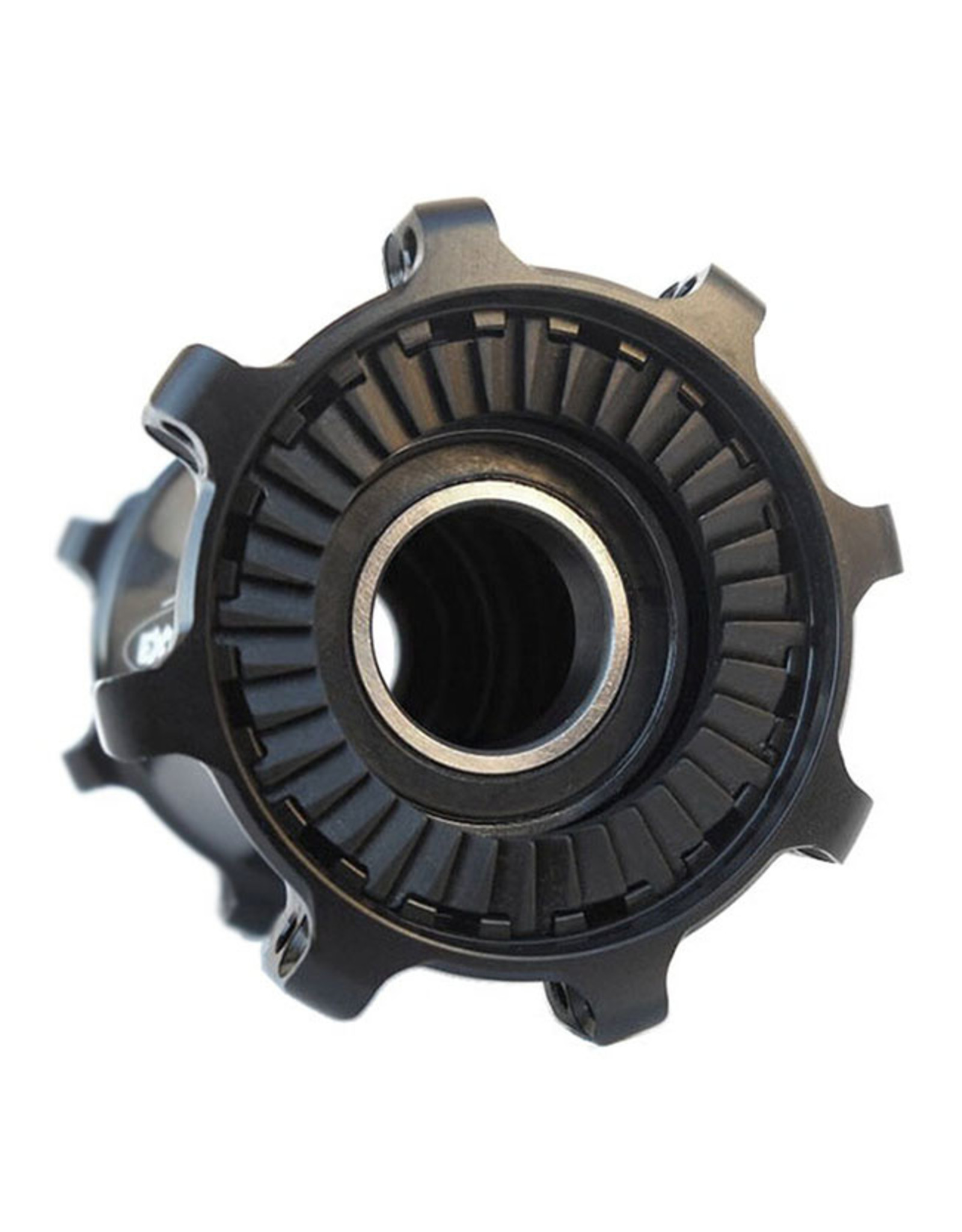

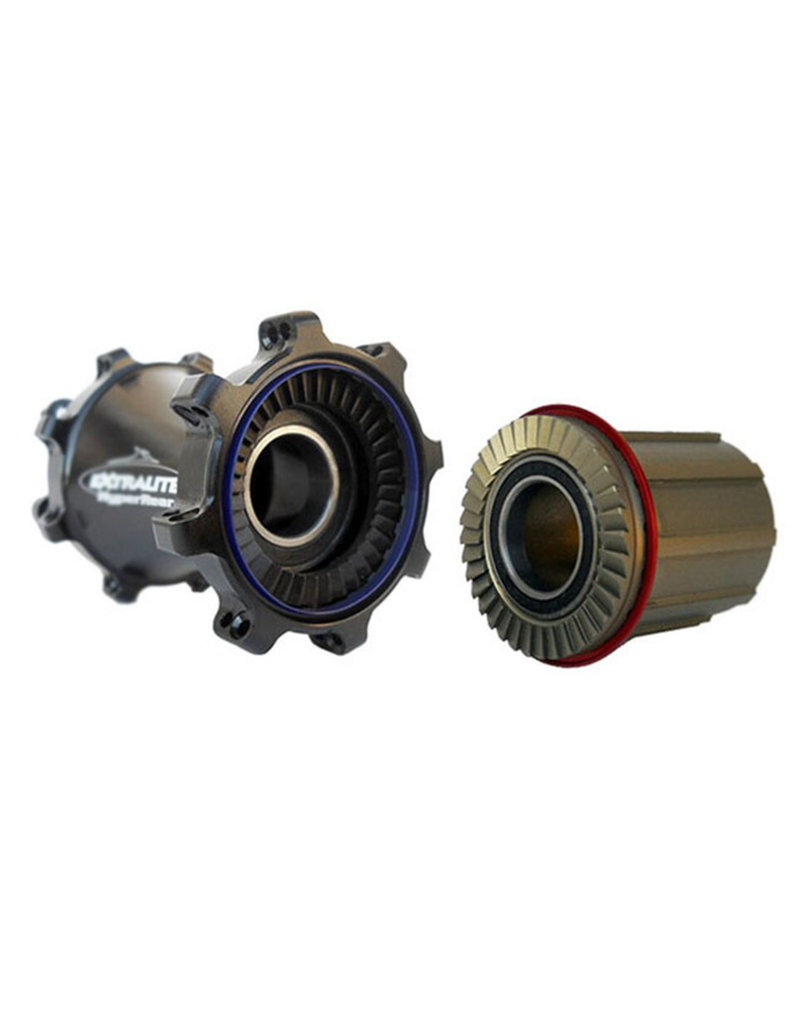

The HyperBoost from Extralite is a prime example of this company's dedication to keeping up with an ever-evolving industry. Rather than simply swapping out the axle on their incredibly lightweight HyperRear to create a Boost 148 compatible hub, Extralite adapted their hub design to take advantage of the increased dropout width. The wider straight-pull spoke flanges are spaced to improve the spoke tension balance between the two sides of the wheel while increasing the wheel's lateral stiffness and overall strength. Internally, the HyperBoost hub retains Extralite's tried-and-true lightweight design, with durable stainless steel bearings housed within an expertly-machined 7075TX aluminum hub shell. The cassette ratcheting system features Extralite's "oversized front engagement," a superlight all-aluminum drive ring with 36 simultaneous points of engagement to allow insanely high drivetrain torque.

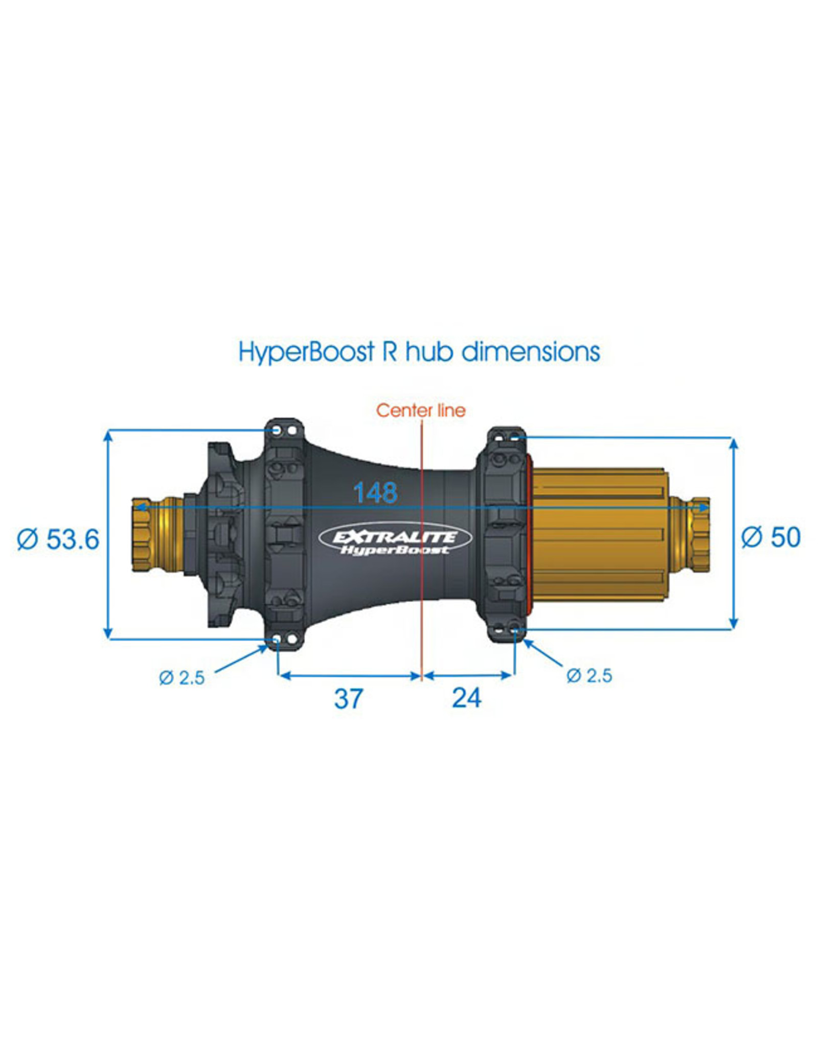

| --Wheel Building Dimensions-- | ||
| LEFT | RIGHT | |
| Flange Diameter | 50.0 mm | 48.0 mm |
| Center to Flange | 36.0 mm | 25.0 mm |
| Spoke Hole Offset | 1.5 | |
| Spoke Hole Diameter | 2.6 mm | |
| *for accurate spoke lengths, please use Extralite's Hyper hub Lacing Instructions | ||
