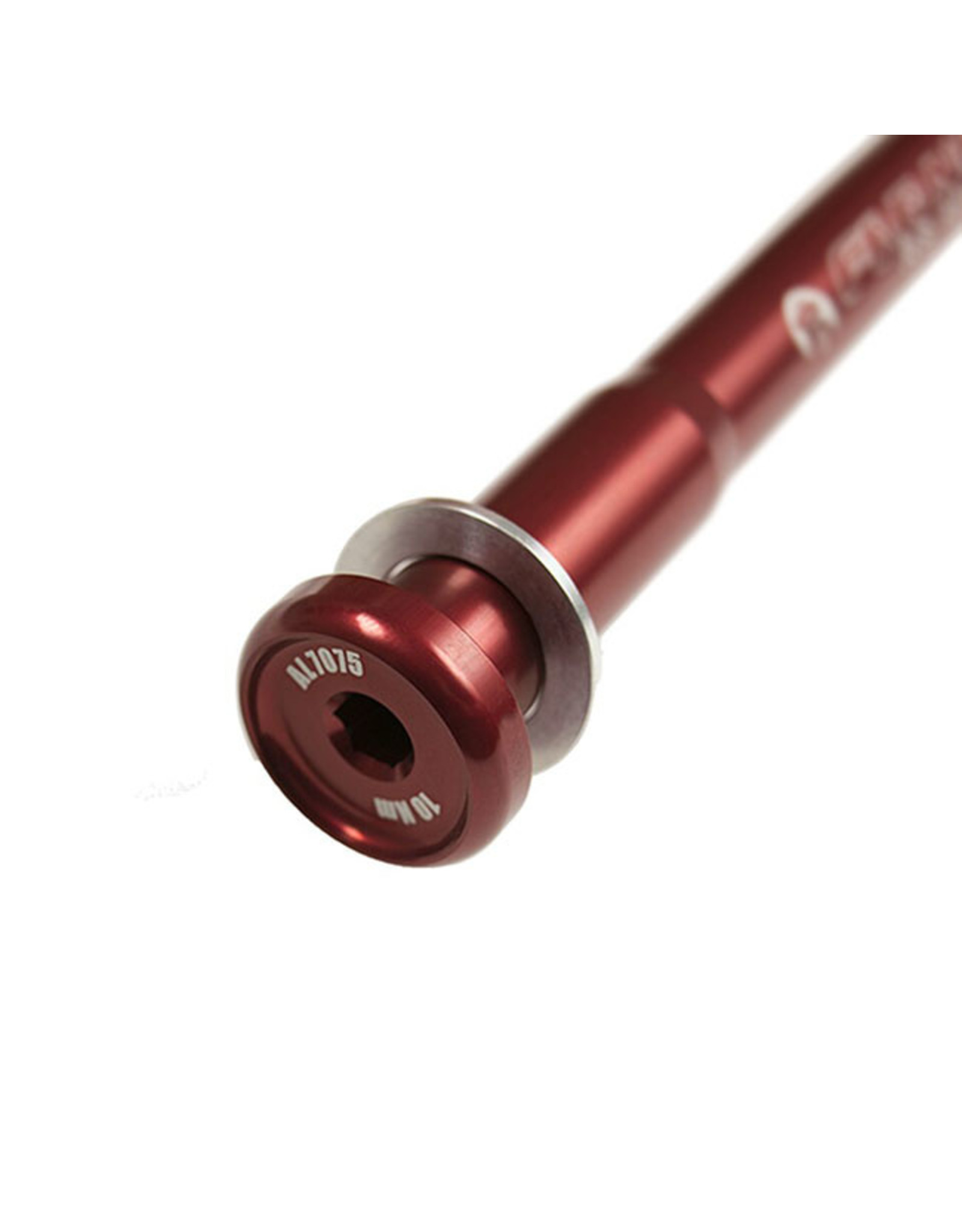

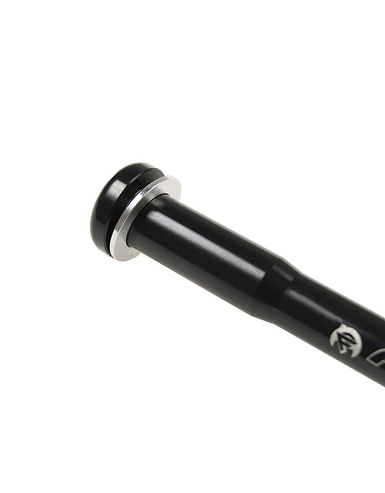

Far and Near introduces a dependable thru axle solution that caters to the most popular designs. Rather than a protruding lever that can catch on rough terrain, Far and Near incorporates 6mm allen wrench flats into the axle head, creating a sleek and secure fit for your wheel and frame.
These axles are precision-machined from 7075 Aluminum, and their rich anodized colors seamlessly match other Far and Near components, making them a stylish addition to any mountain bike. With a focus on both peace of mind and robust engagement, these axles withstand the most strenuous riding conditions. Elevate your bike's aesthetics without breaking the bank, thanks to Far and Near Thru Axles.
