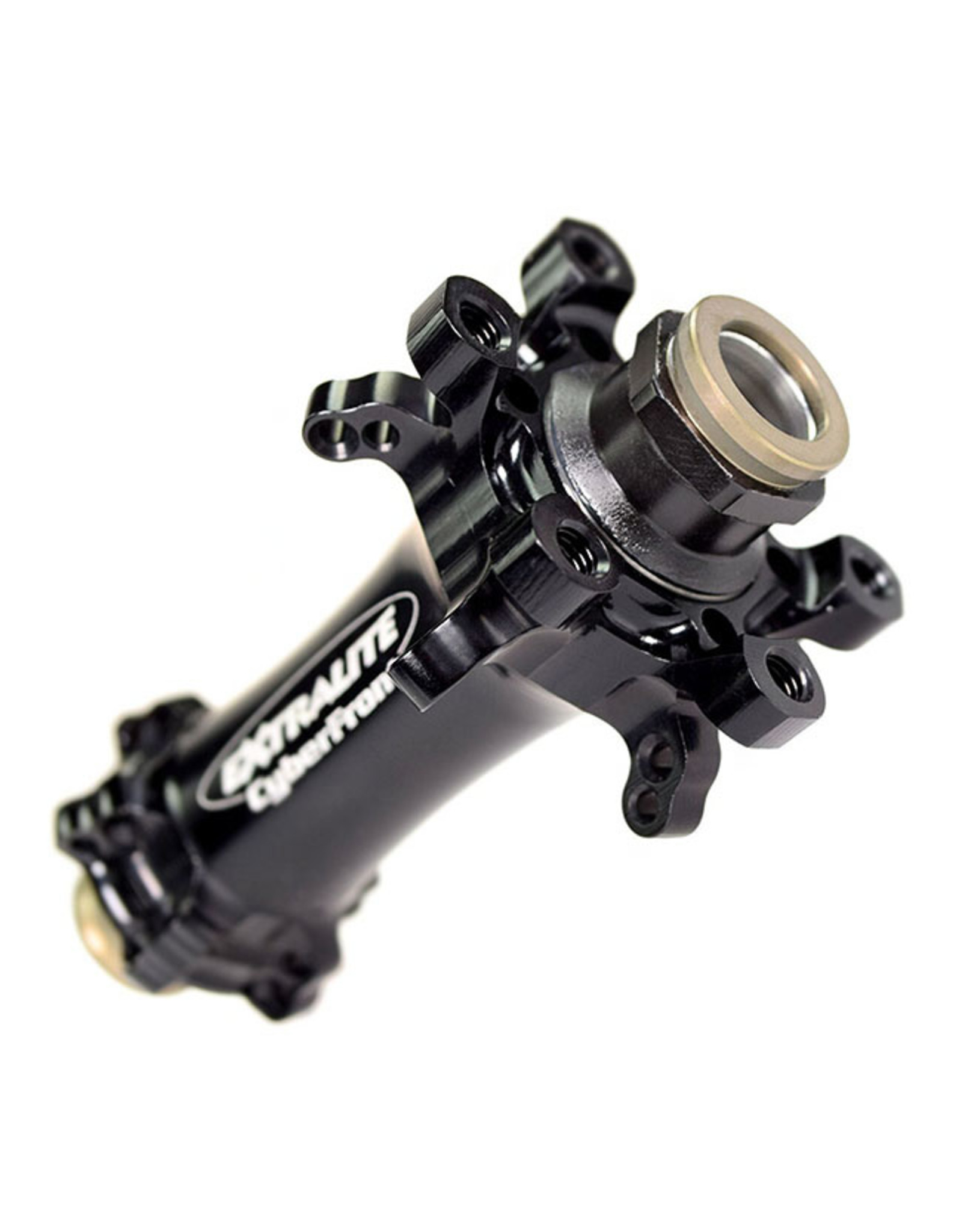

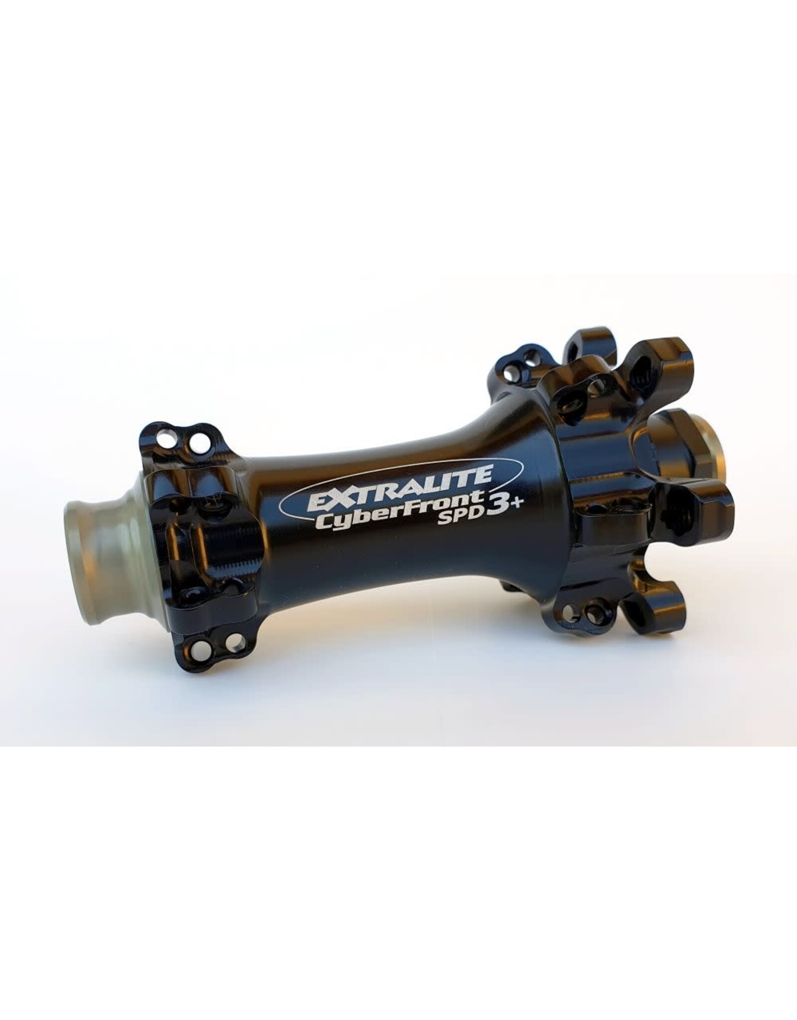

The Extralite CyberFront SPD-3+ is one of the world’s lightest disc-specific front hubs at just 66 g. Machined in Italy from aerospace-grade 7075TX aluminum, its one-piece shell maximizes strength while keeping weight to an absolute minimum. A cross-laced straight-pull spoke interface allows for easier wheel building and optimized tension balance, improving lateral stiffness and braking response.
With a 12 × 100 mm thru-axle standard, 6-bolt rotor interface, and compatibility with both 14G and Pillar's X-Tra Lite Titanium 13 gauge spokes, the SPD-3+ provides exceptional versatility for high-performance road disc builds. The micro-tuner system enables precise bearing preload adjustment, ensuring smooth rotation with zero play.
Available with stainless steel or ceramic bearing upgrades (HDC or XD15), the CyberFront SPD-3+ is EN-certified for riders up to 200 lbs (90 kg). This hub is engineered for weight-conscious riders seeking uncompromising performance in a disc brake road setup.

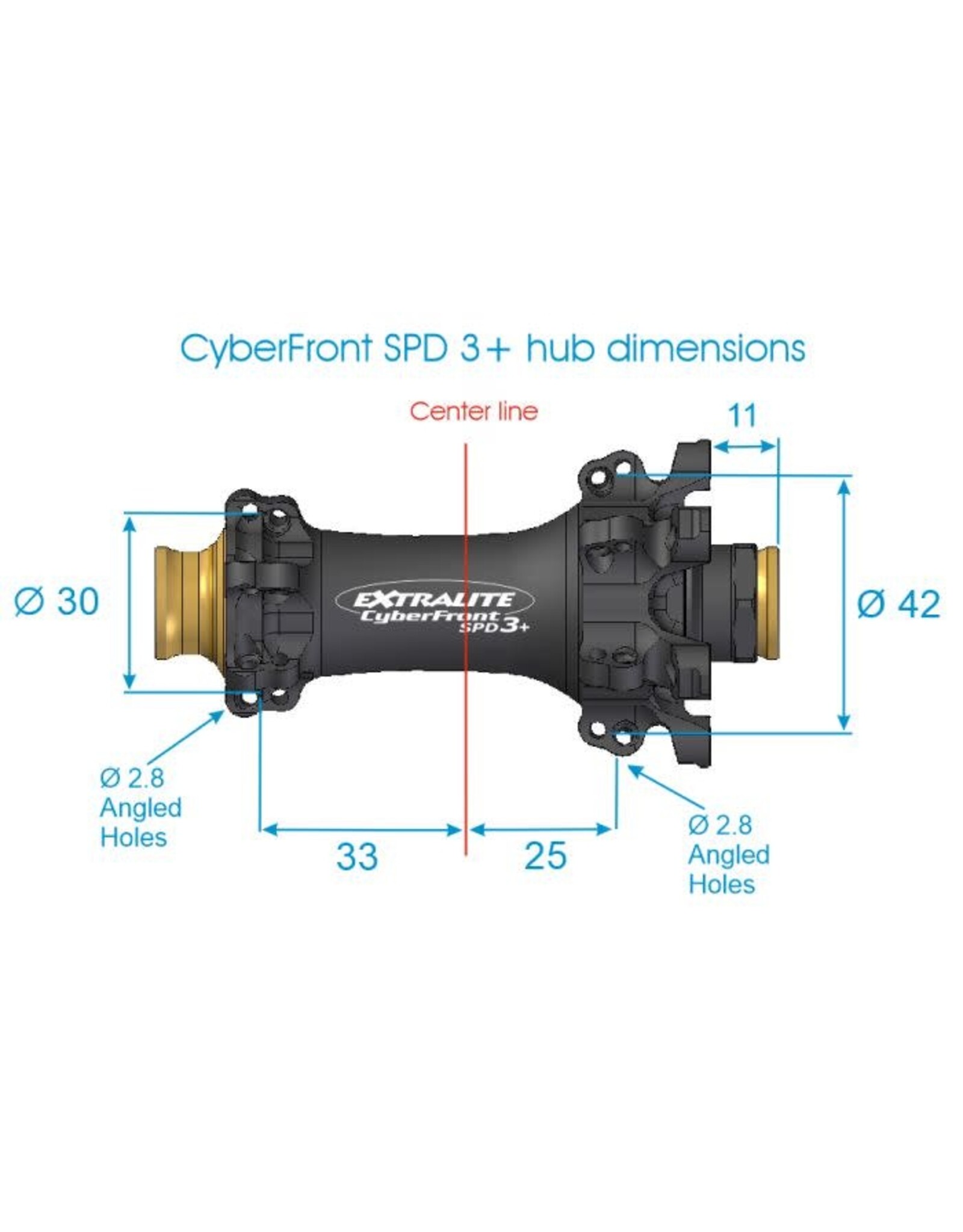

| -- Wheel Building Dimensions -- | ||
| LEFT | RIGHT | |
| Flange Diameter | 30.0 mm | 42.0mm |
| Center to Flange | 33.0 mm | 25.0 mm |
| Spoke Hole Offset | 1.5 mm | |
| Spoke Hole Diameter | 2.8 mm | |
