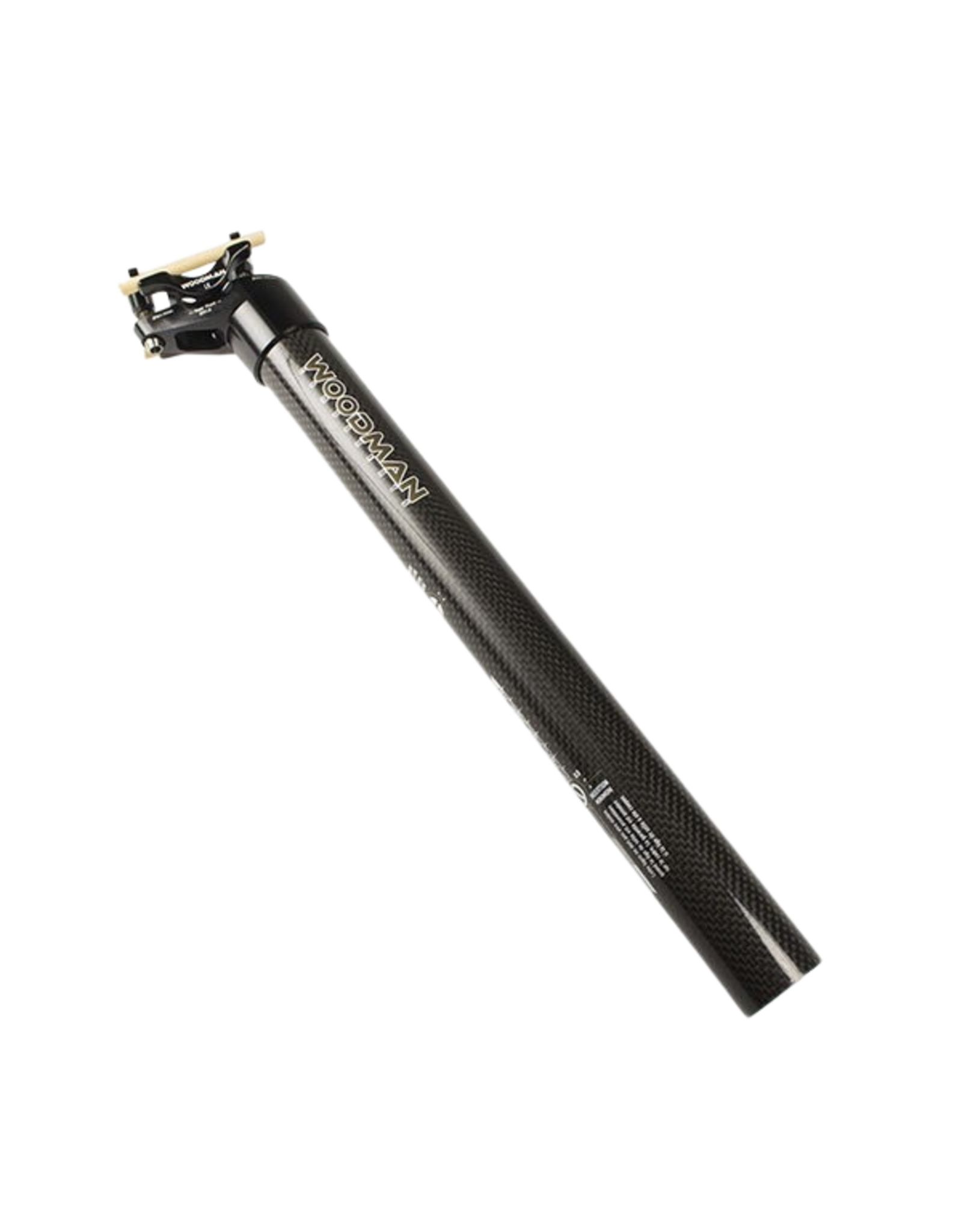

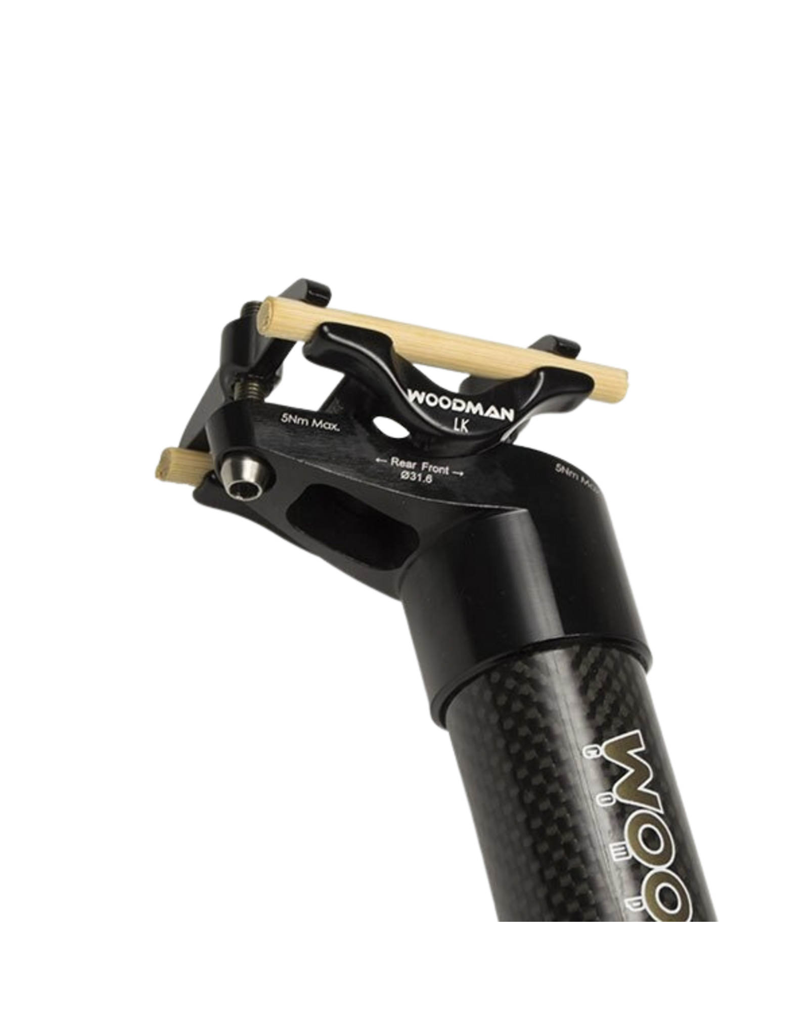

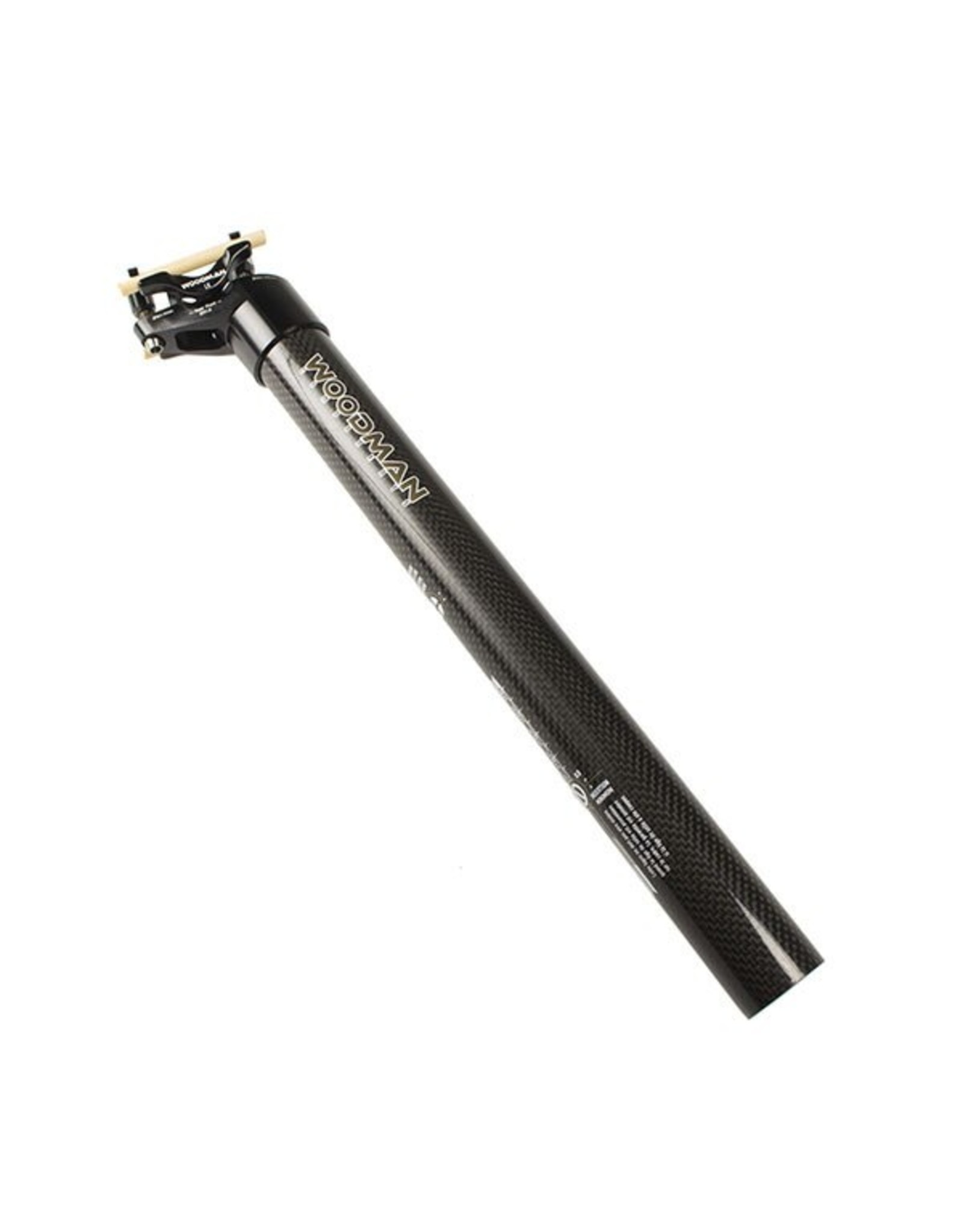

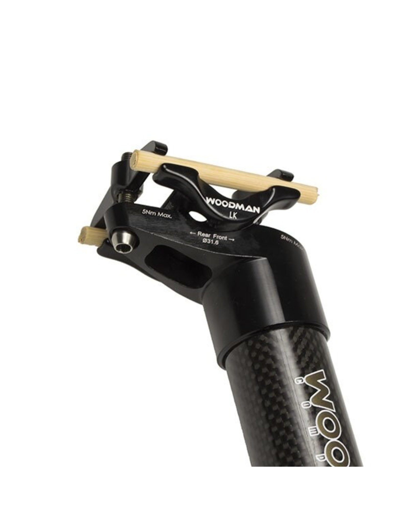

The Woodman Carbo DX Seatpost delivers an ideal balance of comfort, adjustability, and strength for performance cyclists. Built around an internally relieved carbon-fiber main tube and CNC-machined titanium hardware, the Carbo DX provides reliable stiffness and a refined ride quality in a lightweight package.

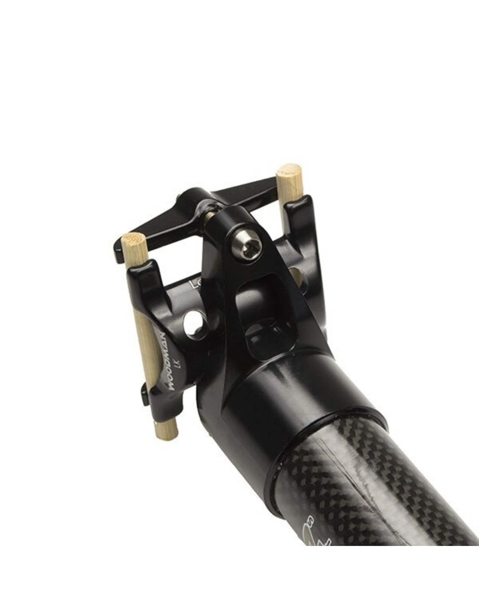

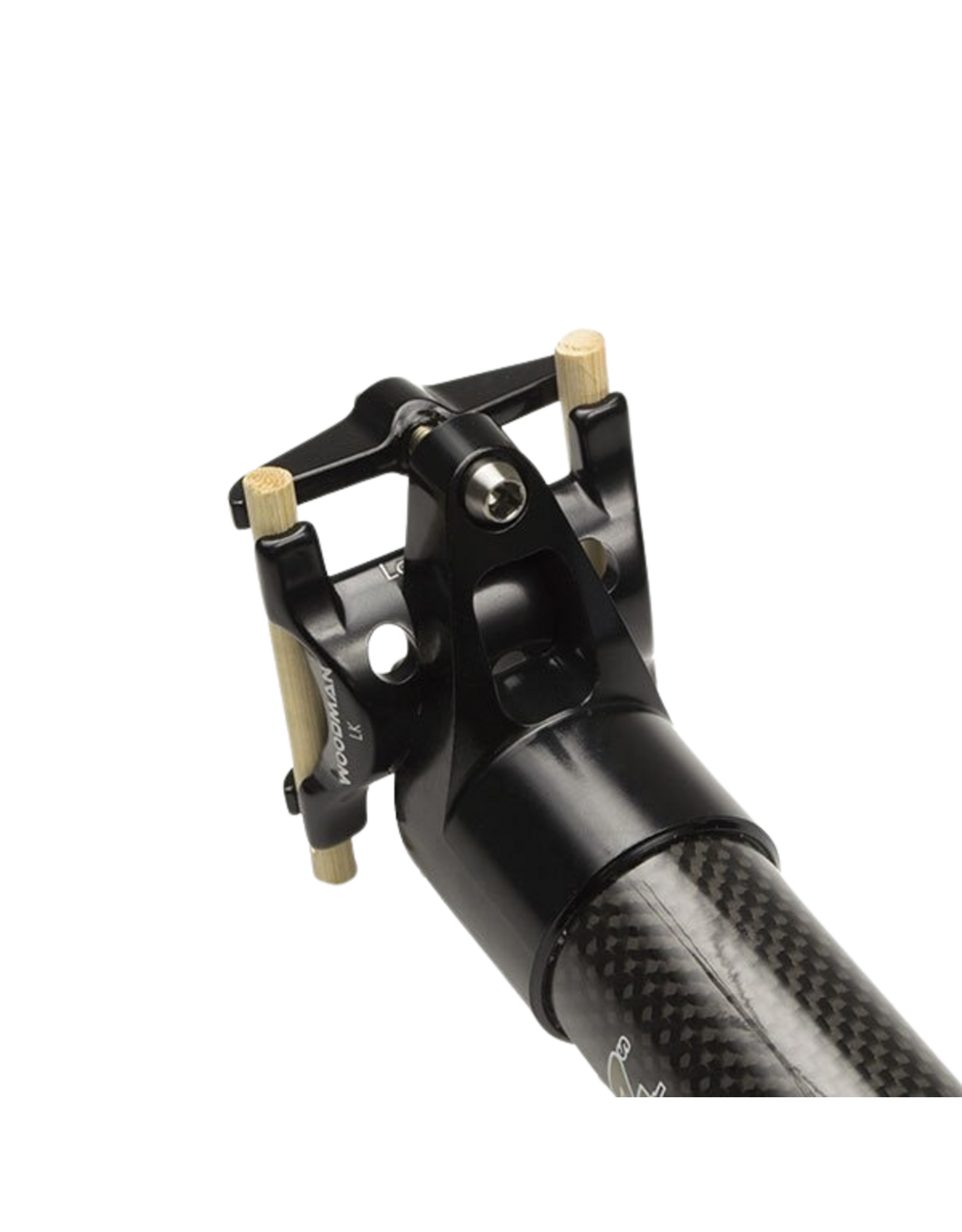

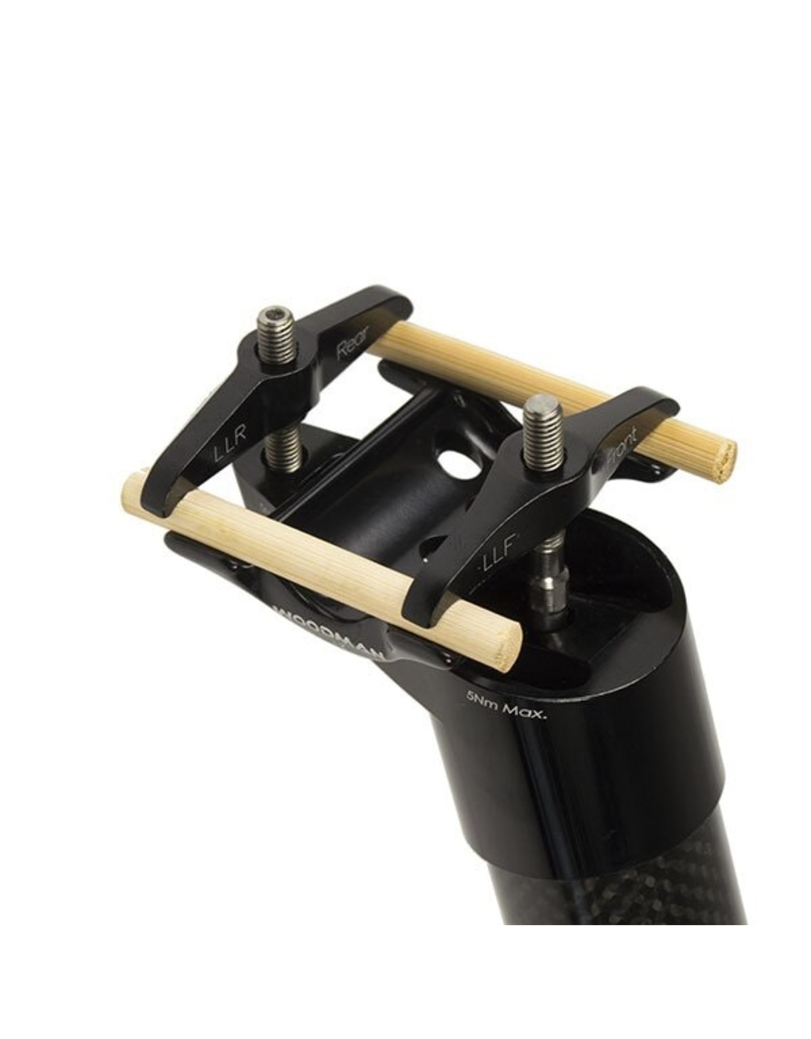

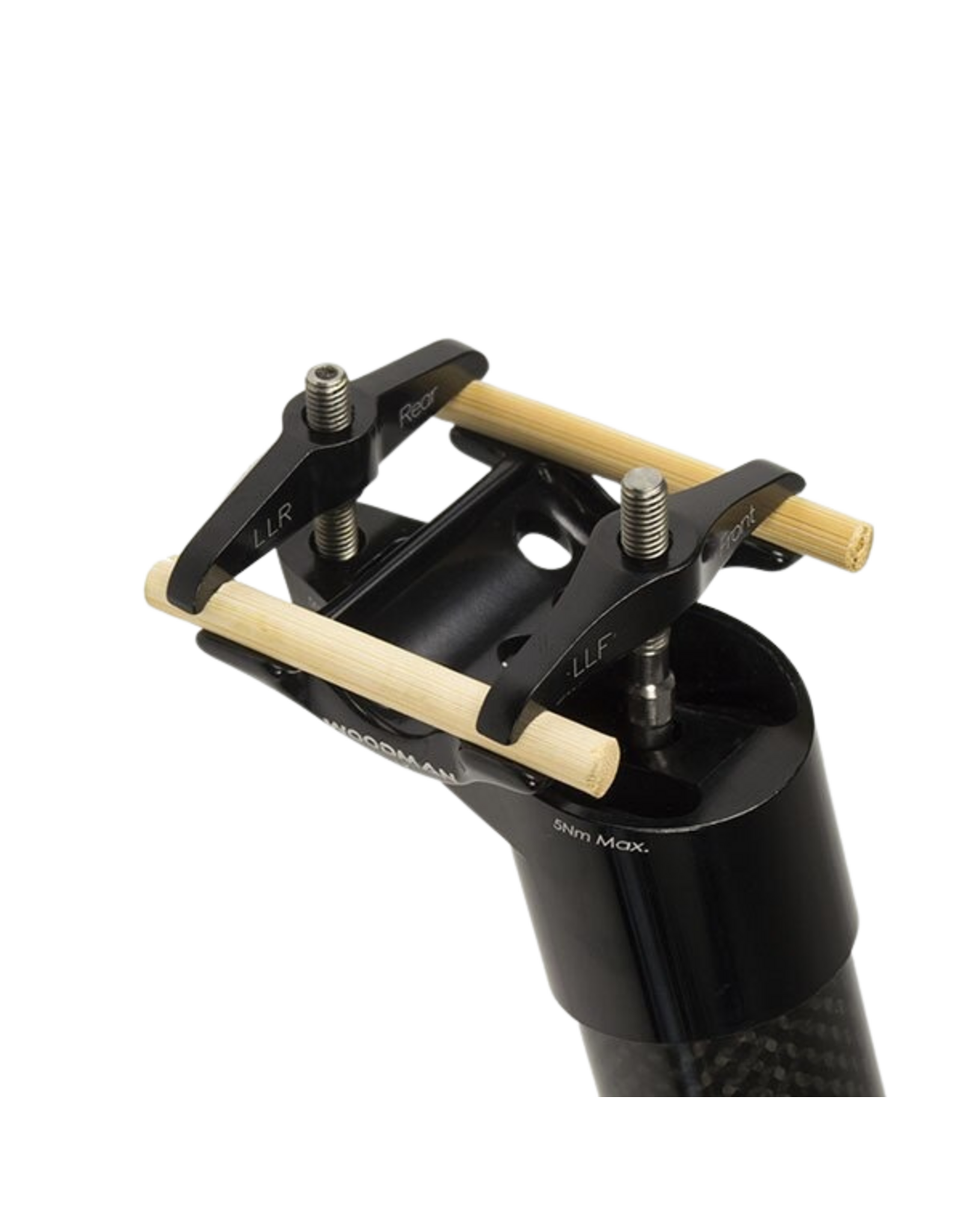

With a 25 mm setback, it allows fine-tuned saddle positioning to achieve optimal fit and balance, especially for riders preferring a more rearward seating position. The dual-bolt cradle-and-yoke clamp ensures consistent rail support and compatibility with both carbon and metal rails (7 × 7 / 7 × 9 / 7 × 10 mm). Available in multiple diameters and lengths, it’s suited for both road and cross-country use where precision and durability matter most.
INSTALLATION

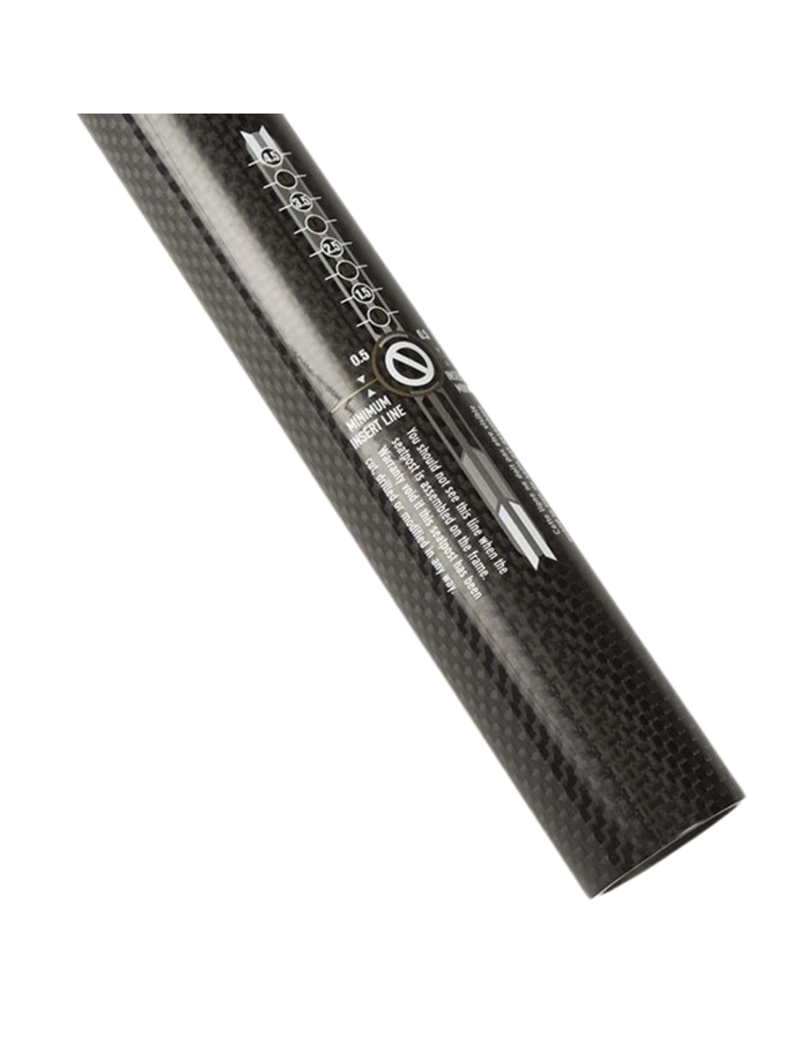

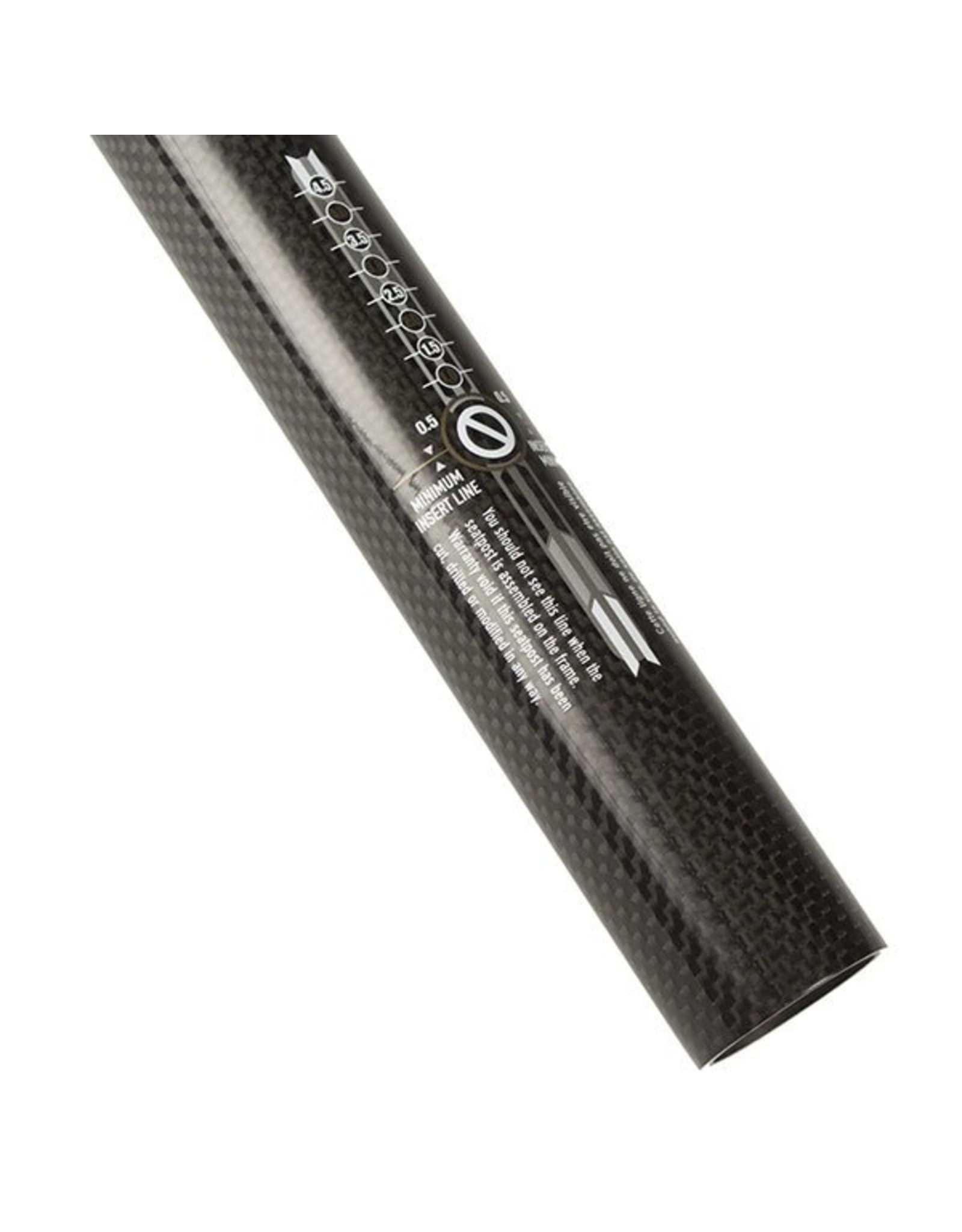

Each Woodman Carbo DX seatpost has a minimum and maximum insertion range, therefore it is extremely important that it never be cut or trimmed. Cutting any length off of your Carbo DX can result in unsafe riding conditions. Please be sure to use a proper torque wrench when installing your Woodman Carbo DX, and follow all torque ratings.

| Min. Insertion | 65 mm | 90 mm | 95 mm |
| Max Insertion | 115 mm | 175 mm | 180 mm |
