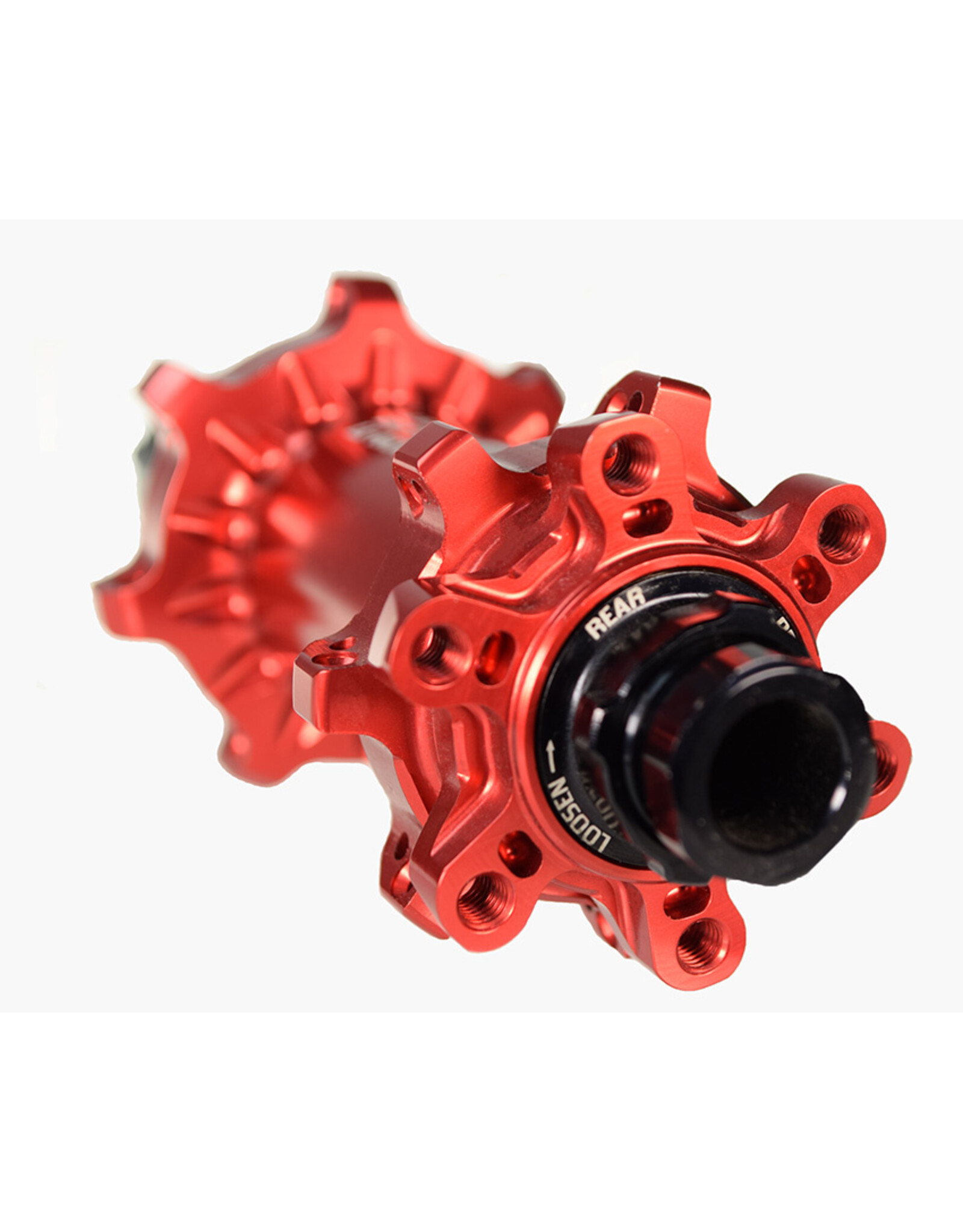

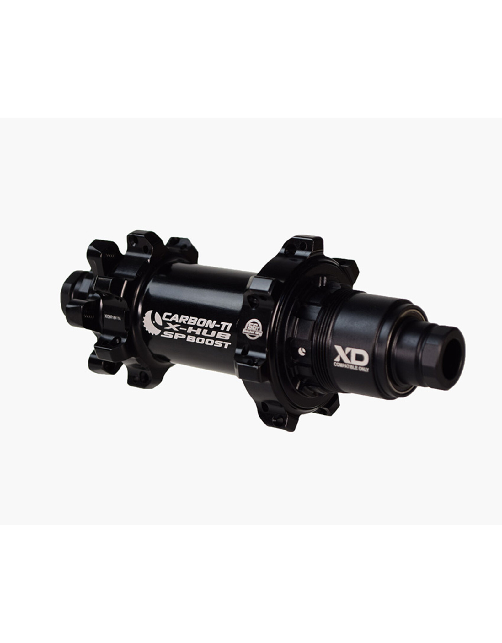

The Carbon-Ti X-Hub SP Boost Rear Disc Hub combines low weight, rapid engagement, and precise bearing adjustment for premium cross-country and marathon wheel builds. Its oversized hub shell and 17mm axle are CNC-machined from AL7075-T6 aluminum, delivering an excellent balance of stiffness, strength, and low rotating mass.

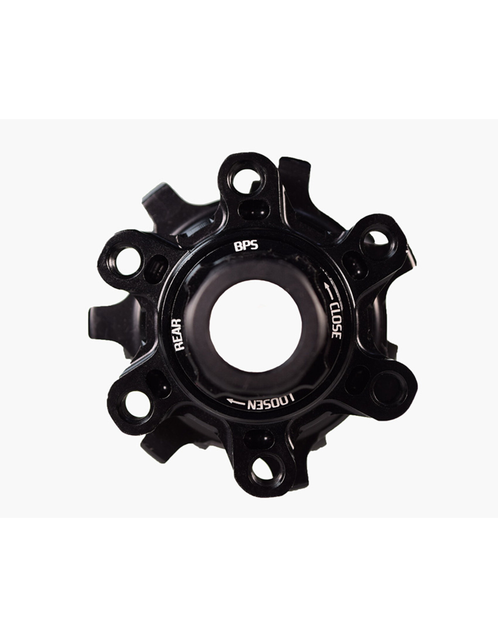

A four-pawl freehub mechanism engages a 56-tooth Grade 5 titanium drive ring for quick, consistent power transfer. The mechanism is protected by a triple-lip seal, while Carbon-Ti’s externally adjustable Bearing Preload System (BPS) allows bearing preload to be fine-tuned without disassembling the hub.
The 12 × 148mm Boost spacing increases flange separation to support laterally stiff modern mountain bike wheel builds. Available with Shimano/SRAM HG, SRAM XD, SRAM XDR, or Shimano Micro Spline freehub options, the X-Hub SP Boost uses a 6-bolt disc rotor interface and is offered in 24- or 28-hole configurations.
With a claimed weight of approximately ~198g, depending on freehub and drilling, the X-Hub SP Boost is intended for lightweight, responsive XC and marathon wheels. It is designed and manufactured entirely in Italy.

Brake Interface International Standard 6-Bolt
Freehub Options Shimano/SRAM HG / SRAM XD / SRAM XDR / Shimano Micro Spline
Engagement 56-Tooth Titanium Drive Ring
Freehub Mechanism 4 Pawls with Simultaneous Engagement
Bearings 3 × 61803 / 1 × 61903 Sealed Bearings
Bearing Adjustment External Bearing Preload System
