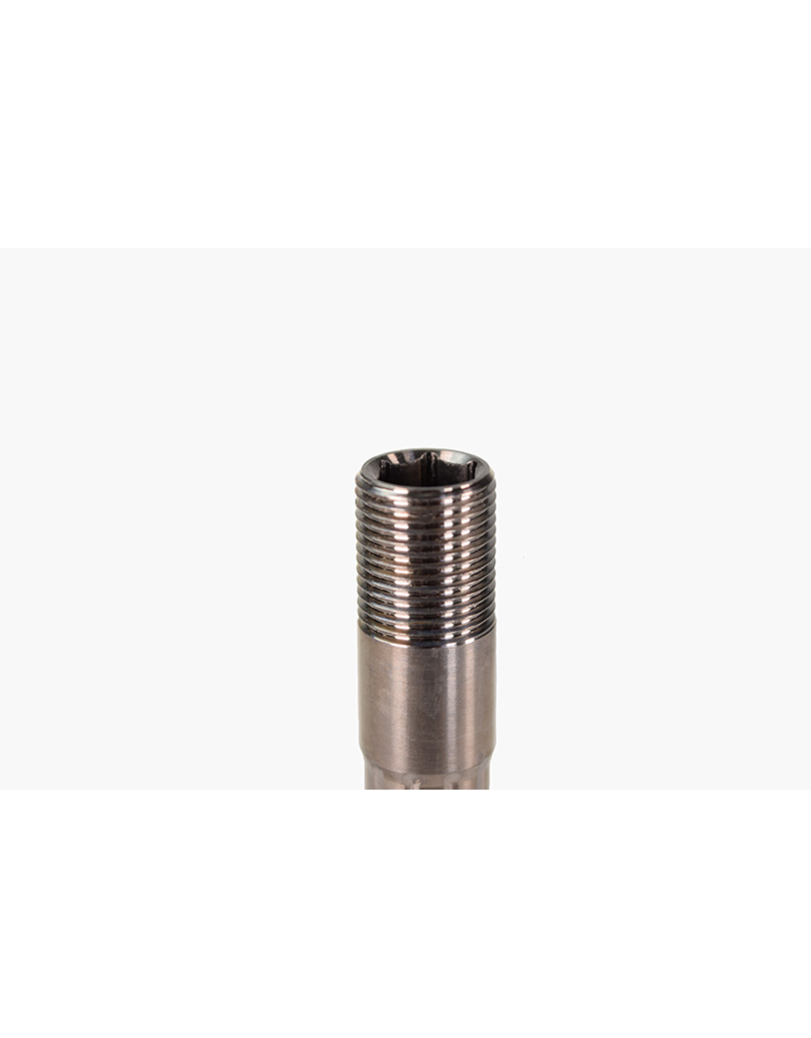

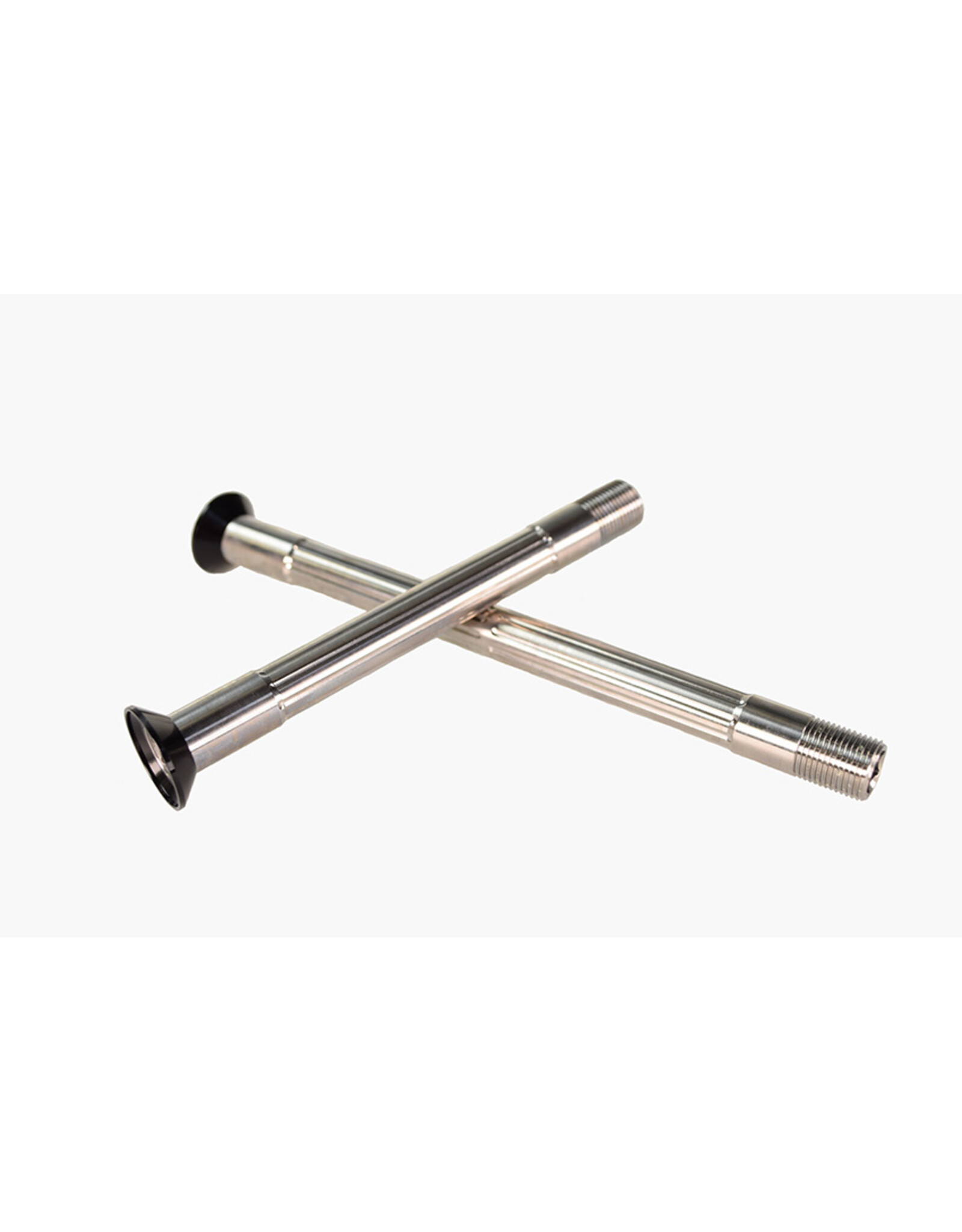

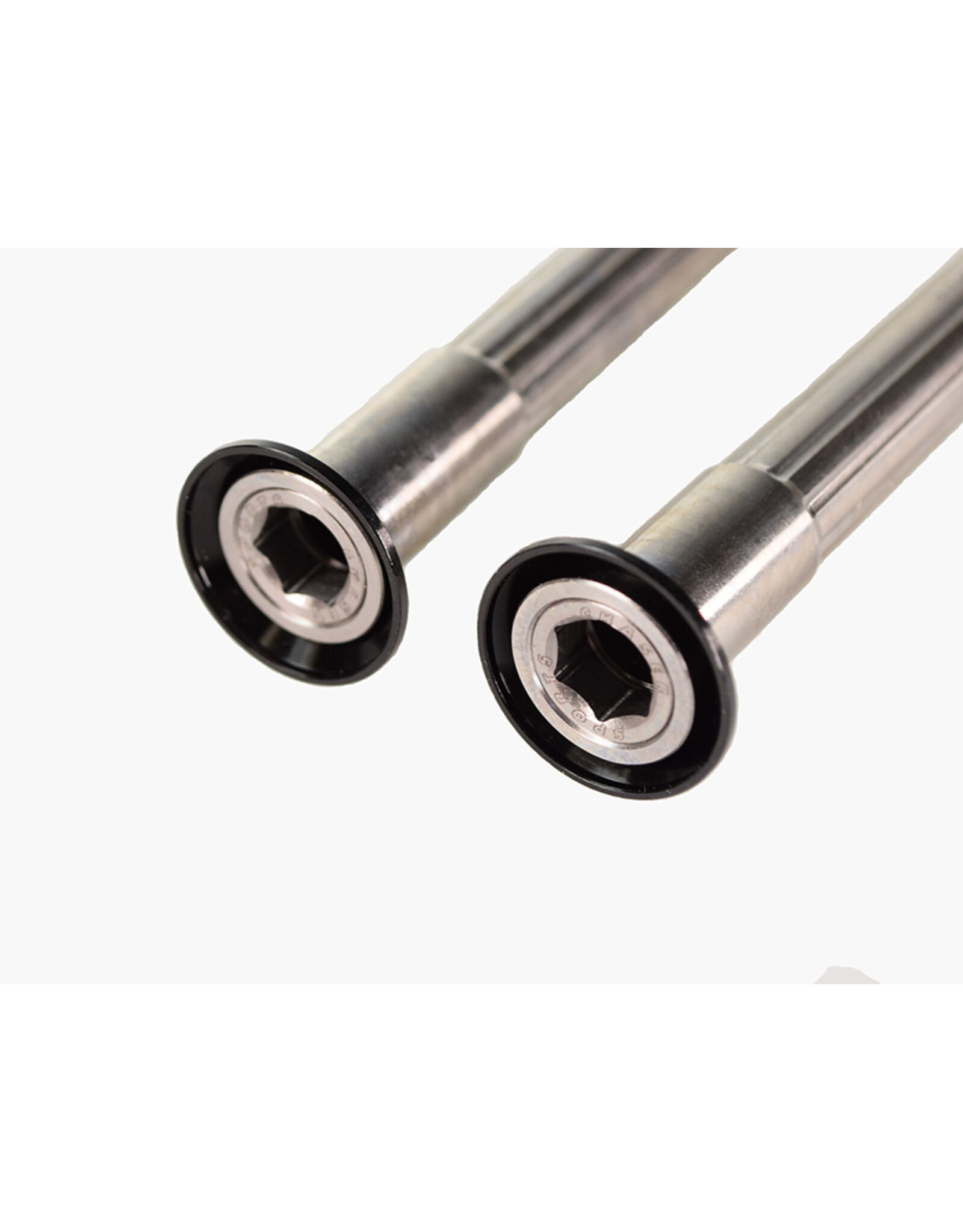

Designed and tested by CS, these thru axle sets are designed specifically for select Specialized and Trek bikes. CNC machined from TC11 titanium and 7075 aluminum each set weighs in at an impressive ~31.5 grams. Each thru axle has a double sided 8mm hex fitting for easy installation.

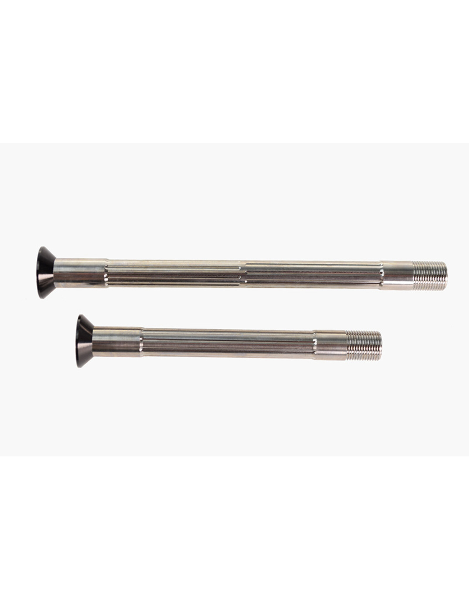

| Interface | Length | Thread Pitch | Thread Length | Weight | |
| Aethos, SL6, SL7, SL8, Crux, Diverge | |||||
| Front | Conical | 118 mm | 12 x 1.0 mm | 13.6 mm | ~14g |
| Rear | Conical | 162 mm | 12 x 1.0 mm | 13.6 mm | ~17.5g |
| Madone Gen8 | |||||
| Material | TCU11 / ALU7075 | ||||
| Tool Fitting | 8 mm Hex | ||||
| Compatibility | Specialized, Trek | ||||
| Recommended Torque | 8 - 10Nm | ||||
