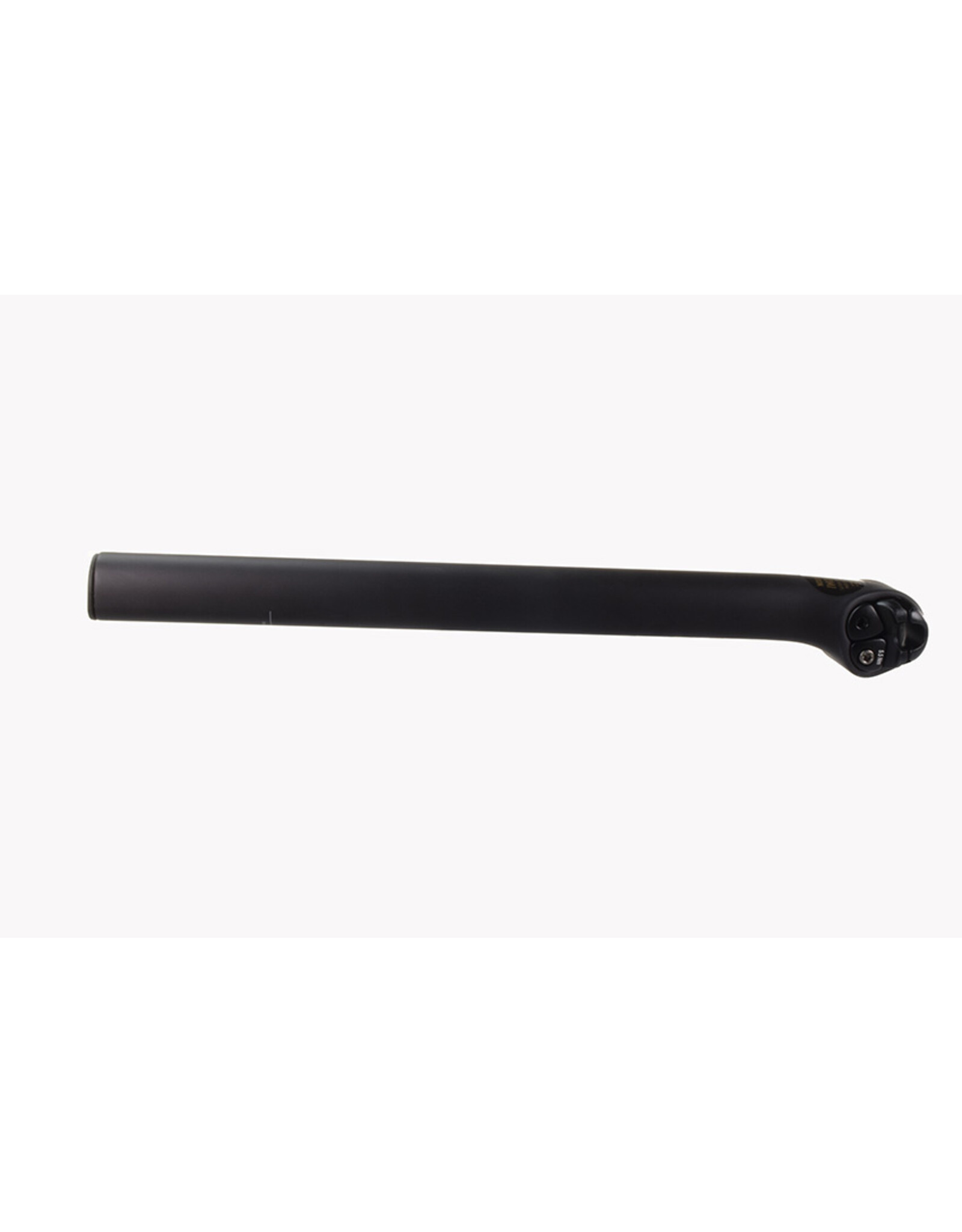

ENVE’s Melee / Fray Aero Seatpost is the proprietary D-shaped carbon post designed specifically for the ENVE Melee and ENVE Fray chassis. The Kamm-tail profile supports the frame’s aero intent while maintaining fit flexibility through multiple lengths and setbacks. A secure wedge clamp interface and ovalized head help reduce the chance of saddle slip, and the twin-bolt saddle clamp makes angle adjustments straightforward—especially helpful when dialing in a performance road position.
Fit options that matter
  • Lengths: 275mm and 350mm
  • Setback options: 0mm or 20mm
  • Minimum insertion: 75mm
Secure saddle interface
  • Twin-bolt clamp for precise saddle tilt adjustment
  • Compatible with 7x7, 7x9, and 7x10 saddle rails
Chassis-specific (not a 27.2 post)
This is a proprietary D-shaped aero post intended for ENVE Melee / Fray frames. It is not interchangeable with standard round 27.2mm seatposts.
Torque specs
  • Saddle rail clamp bolts: 5.5 Nm
  • Seatpost wedge clamp (Melee): 6 Nm
 Length / Offset 275 mm / 0 mm 350 mm / 20 mm 350 mm / 0 mm
 Weight ~161g ~199g ~186g
 Seatpost interface Proprietary D-shaped aero post (ENVE Melee / Fray)
 Torque specs Saddle rail bolts: 5.5 Nm • Seatpost wedge clamp (Melee): 6 Nm
 Minimum insertion 75 mm
 Rail compatibility 7 x 7 mm / 7 x 9 mm / 7 x 10 mm
 Material Seatpost Hardware
  Carbon Titanium
