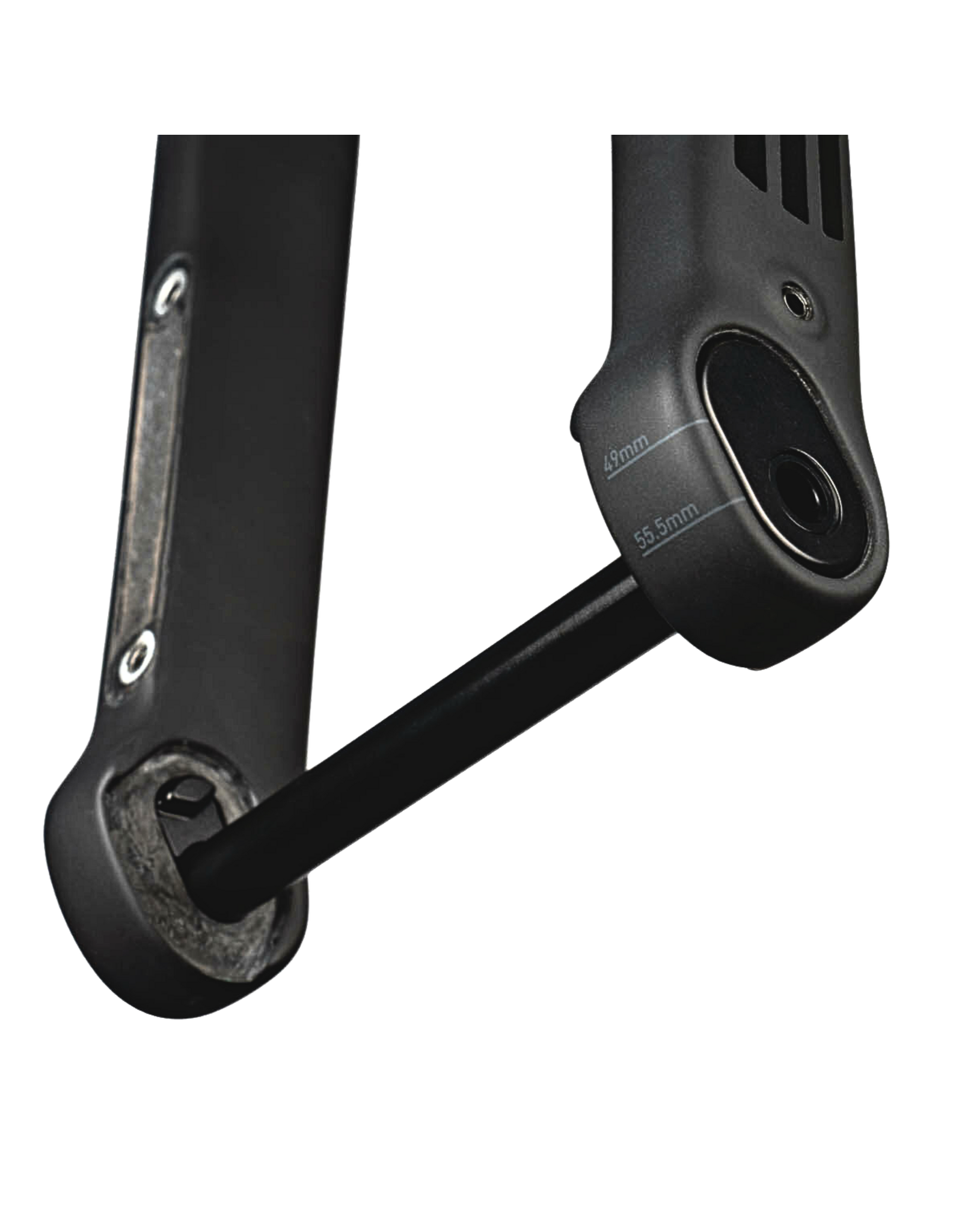

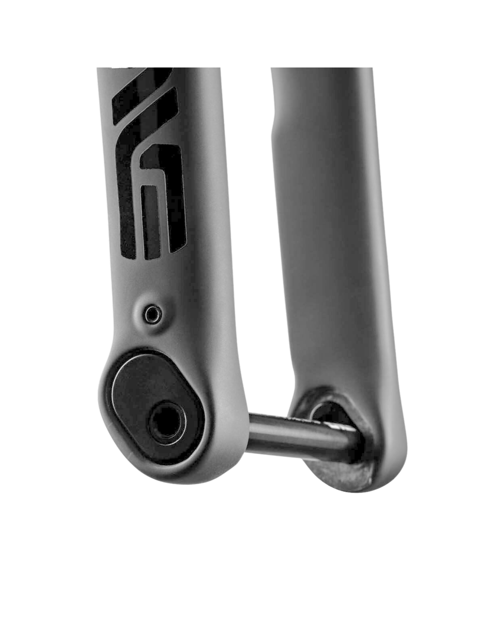

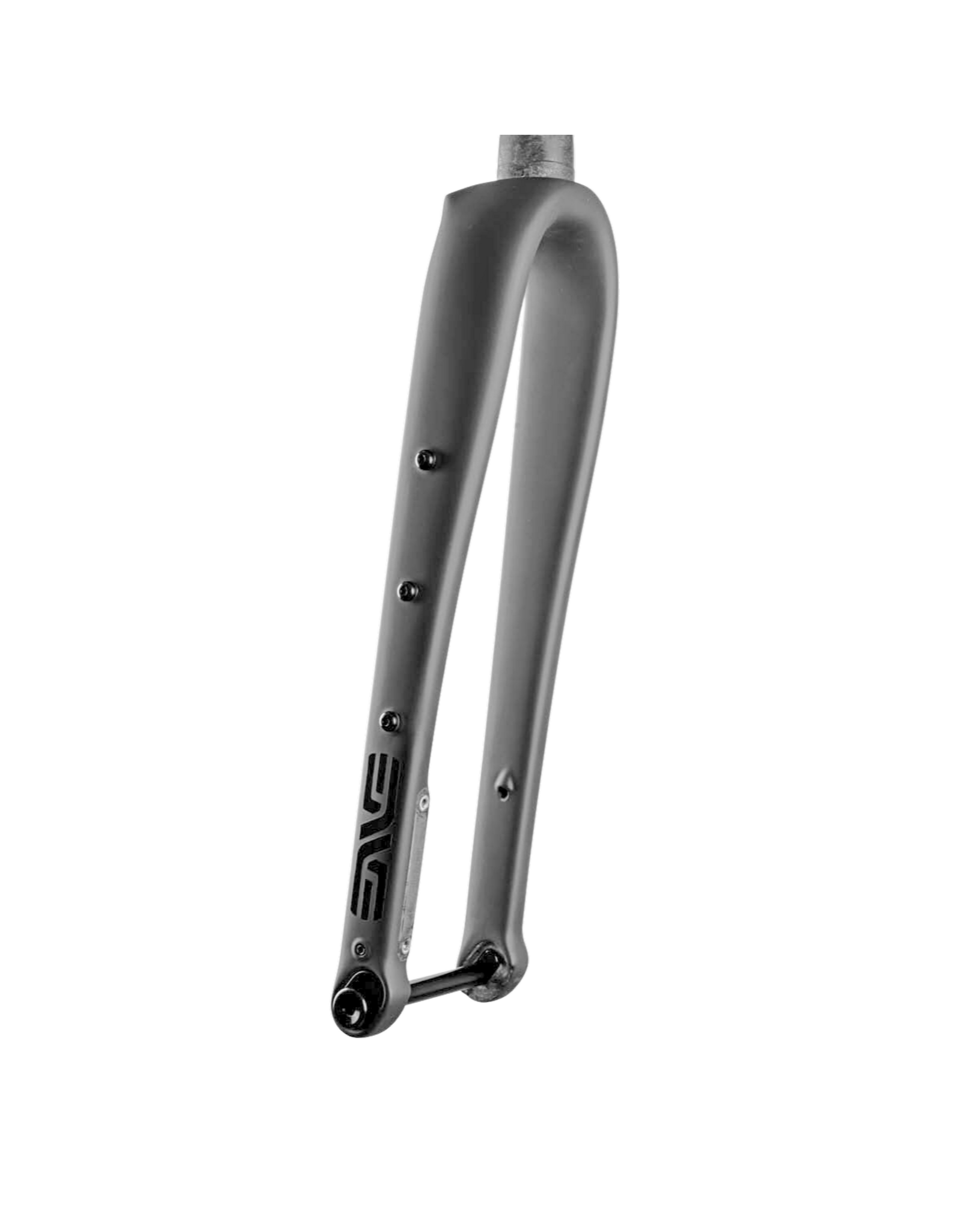

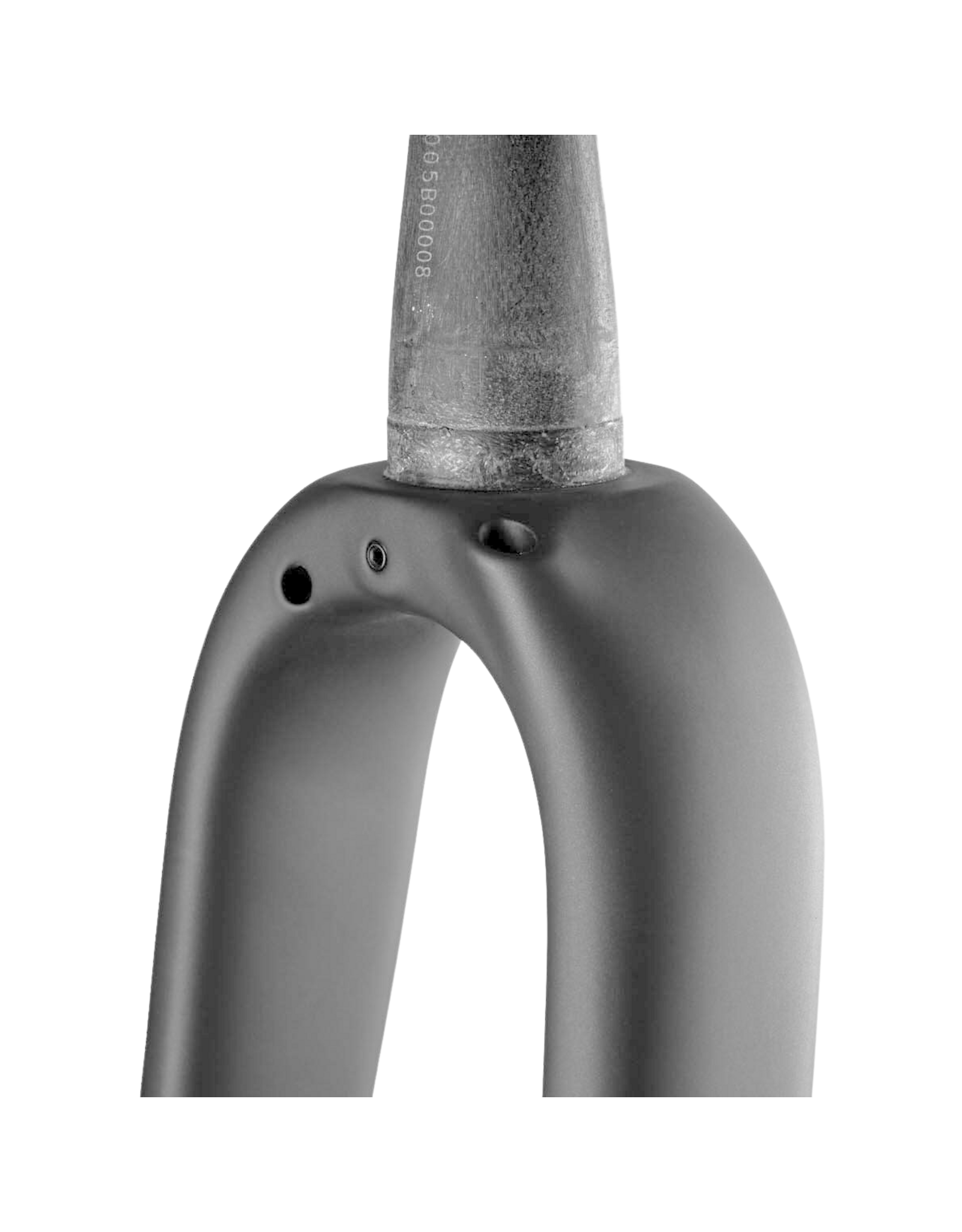

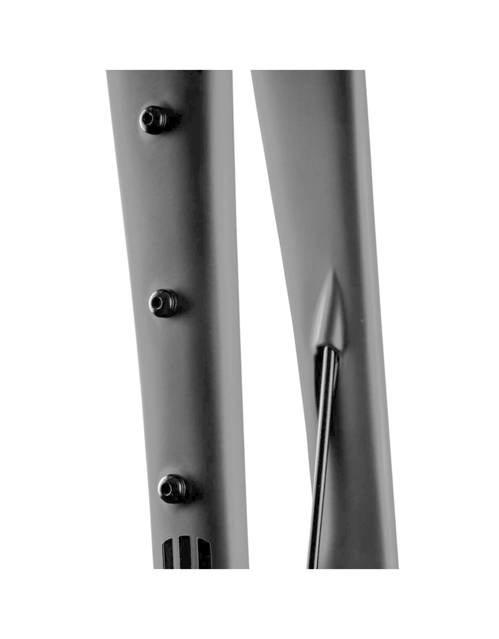

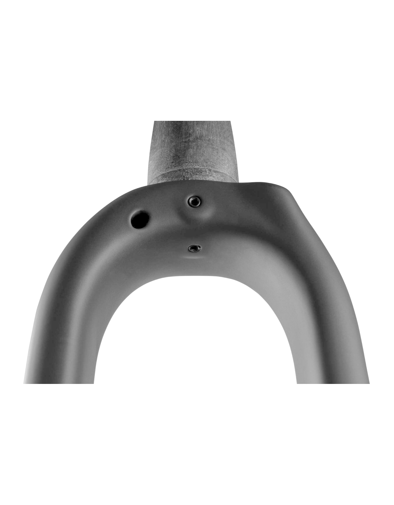

Uncover the advanced engineering of the ENVE Adventure Fork, a carbon fork designed for bikepackers and frame builders who need real versatility. Internal routing supports dynamo wiring for a light or charger setup, while reversible dropout chips let you tune geometry by changing axle-to-crown and rake. Three-pack accessory mounts plus fender and rack mounts make it a true load-capable platform, with 12 x 100mm spacing and flat-mount disc compatibility. The fork includes an aluminum Expander Plug and Carbon Top Cap.
Installation
Expertise and specialized tools are essential for accurate sizing and installation of a carbon fork. We strongly recommend installation by an experienced mechanic.
| Geometry Option | 49 mm | 55.5 mm |
| Axle To Crown | 398 mm | 406 mm |
