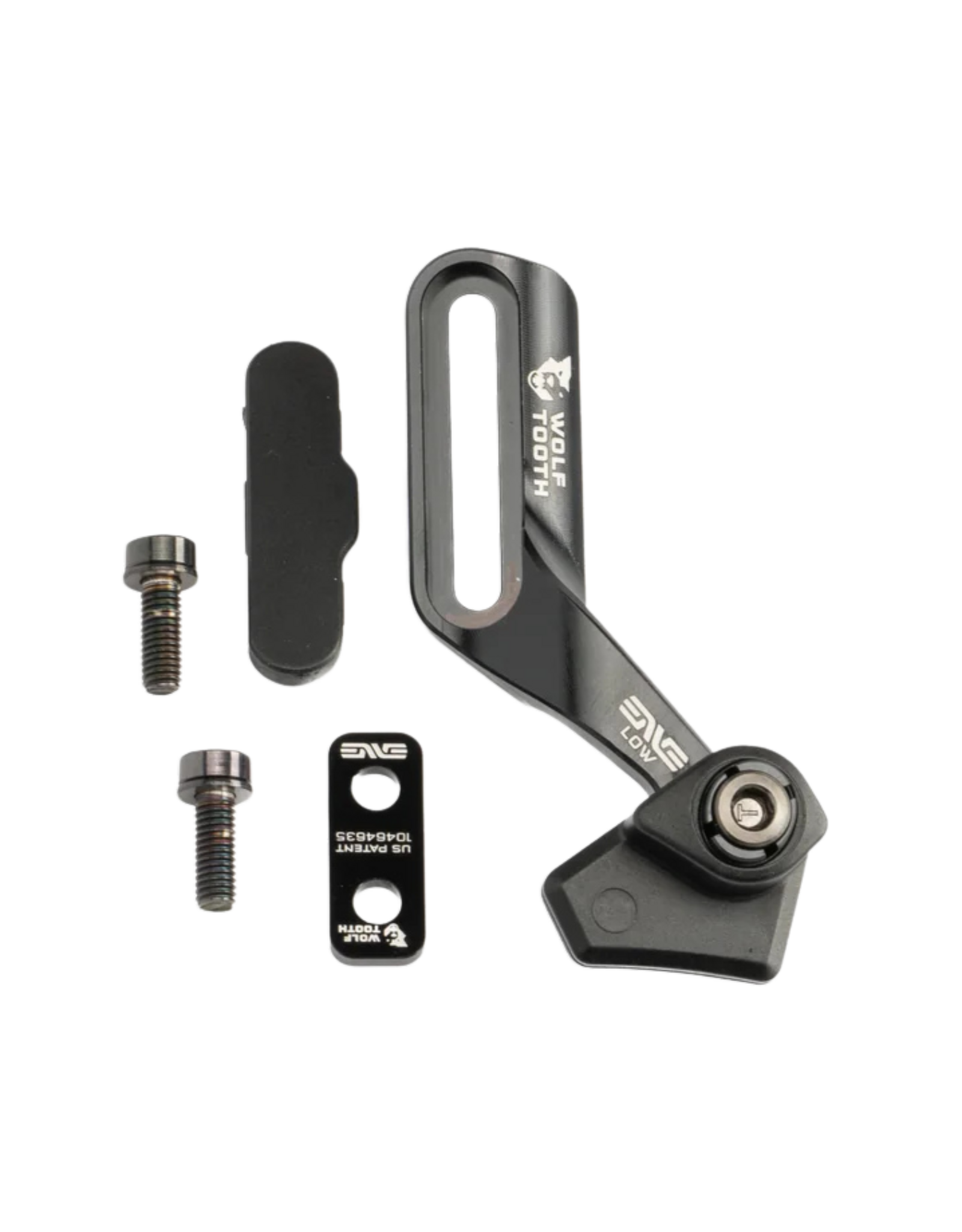

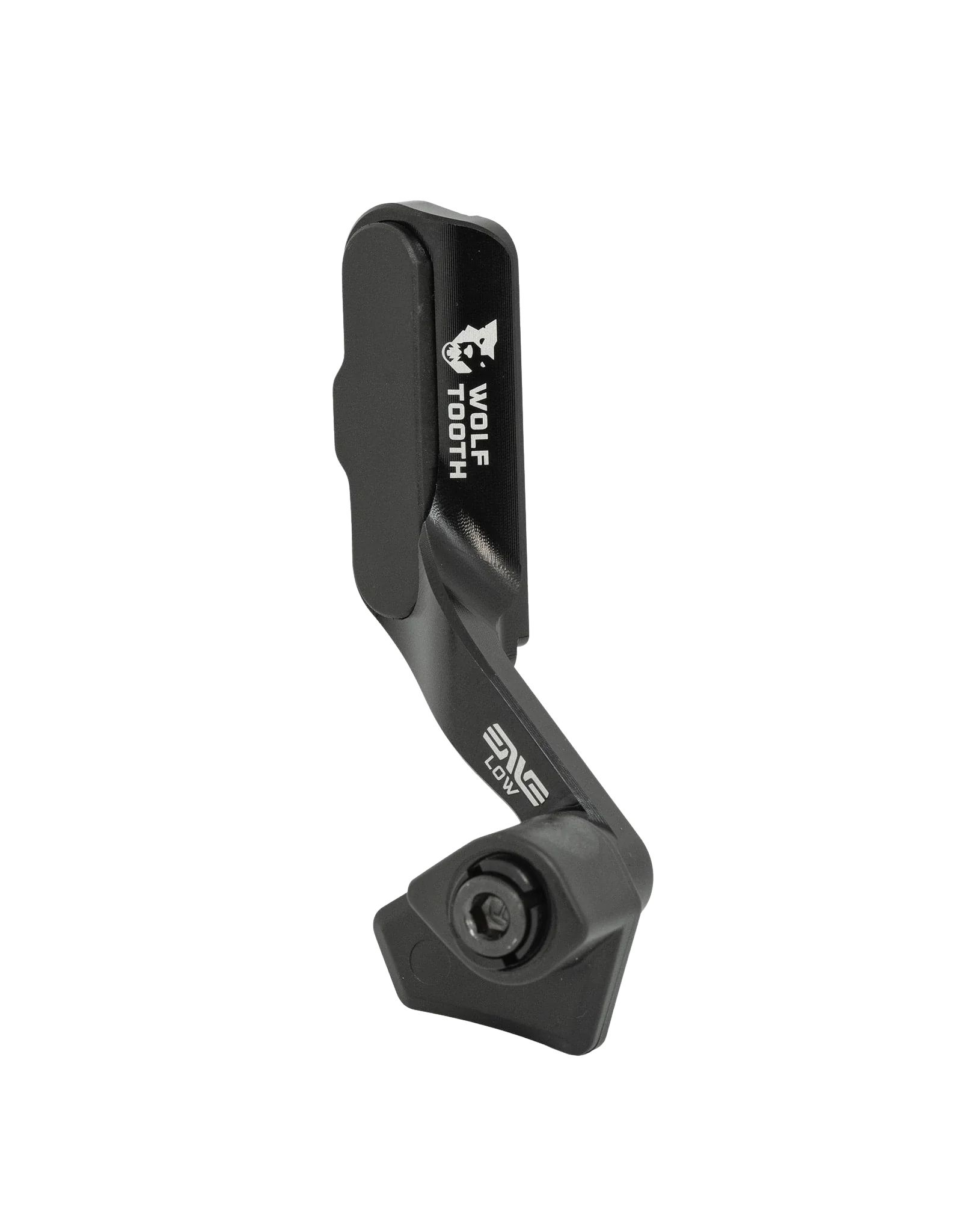

The ENVE x Wolf Tooth LoneWolf Chainguide is a frame-specific chain retention solution for the ENVE MOG configured with a 1x drivetrain. Developed with Wolf Tooth Components, its compact profile provides additional chain security for rough gravel, racing, and mixed-surface riding without adding unnecessary complexity to the drivetrain.
The Low sweep version is designed around 38T to 44T chainrings and integrates cleanly with the MOG frame. At approximately 36g, it adds mechanical chain retention with minimal weight.

Base Material 6061-T6 Aluminum
Hardware Stainless Steel
Guide Head Injection Molded
Approximate Weight 36g
Compatibility ENVE MOG
Installation & Compatibility

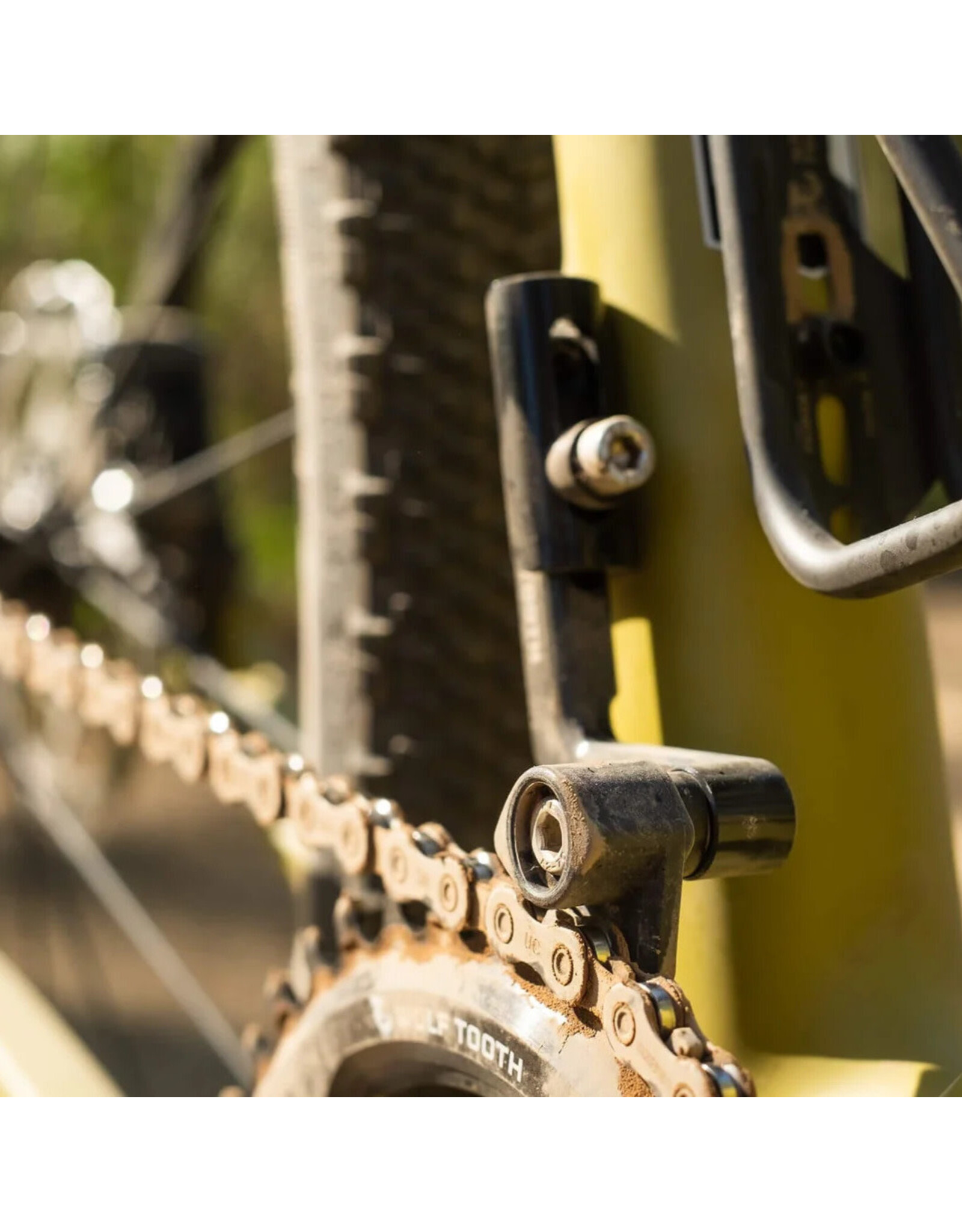

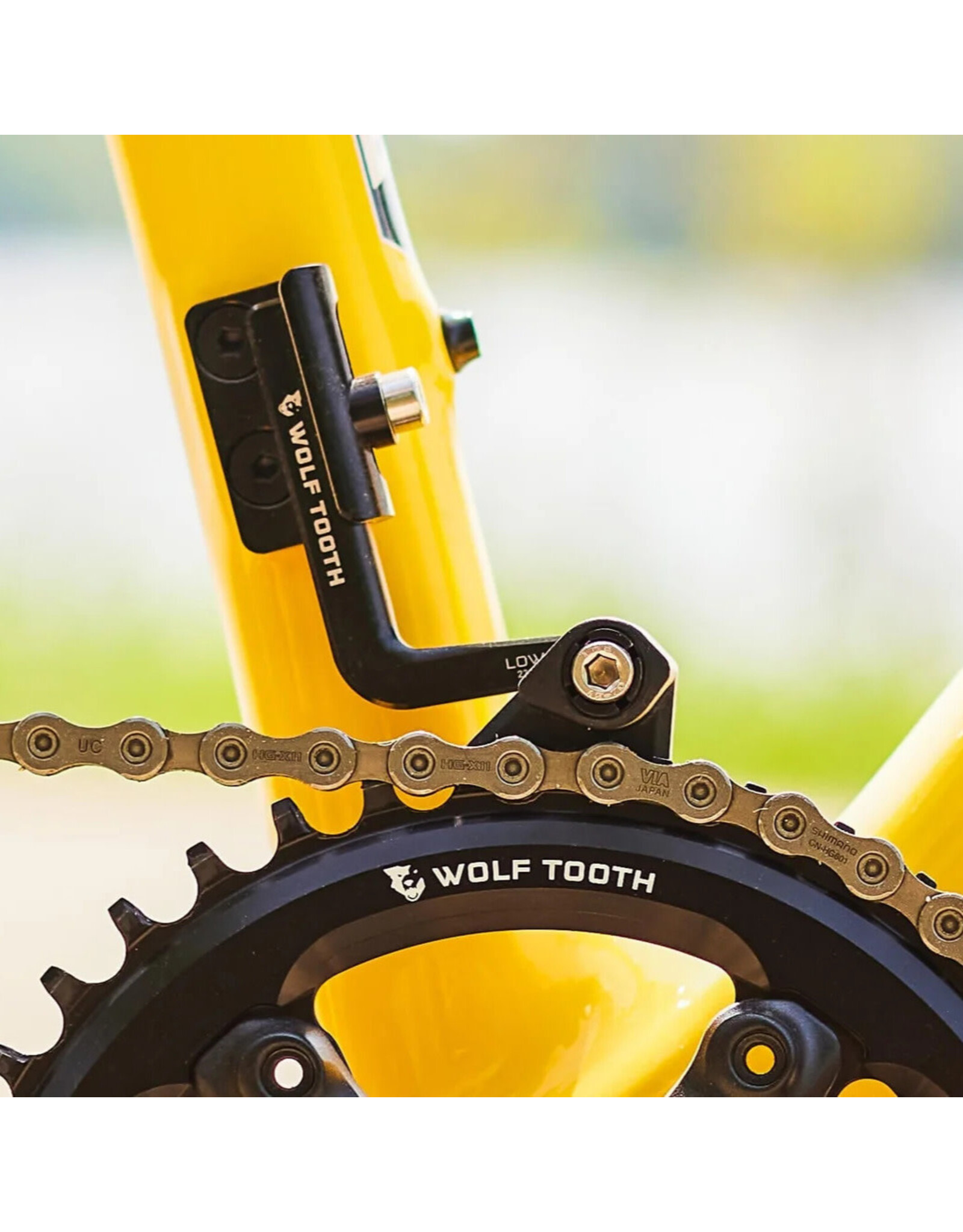

This version of the LoneWolf is specifically configured for the ENVE MOG and 1x drivetrains using 38T to 44T chainrings. The guide mounts to the MOG's front derailleur mounting points using the supplied shim and hardware.
Position the guide approximately 1–2mm from the top and side of the chain. ENVE specifies 2Nm for both the frame mounting bolts and expanding mandrel bolt. After installation, shift through the complete cassette range and confirm that the chain does not contact the guide.
