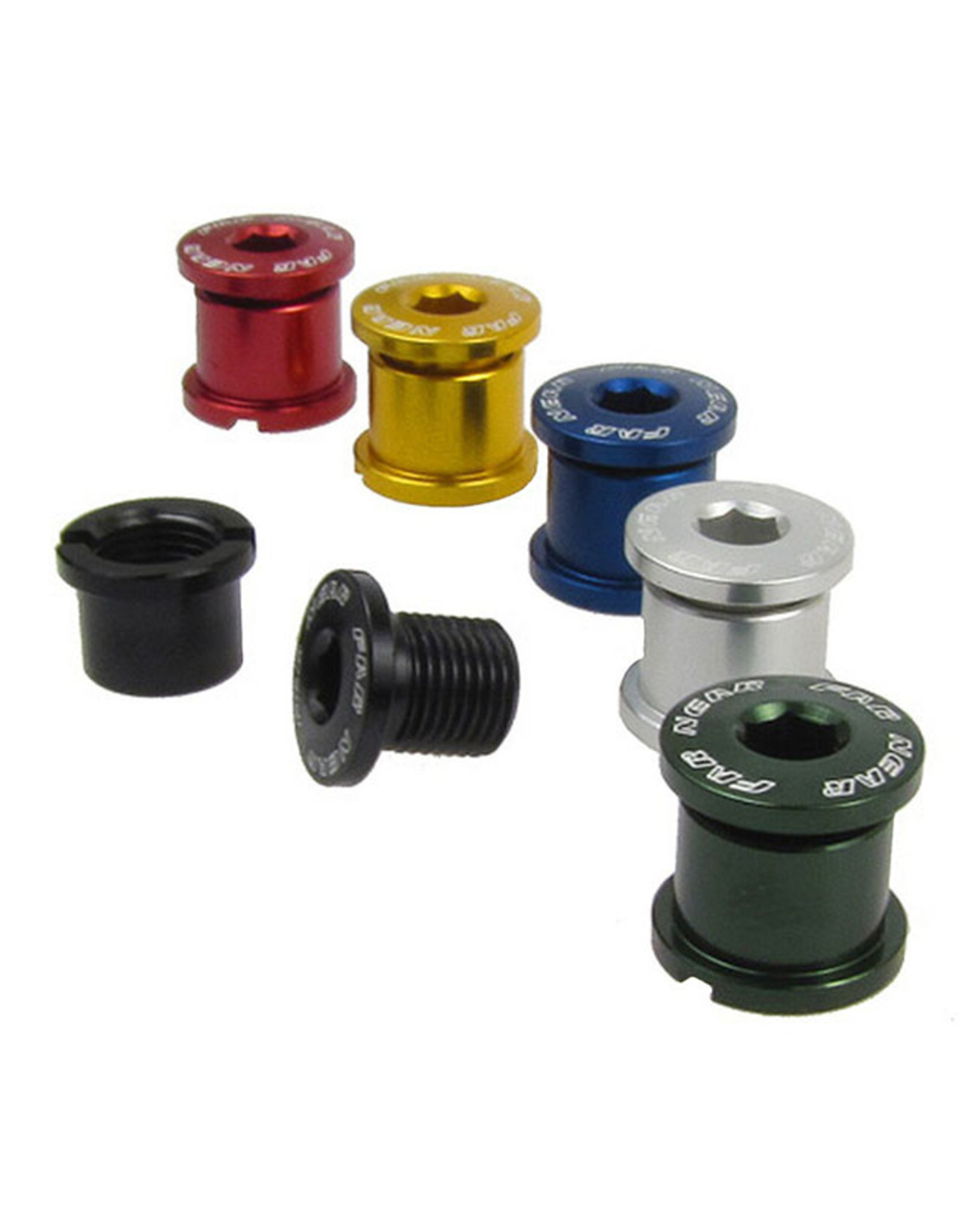

Far and Near offers an affordable and straightforward solution for enhancing both the aesthetics and weight of your bicycle with their aluminum chainring bolts. These sets of bolts and nuts are available in six popular colors, featuring laser-etched graphics, and they provide a weight reduction of approximately 15 grams compared to traditional steel chainring bolts.
Each package contains five bolts and nuts. Far and Near Chainring Bolts are primarily designed for road double cranksets, but they are compatible with any crankset that follows the standard double chainring bolt design.

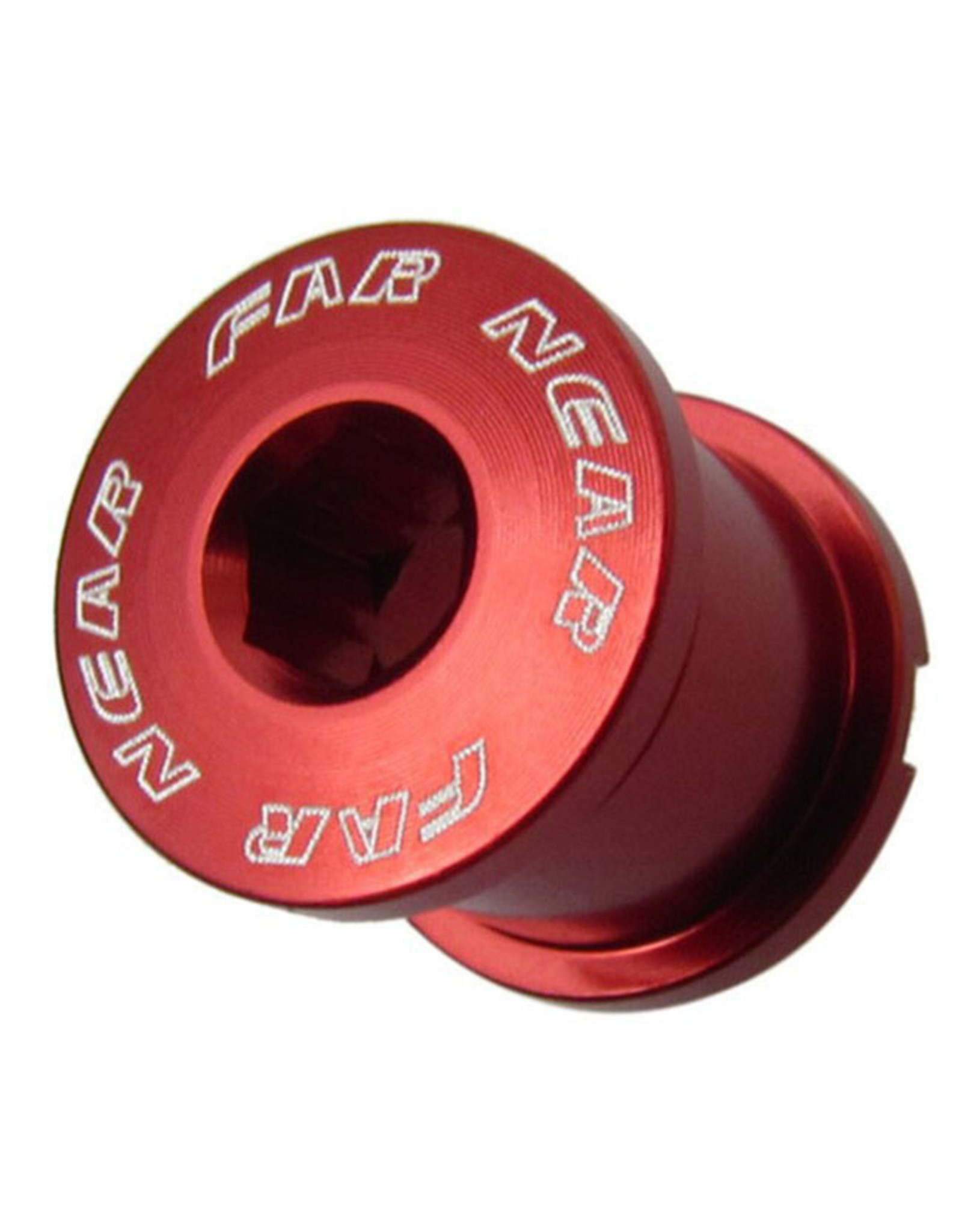

INSTALLATION
Installing Far and Near Chainring Bolts is a breeze with a 4mm hex wrench, and you may need a chainring nut tool. To ensure added security, we recommend using medium-strength Loctite during installation. When using a torque wrench, tighten the bolts to 10Nm.

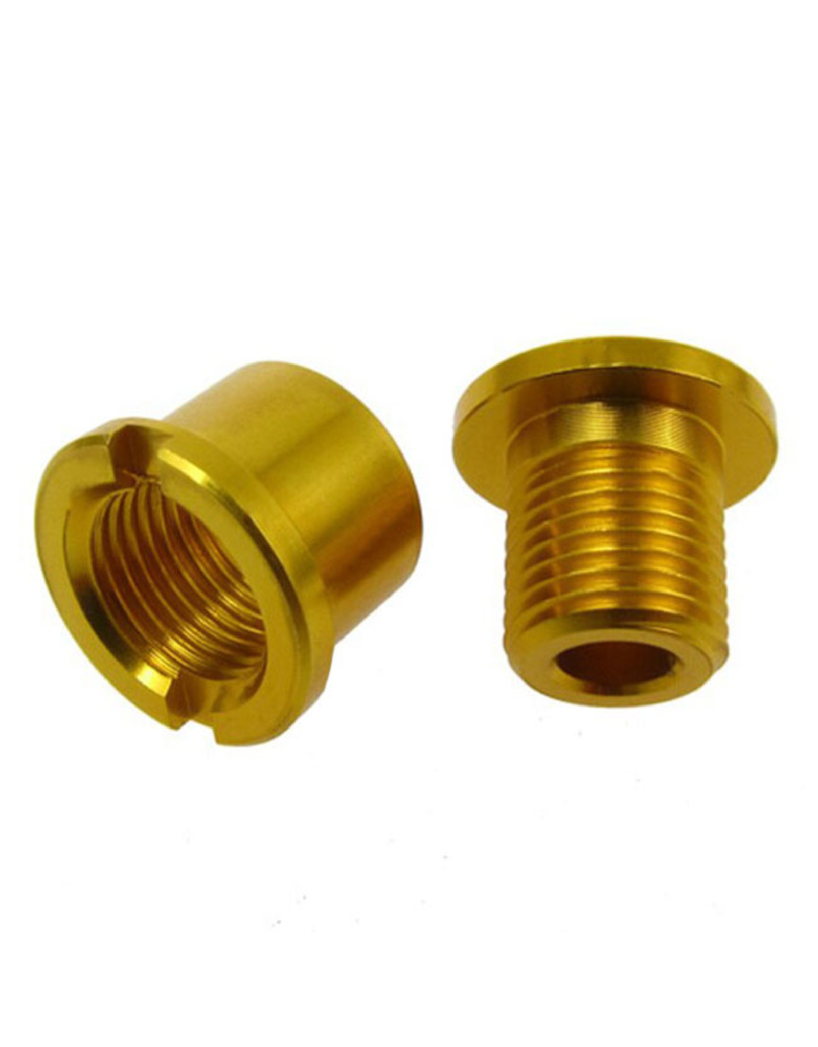

 Weight ~9.6g (per set)
 Material 7075 Aluminum
 Thread Bolt Nut
  M8 x 8.5 mm M8 x 6.7 mm Sleeve
 Bolt Head 4 mm Allen
