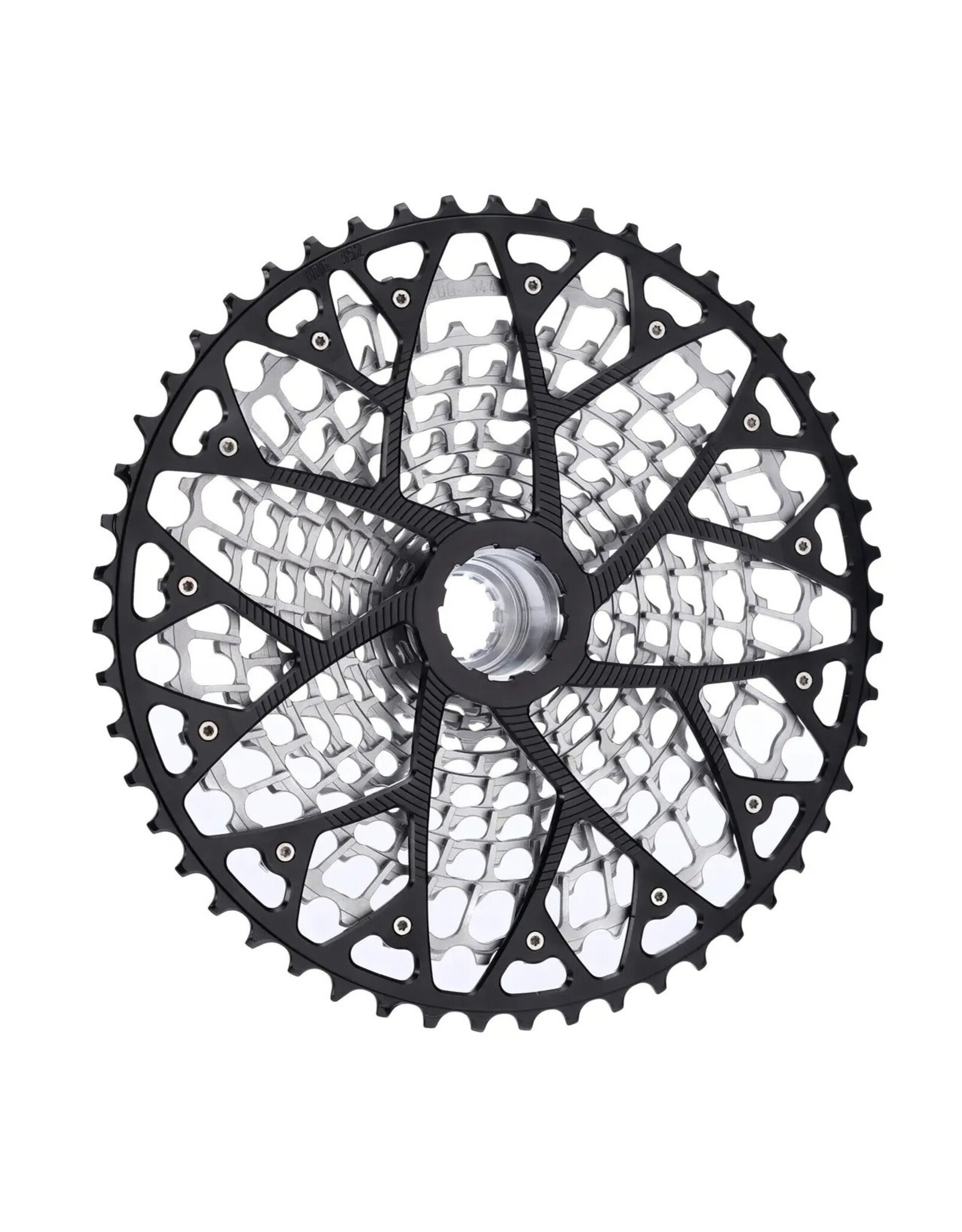

The Garbaruk GEN2.0 13-Speed XPLR Cassette expands SRAM's 13-speed gravel drivetrain to a wide 10–52t range while maintaining a relatively low system weight. Twelve chromoly steel sprockets are paired with a replaceable 7075-T651 aluminum largest cog for a balance of durability, range, and weight.
Updated GEN2.0 tooth profiles and shift ramps are designed to improve shifting under load and chain control across the cassette. The 10–52T progression provides a 520% range, making it well suited to gravel builds that need both close progression in the smaller cogs and a substantially lower climbing gear.
Compatibility
Force XPLR / Rival XPLR: Compatible with the stock 13-speed derailleur cage.
RED XPLR: Requires the Garbaruk 13-speed XPLR derailleur cage for proper 52T clearance and shifting.
The cassette uses a SRAM XD interface. A 1.8 mm spacer is included for installation on XDR freehubs.
  • 13-speed 10–52T gearing with 520% range
  • GEN2.0 tooth profiles and shift ramps
  • 12 chromoly steel sprockets with replaceable aluminum 52T cog
  • Designed for SRAM 13-speed AXS XPLR drivetrains
  • Compatible with SRAM 13-speed Flattop chains
  • XD cassette interface with included XDR spacer
  • E-bike compatible
  • CNC-machined construction
Speed 13-Speed
Range 10–52T / 520%
Gearing 10-11-12-14-16-18-21-24-28-32-37-44-52
Weight ~345 g ±2%
Material Chromoly Steel / 7075-T651 Aluminum
Freehub SRAM XD / XDR With Included 1.8 mm Spacer
Chain SRAM 13-Speed Flattop
Rear Derailleur SRAM RED / Force / Rival XPLR 13-Speed*
E-Bike Compatible Yes
