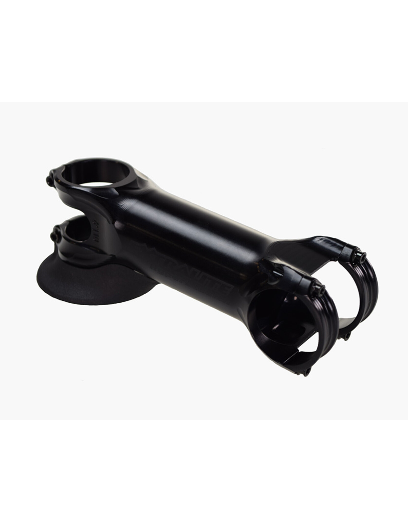

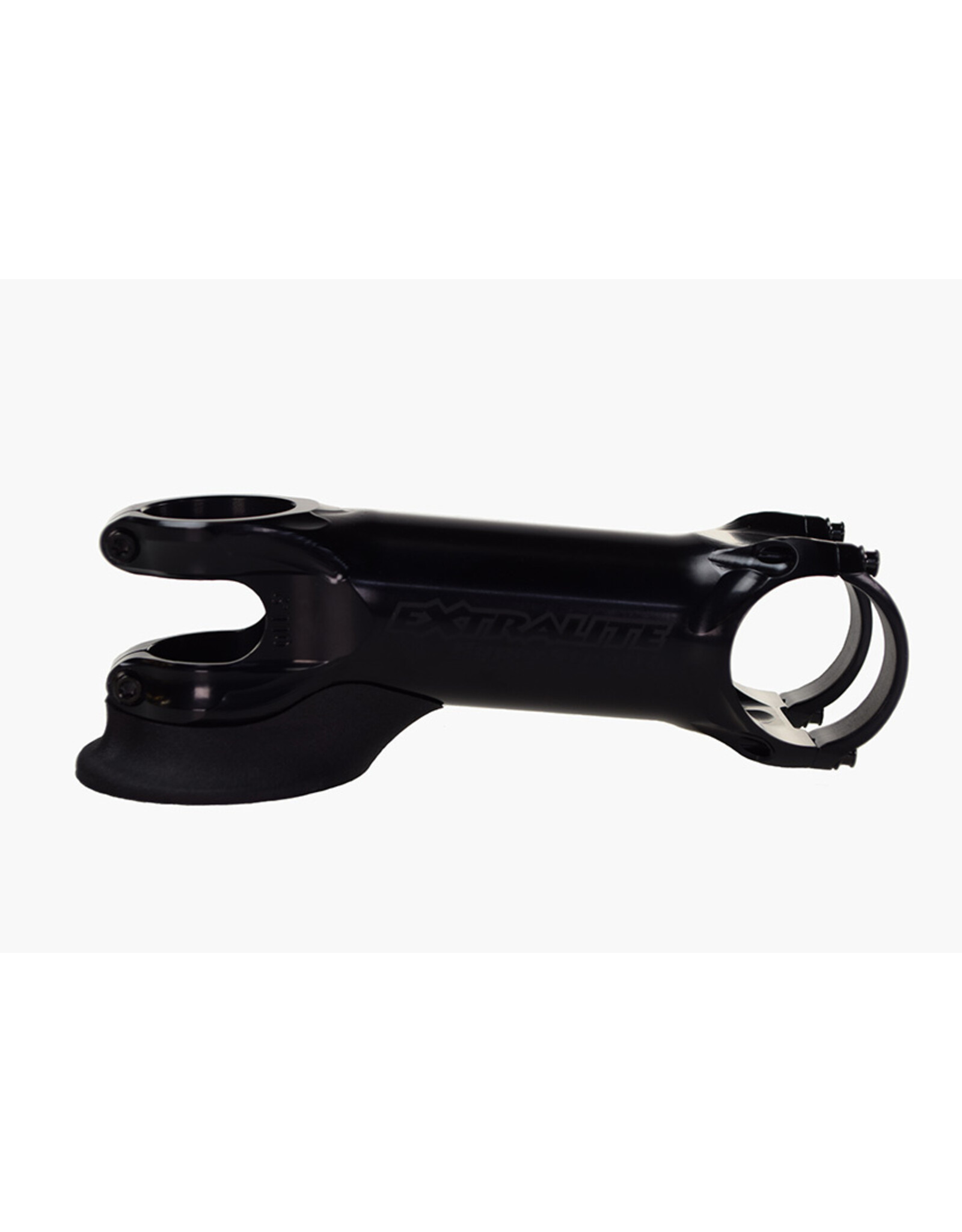

The Extralite HyperStealth Stem is engineered for cyclists who demand top-tier performance with a clean aesthetic. Weighing just 69g for the 80mm length, this stem is fully 3D CNC-machined from high-grade 7075 Txx aluminum, ensuring exceptional stiffness and durability.

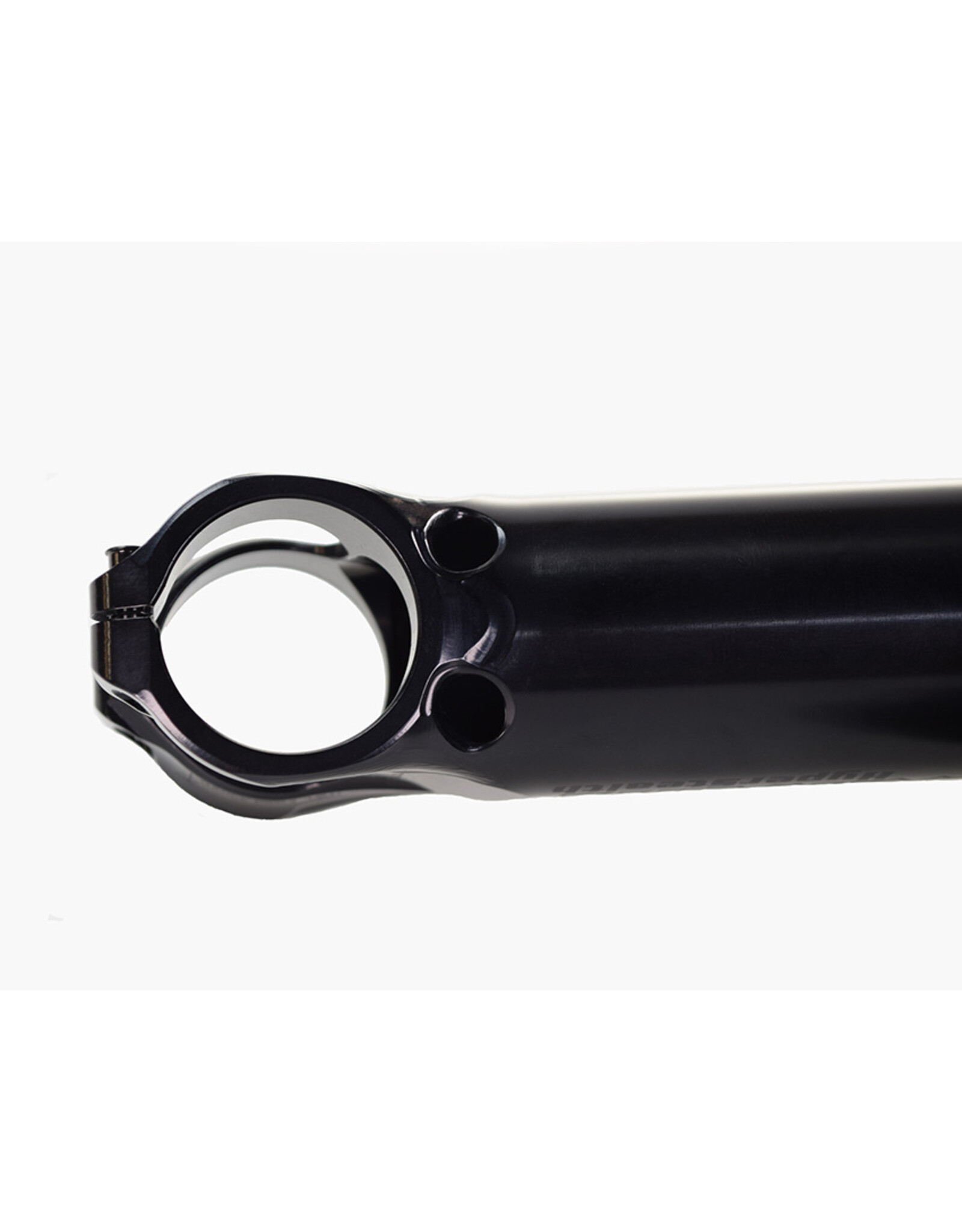

Designed to accommodate internal cable routing, it seamlessly fits up to two brake hoses and electric wires, making it compatible with 1.5" top headsets for internal cable routing. The stem features a -6° angle, a 31.8mm bar clamp diameter, and a standard 1 1/8" (28.6mm) steerer tube diameter. Its ultra-stiff structure efficiently transfers upper body energy, enhancing ride performance.
Additional features include T15 special CNC Grade5 Titanium bolts with black PVD coating, black laser-etched graphics, a fork clamp height of 38mm, and a black anodized finish. The stem's design ensures compatibility with various internal cable routing setups, offering both functionality and sleek integration.
