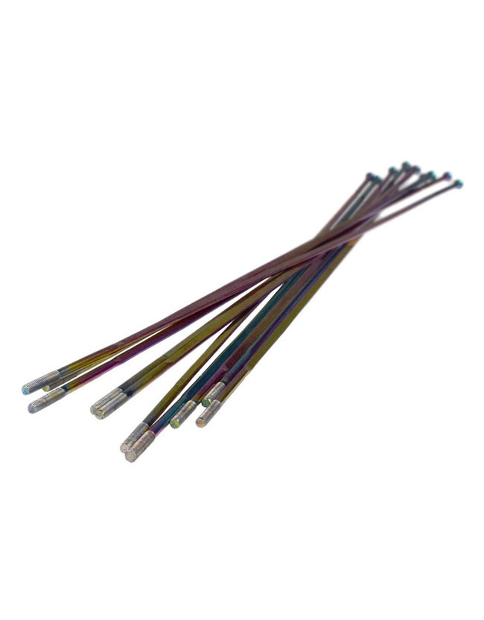

Important: These spokes are supplied in limited base lengths and are cut and threaded to order. You must include your required spoke lengths in the order notes, or specify if threading is not needed.

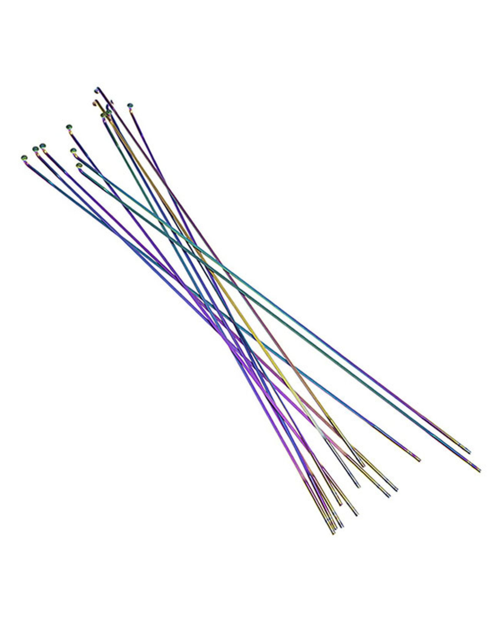

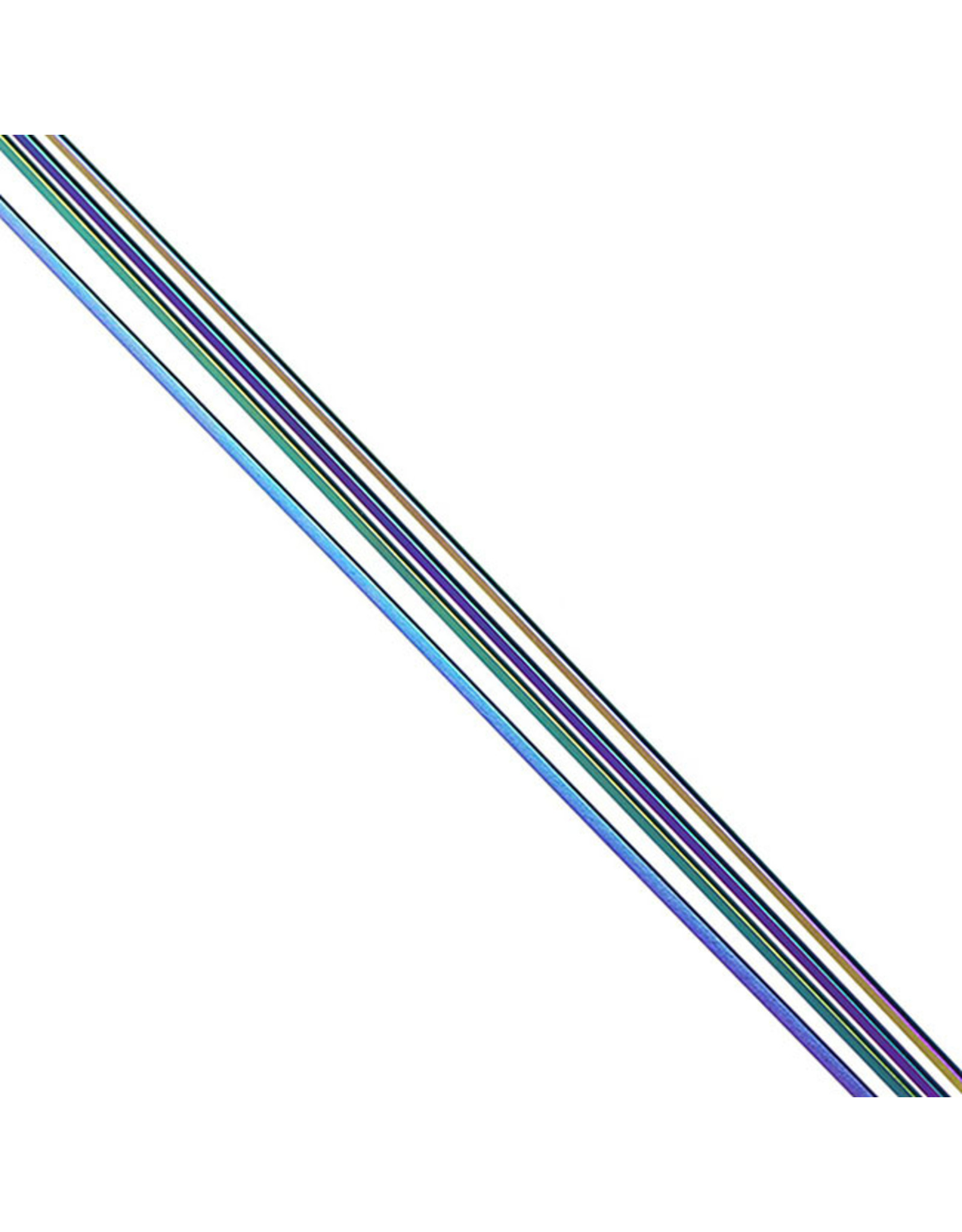

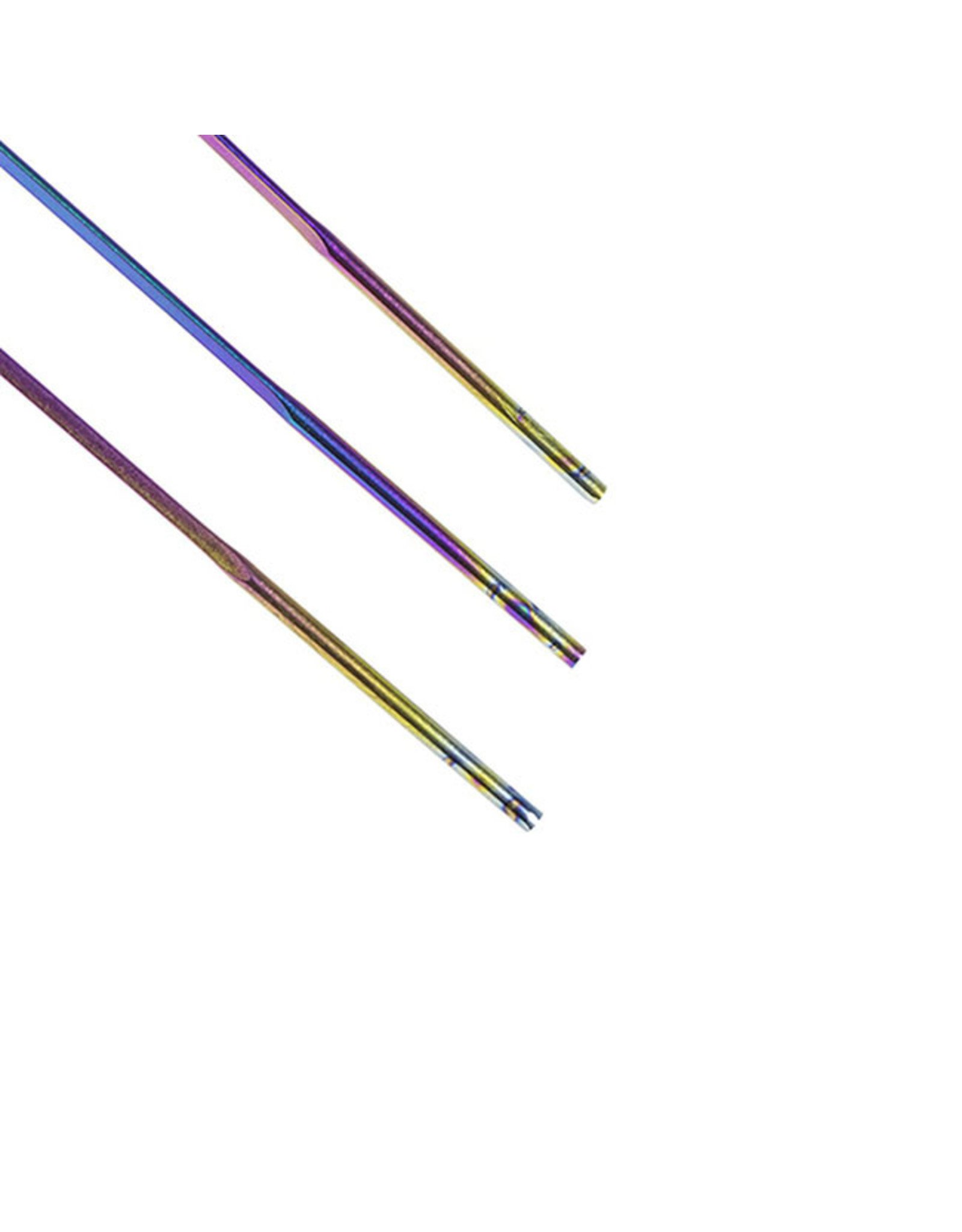

Pillar 1422 Rainbow spokes are a bladed stainless steel spoke designed for aerodynamic performance and durability, featuring a 2.2 x 0.95 mm blade profile with 2.0 mm round ends for standard hub and nipple compatibility.
The slightly wider blade profile provides increased strength and stability compared to lighter aero spokes, while the titanium-plated rainbow finish adds a distinctive visual element to custom wheel builds.

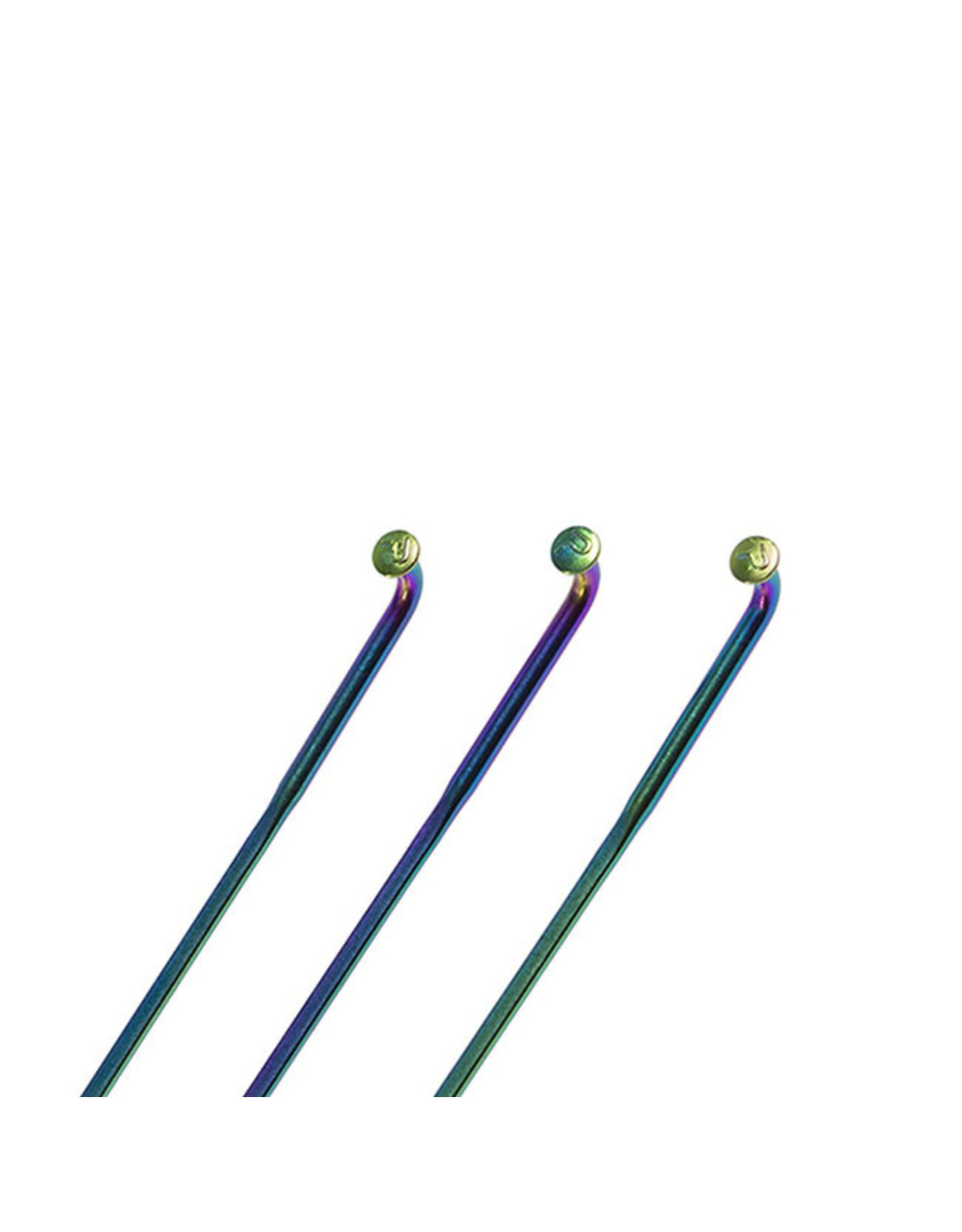

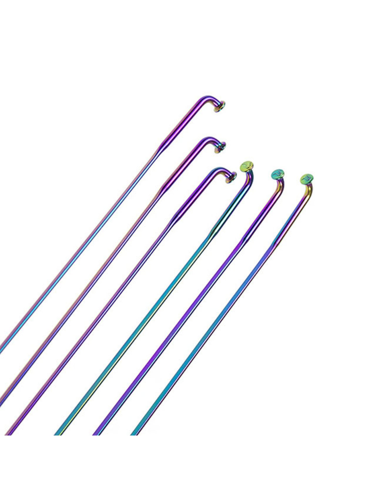

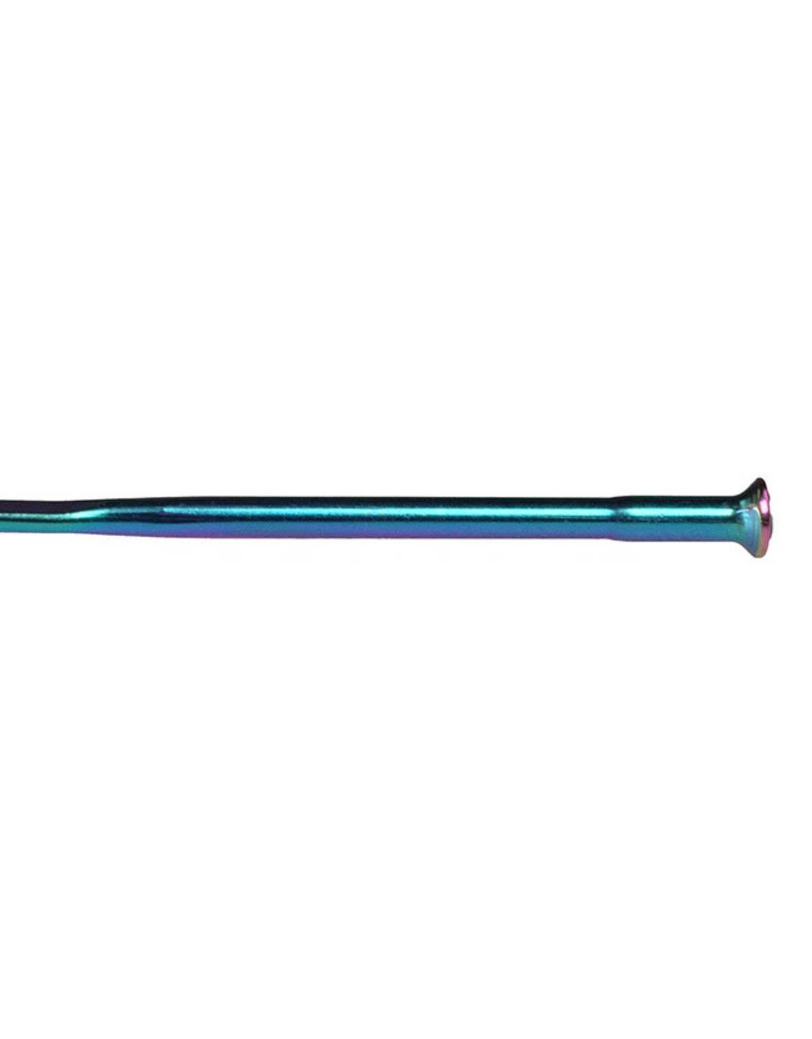

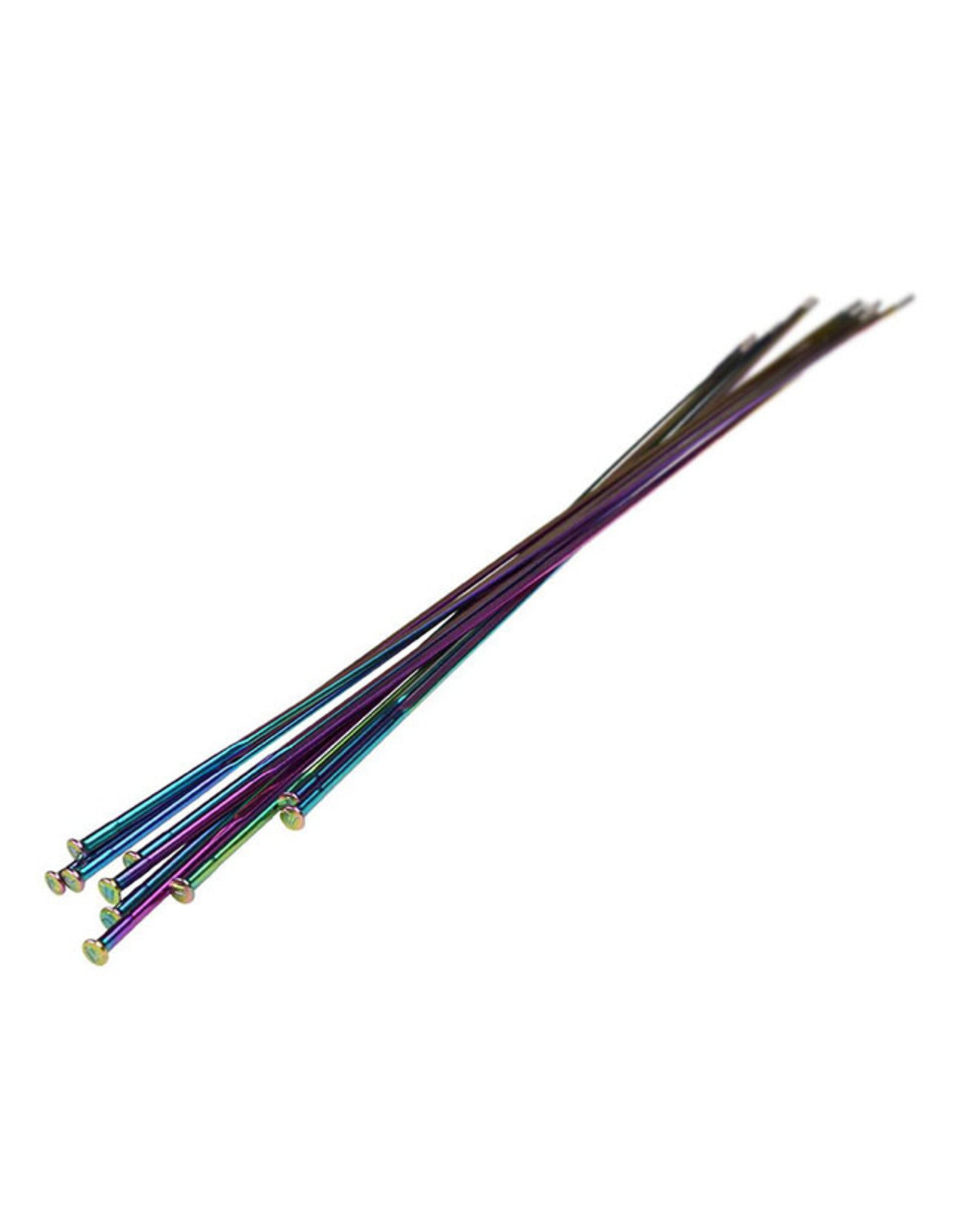

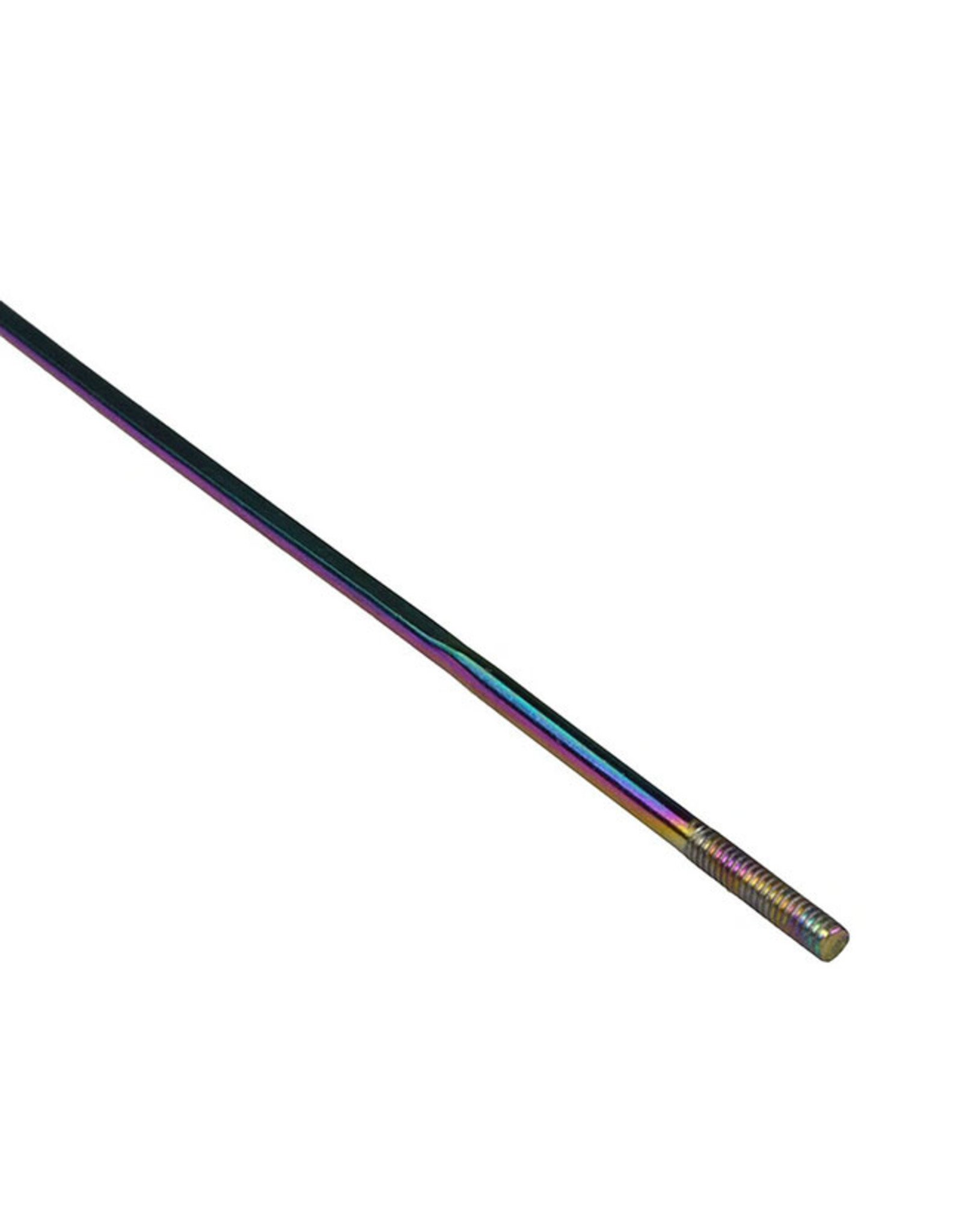

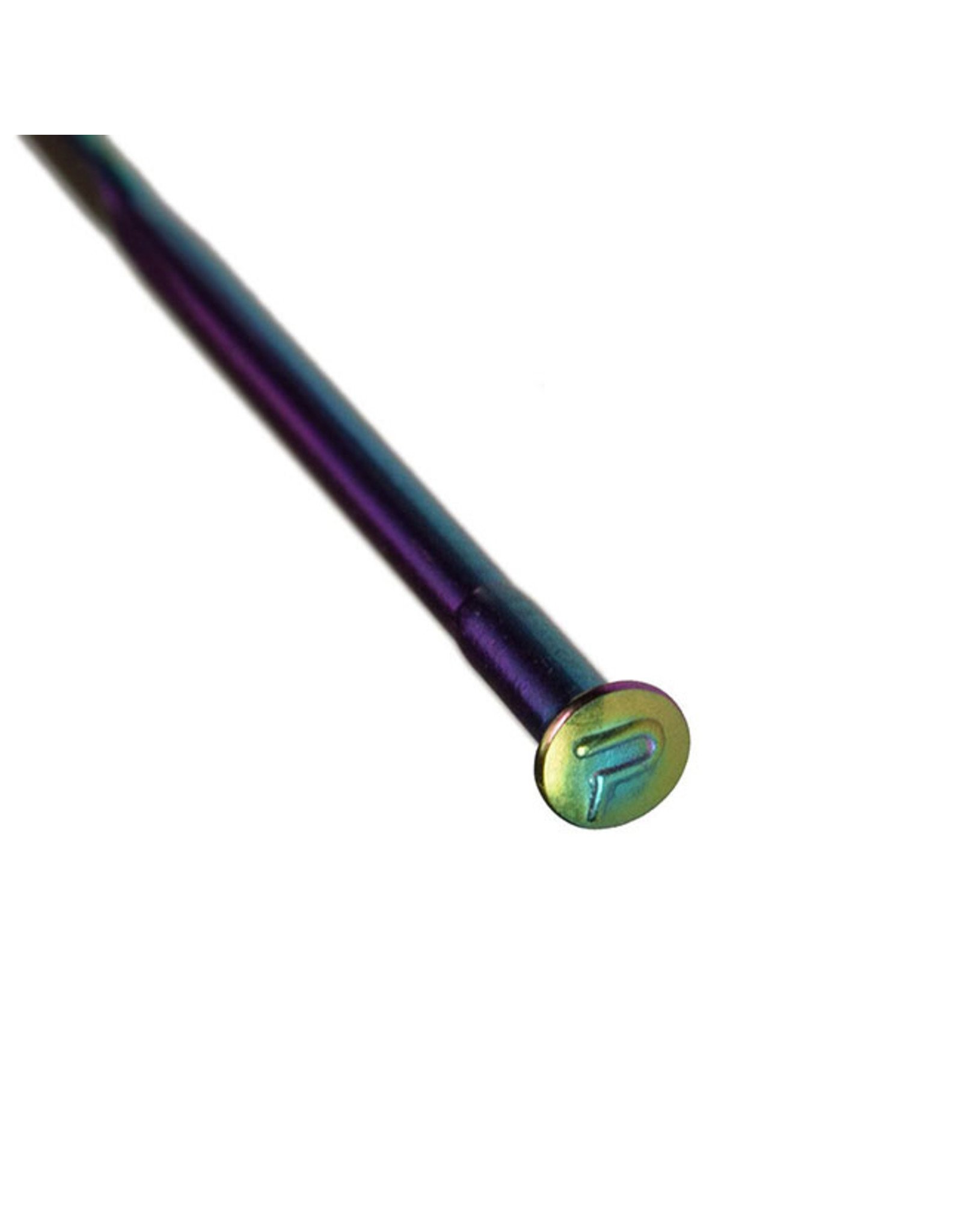

Available in J-Bend and Straight-Pull configurations. Select based on your hub design.
  • Bladed 2.2 x 0.95 mm aerodynamic profile
  • Round 2.0 mm ends for standard compatibility
  • Approx. 4.6–5.1 g weight
  • T302+ stainless steel with titanium-plated finish
  • J-Bend and Straight-Pull options available
