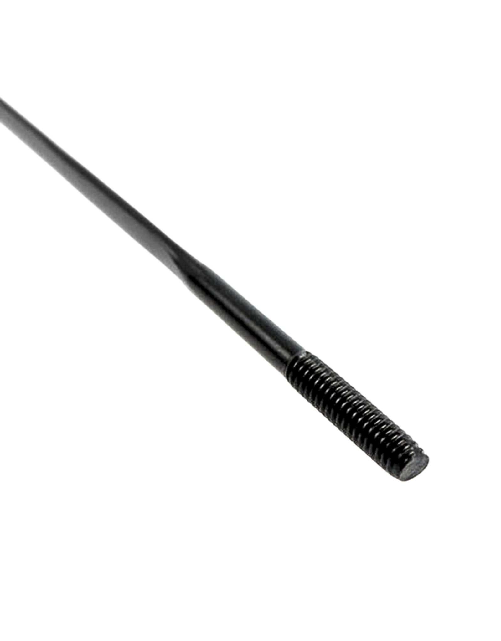

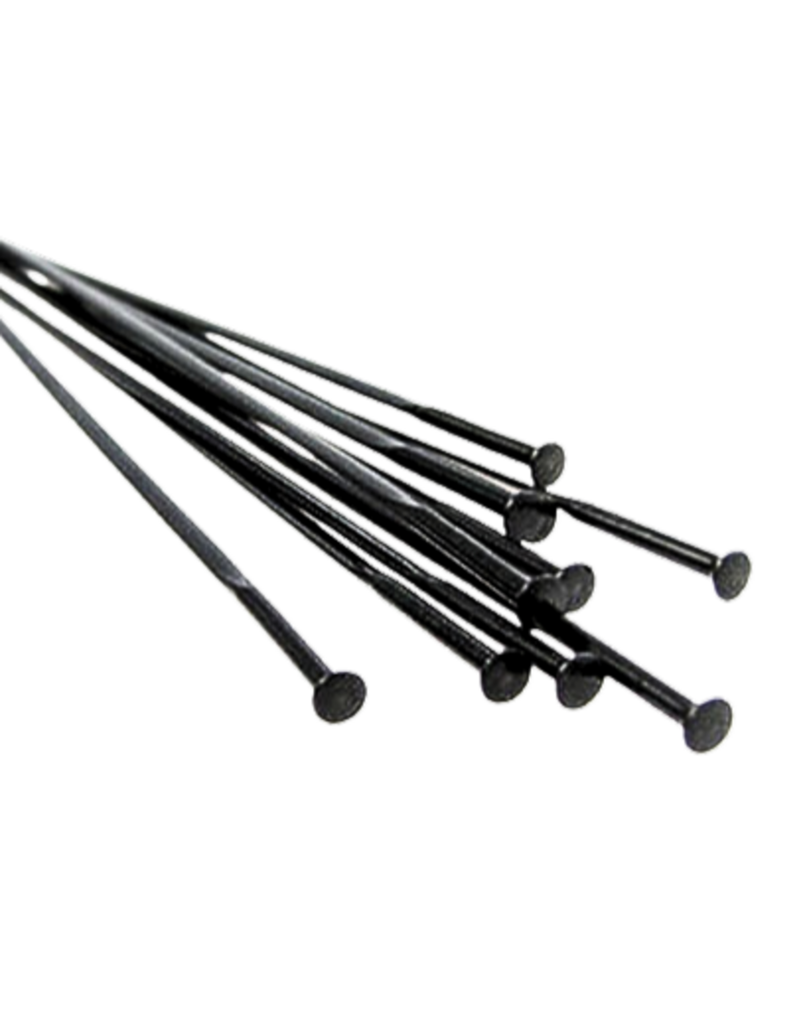

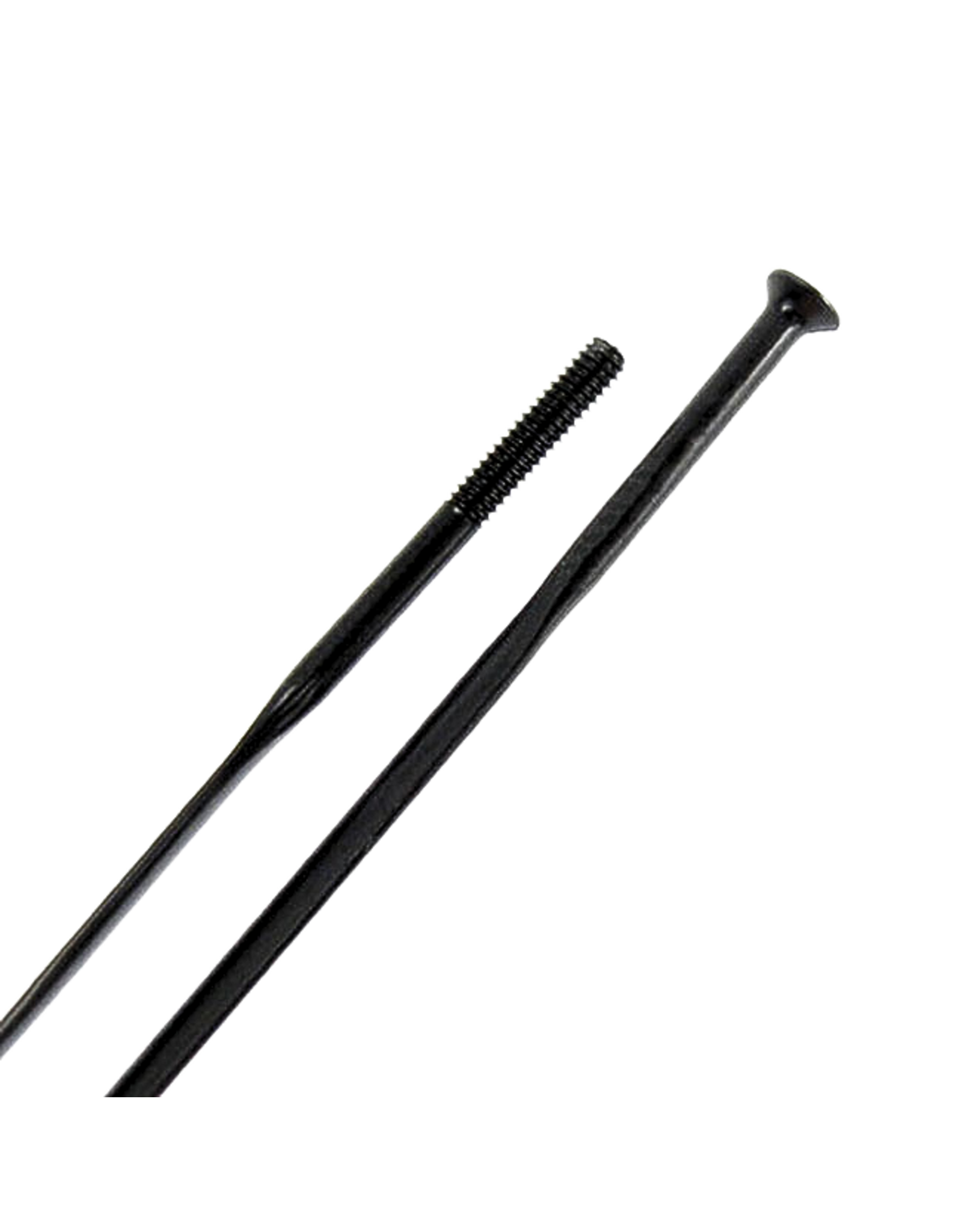

Sapim CX-Sprint Straight-Pull spokes are designed for riders who need greater stiffness and durability than CX-Ray while maintaining aerodynamic performance. Using a 2.0 - (2.25 x 1.25) - 2.0mm profile, CX-Sprint increases material through the center section to improve strength under higher loads.
With a 2.25 x 1.25mm bladed section and 1430 N/mm² tensile strength, CX-Sprint is well suited for powerful riders, low spoke count wheels, and high-load road, gravel, and MTB builds using straight-pull hub systems.
CX-Sprint fills the gap between lightweight aero spokes and traditional double-butted spokes. For lighter builds, consider Sapim CX-Ray.
  • Bladed stainless steel spoke for aerodynamic, high-strength wheel builds
  • Increased stiffness and durability compared to CX-Ray
  • Cold-forged construction for improved fatigue resistance
  • Straight-pull design for modern hub compatibility
  • Compatible with standard 14G / 2.0mm interfaces
CX-Sprint Straight-Pull is built for riders who need more stiffness and durability than CX-Ray without giving up aerodynamic performance.
Best suited for powerful riders, low spoke count wheels, and gravel or MTB builds where added spoke strength improves overall wheel stability.
If you are building for minimum weight and compliance, choose CX-Ray. If you prioritize cost and durability over aerodynamics, choose Sapim Race.
