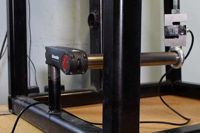

We returned to our test fixture to compare 15 modern road and gravel bike stems using repeatable deflection measurements, recorded weights and stiffness-to-weight calculations. This page explains how we performed the test, how to interpret the measurements and what the results suggest about materials, aerodynamics and internal routing, with direct access to BikeRumor’s complete data and analysis.
Road & Gravel Stem Stiffness Testing
We returned to our component test fixture to evaluate 15 modern road and gravel stems. Using the same repeatable approach behind our earlier testing, we measured deflection, recorded weight and calculated stiffness-to-weight ratio so riders can compare different design priorities with objective data.
BikeRumor published the complete results, including the full 2024 data, comparisons with our 2014 test group and an additional stem-length experiment.

How the Stems Were Tested
Repeatable Setup
Each stem was installed at its specified torque and tested three times, with the results averaged.
Controlled Load
After a 20 lb preload, the fixture was zeroed and a 100 lb load was applied 10 inches from the stem centerline.
Comparable Sizing
The group primarily used 110 mm stems with closely matched angles to limit variables between models.
