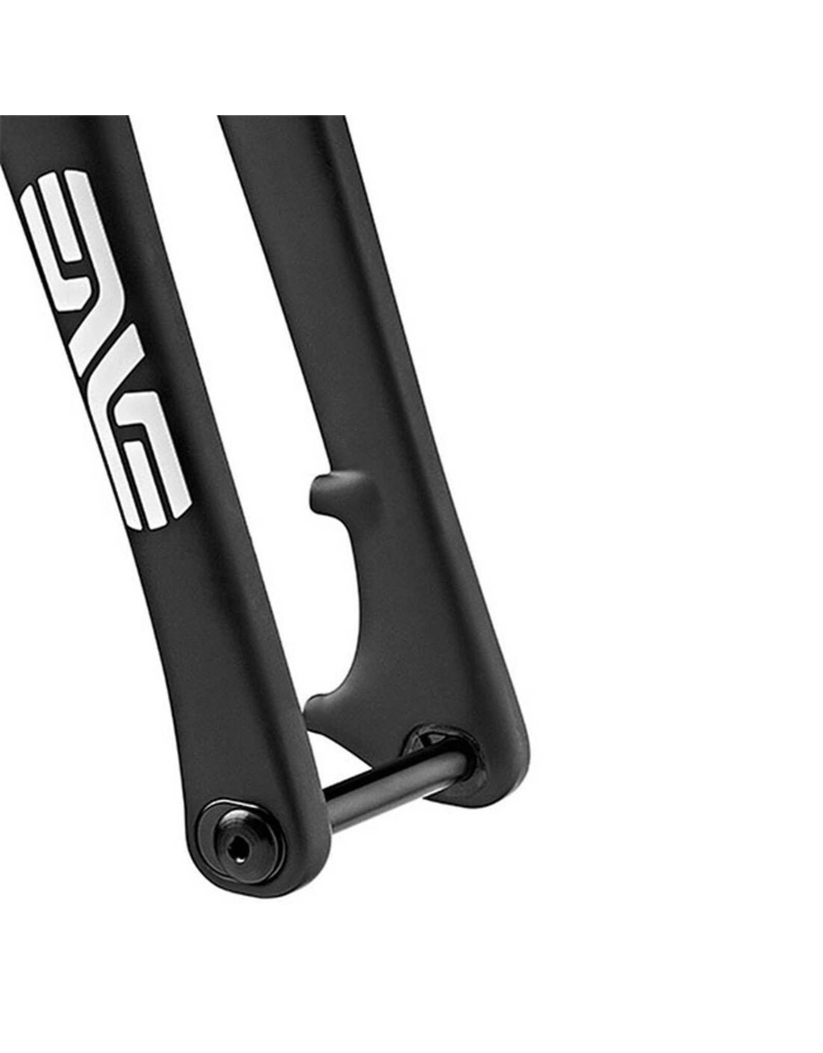

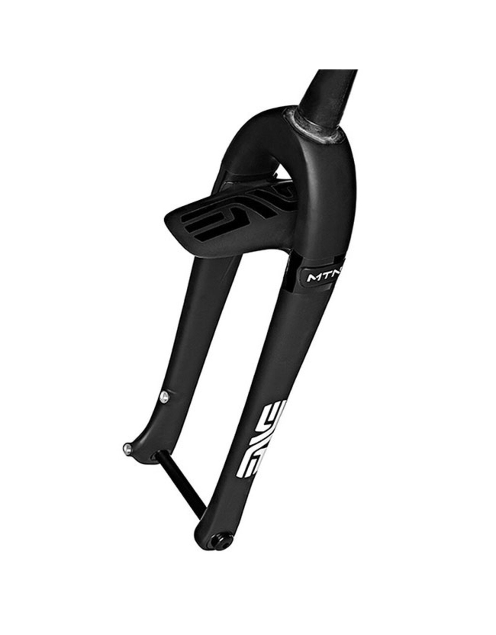

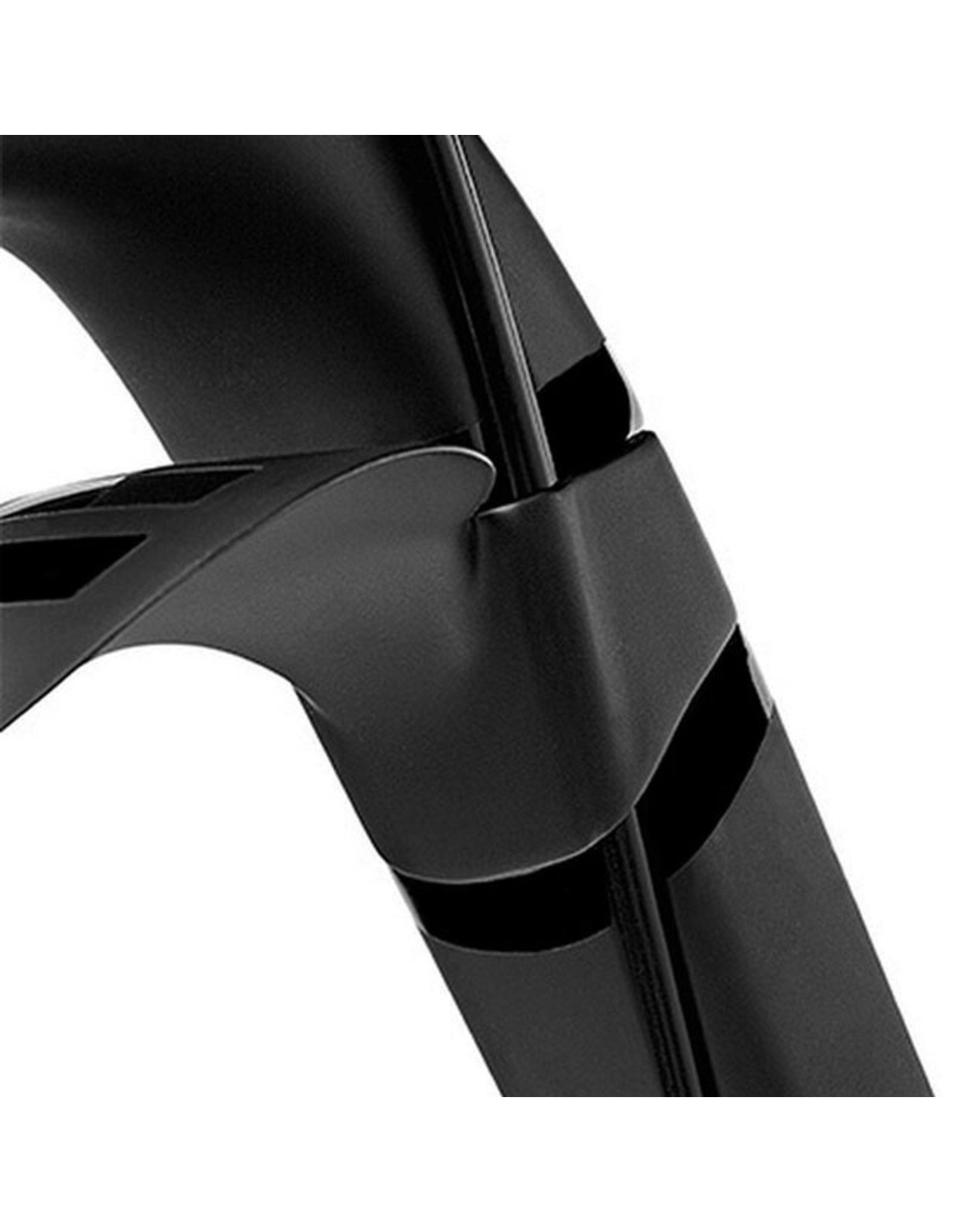

For riders who value functional simplicity, the ENVE Carbon Mountain Fork is a rigid 29" carbon fork built around modern mountain standards and real-world usability. Reversible dropout inserts let you tune handling by switching rake between 44mm and 52mm, while ENVE’s integrated carbon hose clip keeps the brake line tidy without zip ties. A removable mini fender is included for splash and debris control.
Handling tune via flip chips
  • Adjustable rake: 44mm or 52mm (reversible dropout inserts)
  • Designed around modern MTB geometry with rigid simplicity
Brake + tire compatibility
  • Post mount disc brake
  • Rotor sizes: 160mm / 180mm
    (max 180mm)
  • Max tire clearance: 29" x 3.0" (with mini fender)
Boost vs Non-Boost (important)
  • Boost: 15 x 110mm axle, accessory mounts included
  • Non-Boost: 15 x 100mm axle, no accessory mounts
