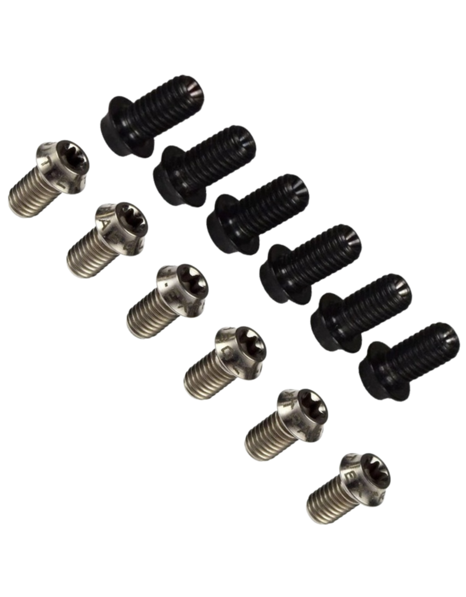

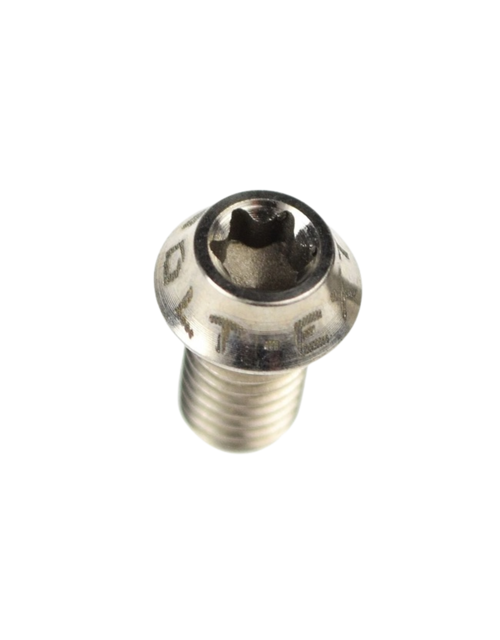

The Extralite Titanium Disc Brake Rotor Bolt Set offers a lightweight upgrade for 6-bolt disc brake rotors without compromising strength or reliability. CNC-machined from Grade 5 titanium (Ti-6Al-4V), these precision fasteners reduce rotating weight while providing the durability required for modern road, gravel, and mountain bike braking systems.
Available in either a natural titanium finish or a durable Black PVD (Physical Vapor Deposition) coating, these bolts combine premium appearance with excellent corrosion and abrasion resistance. As with all rotor hardware, Extralite recommends using an appropriate threadlocker during installation and lightly lubricating the underside of the bolt heads to achieve accurate torque.
Specification Details
Bolt Size M5 × 0.8 × 10 mm
Tool Interface T20 Torx

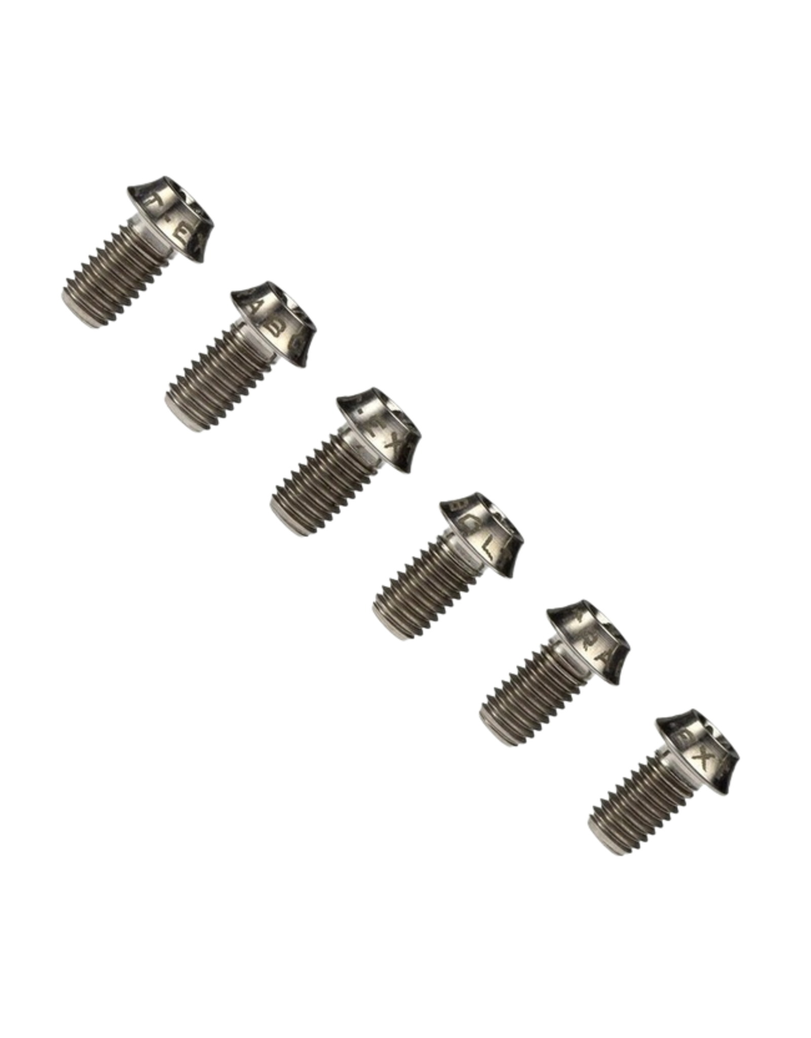

Material Grade 5 Titanium (Ti-6Al-4V)
Weight ~0.85 g each
Finish Natural Titanium or Black PVD
Includes 6 Rotor Bolts

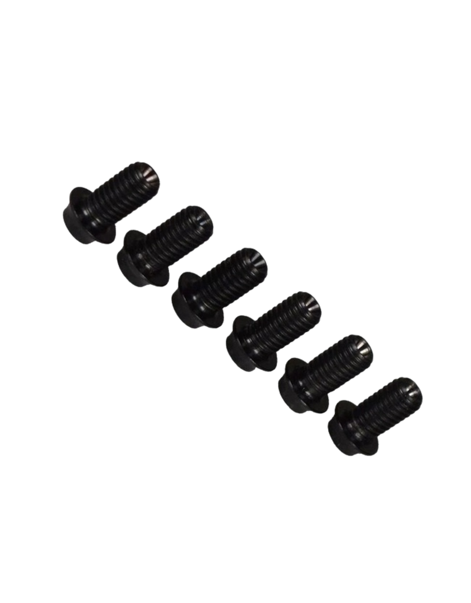

Black PVD Finish
Extralite's optional Black PVD (Physical Vapor Deposition) finish provides more than a stealth appearance. The ultra-thin coating improves resistance to corrosion and surface wear while maintaining the precision fit and dimensions of the original titanium fasteners.
