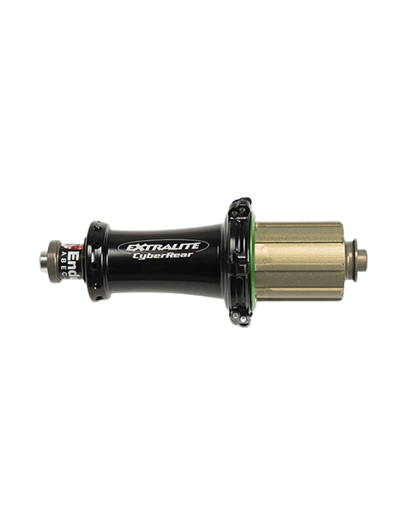

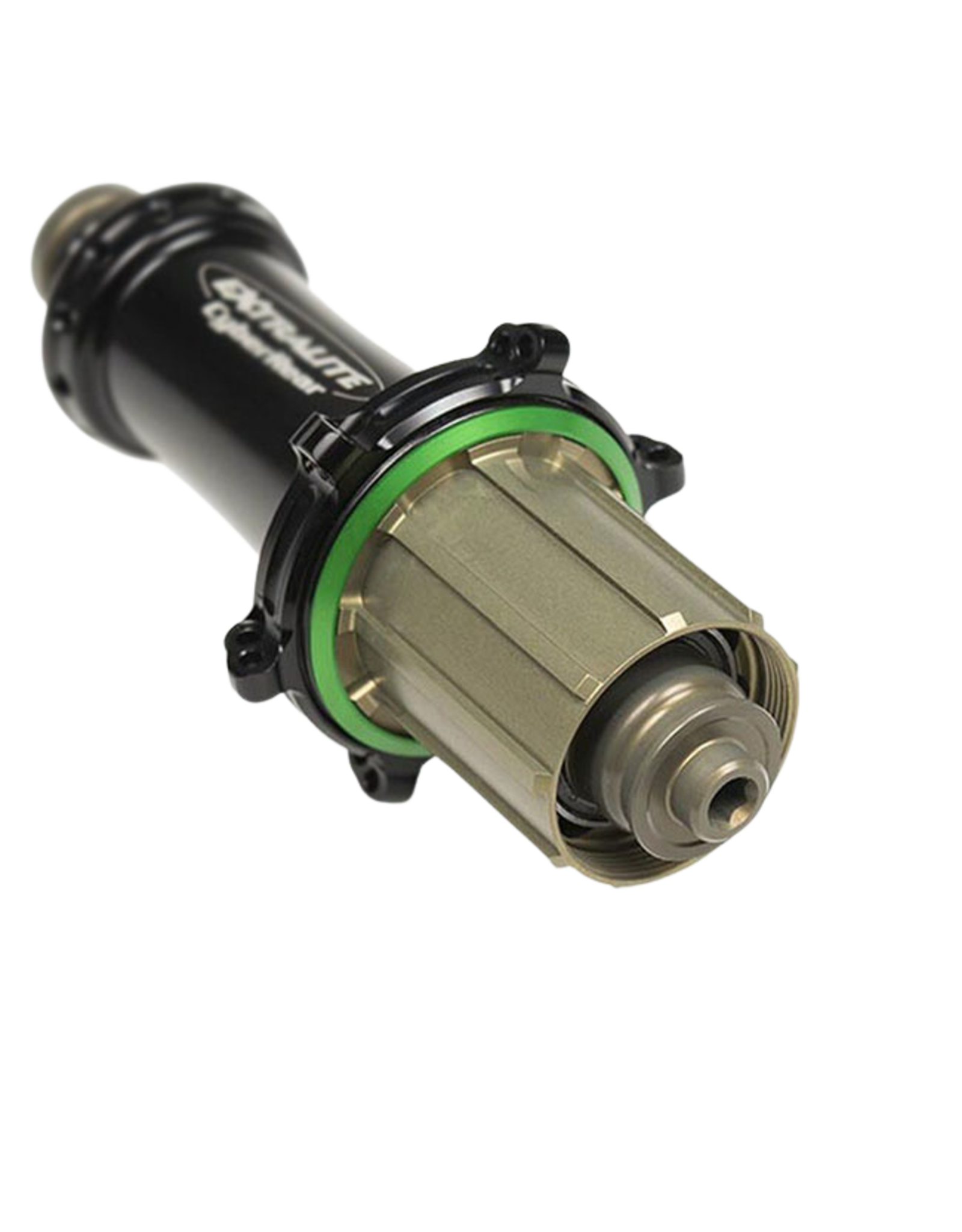

The Extralite CyberRear SP Road Hub brings elite-level precision and ultralight performance to rim brake wheelset builds. Weighing just ~134g, it’s crafted in Italy from 7075TXX aluminum with a titanium freehub mechanism. Its dual-pawl, 32t engagement system ensures fast response and exceptional power transfer.

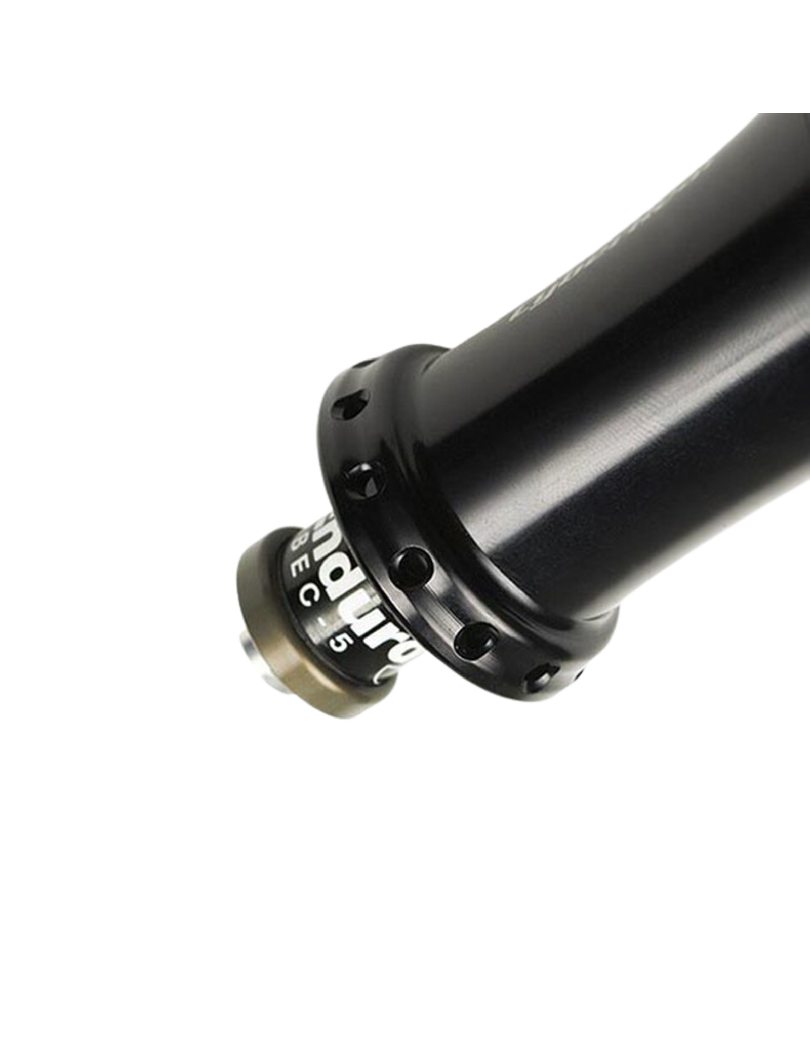

The SP (Straight Pull) configuration enhances tension balance and reduces spoke fatigue for high-performance wheel builds. The Micro-Tuner bearing preload system allows perfect adjustment with minimal friction, while available ceramic bearing upgrades (HDC or XD15) further improve durability and efficiency.
Compatible with Shimano/SRAM 11-speed, XDR, and Campagnolo freehubs, the CyberRear SP combines stiffness, smoothness, and reliability at one of the lowest weights in its class.

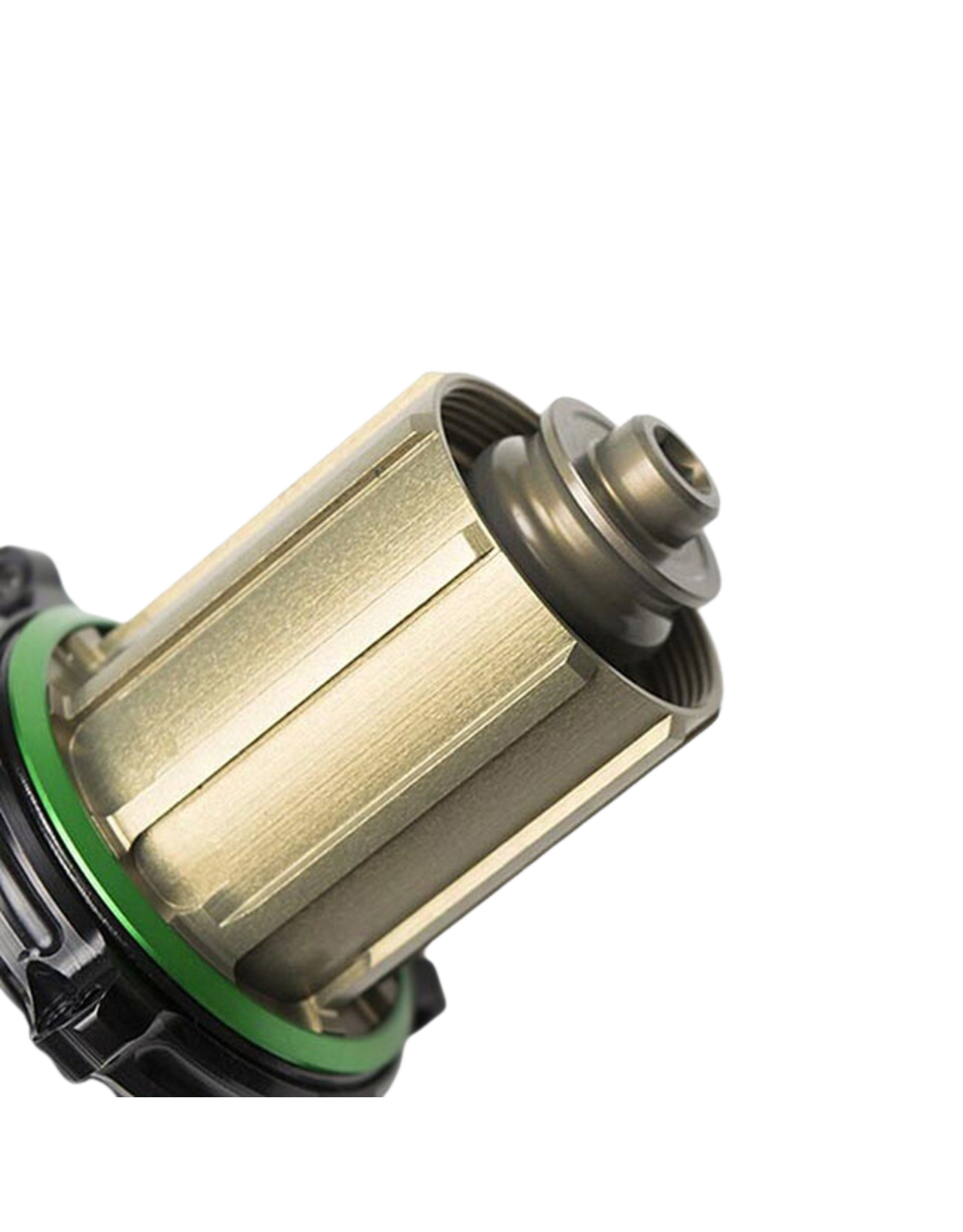

CyberRear Freehub Options
 Shimano Road 11Spd
 SRAM XDR
 Campagnolo Road 11 / 12 Speed

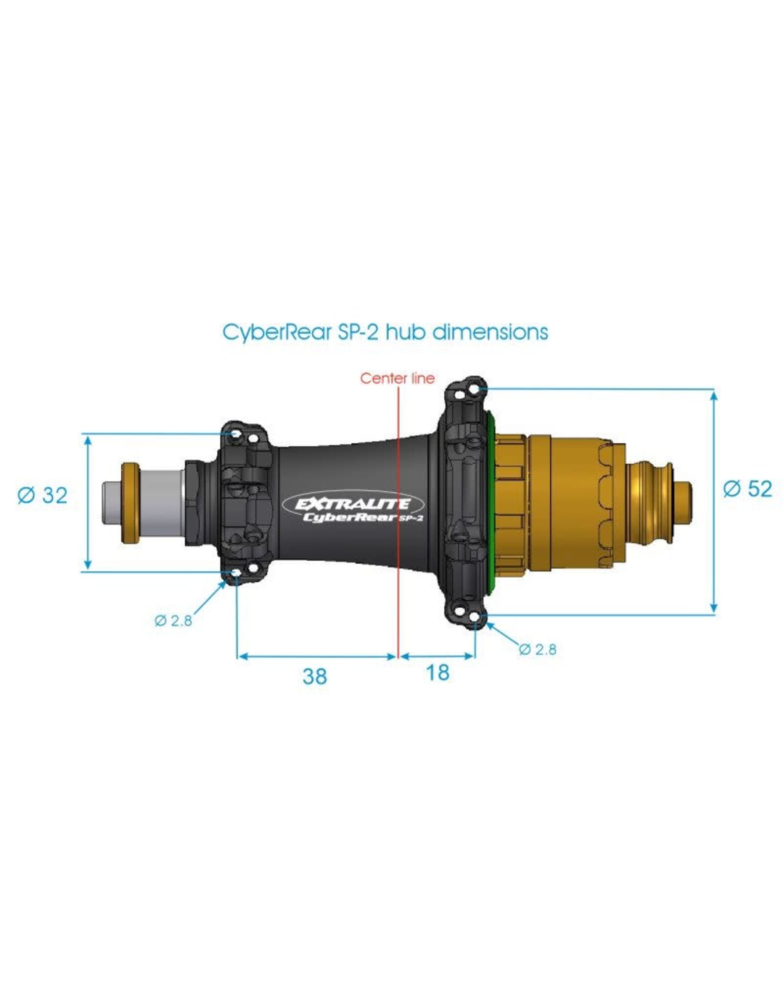

--Wheel Building Dimensions--
  LEFT RIGHT
 Flange Diameter 32.0 mm 52.0mm
 Center to Flange 38.0 mm 18.0 mm
 Spoke Hole Offset 1.5 mm
 Spoke Hole Diameter 2.6 mm
