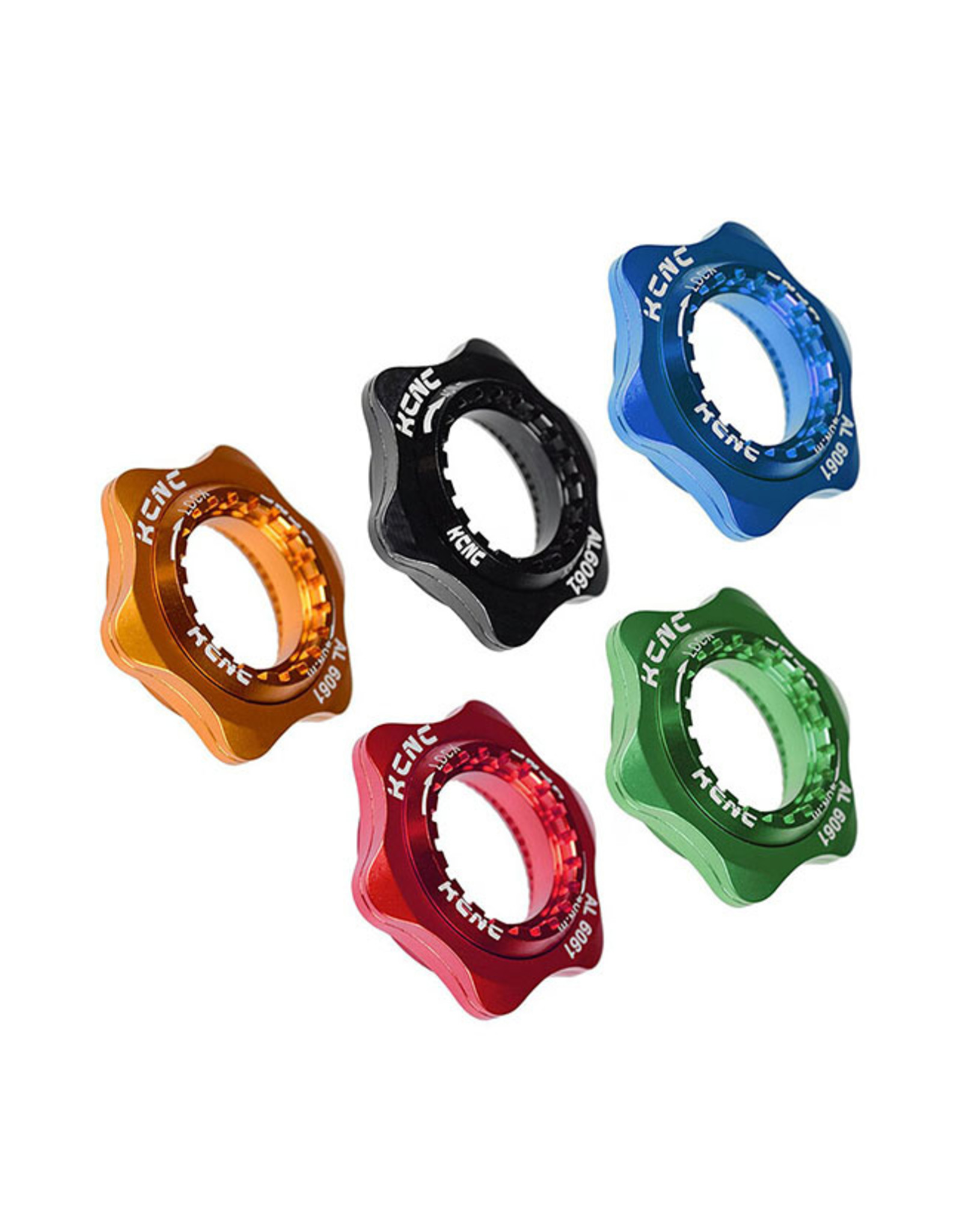

KCNC O/S Centerlock Adapter allows a standard ISO 6-bolt disc brake rotor to be used on a Centerlock hub. It is a practical option for riders who want to run a favorite 6-bolt rotor on a Centerlock wheelset, or keep rotor choices open across different wheel and brake setups.
This oversized version is stocked because it offers broad hub compatibility, fitting setups from quick-release hubs through larger thru-axle applications up to 20 mm. The adapter is machined from 6061 aluminum, weighs approximately 28 g, and installs with an ISIS / Octalink-style bottom bracket tool.

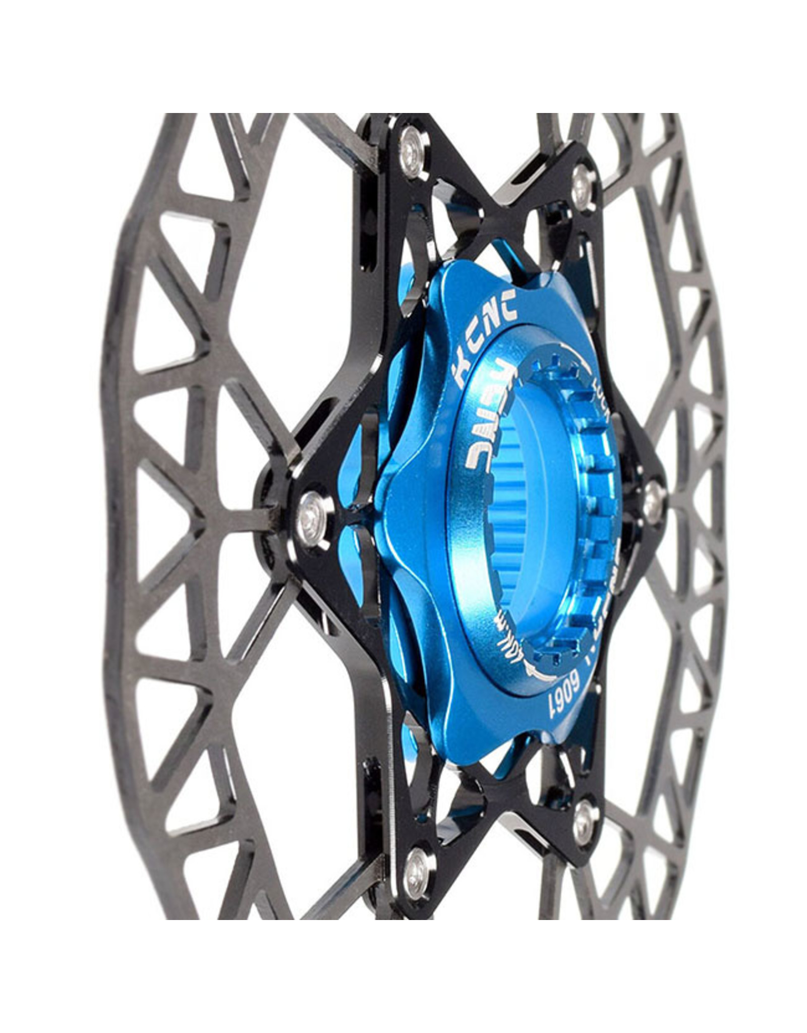

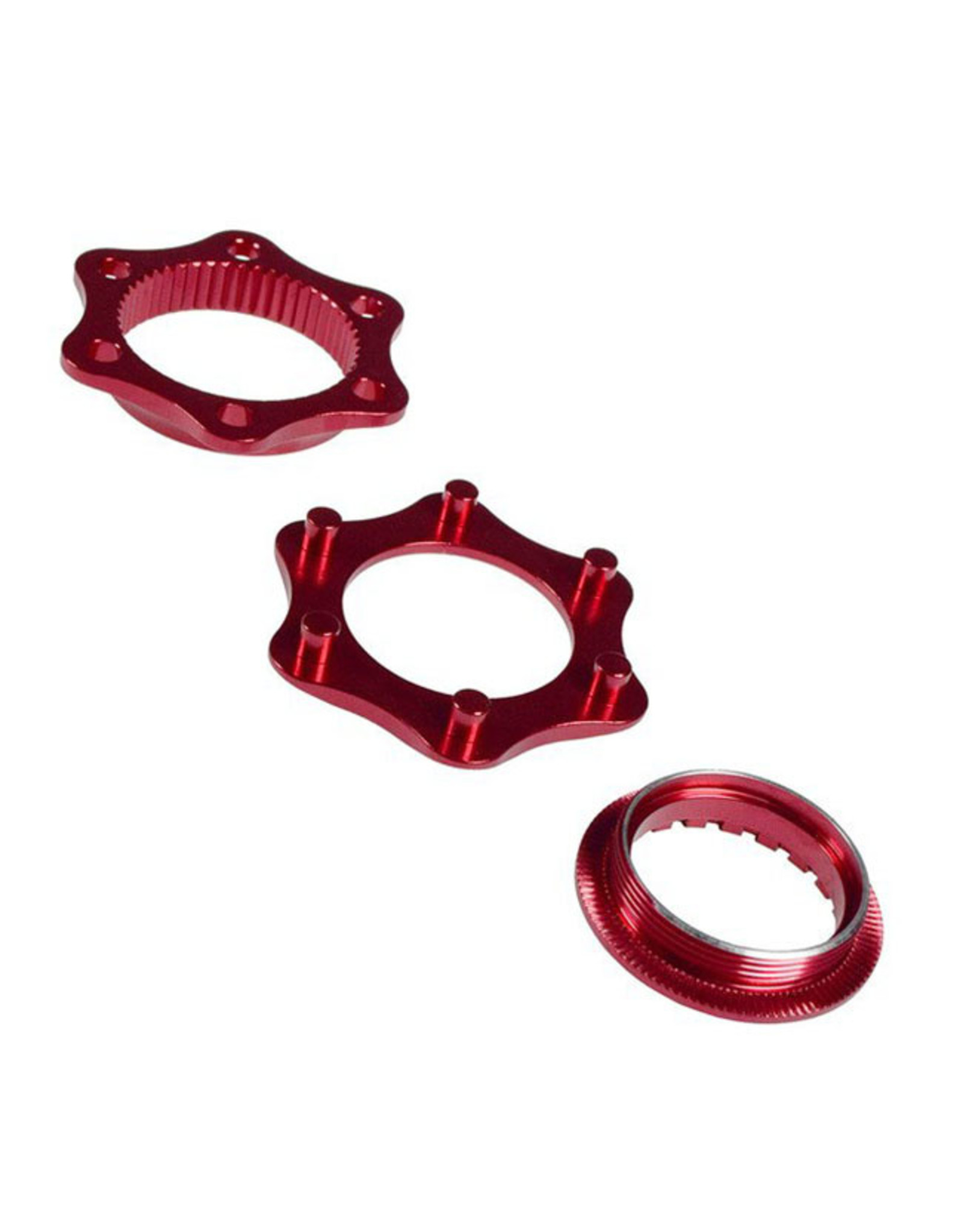

Position the 6-bolt rotor between the adapter’s splined inner plate and outer plate, then mount the assembled rotor and adapter onto the Centerlock hub. Thread the lockring into place and tighten it with an ISIS / Octalink-style bottom bracket tool. KCNC lists 40 Nm as the recommended torque.
