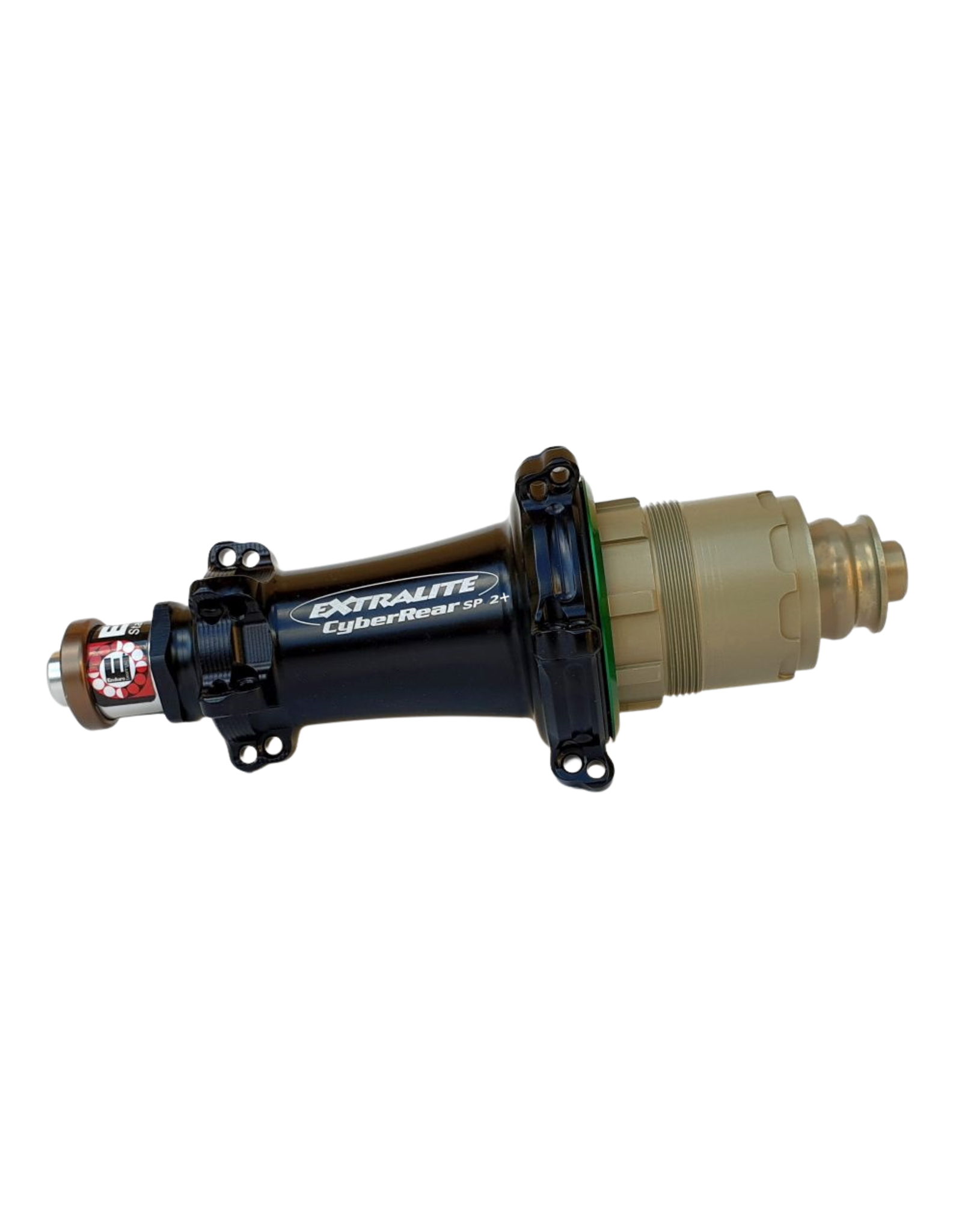

The Extralite CyberRear SP-2+ is Extralite's ultralight straight-pull rear road hub, engineered for custom rim brake wheel builds where low weight, precise engagement, and long-term serviceability remain priorities. CNC machined in Italy from high-strength 7075 aluminum with Grade 5 titanium components, the CyberRear SP-2+ combines refined machining with one of the lightest rear hub platforms available.
The updated hub shell features 2.8 mm straight-pull spoke holes for improved spoke compatibility, a 32-tooth dual-pawl drive mechanism for quick engagement, and Extralite's Micro-Tuner bearing preload system for precise adjustment. Ceramic bearing upgrades are also available for riders seeking the lowest possible rolling resistance.
Fair Wheel Bikes currently offers the CyberRear SP-2+ as part of the complete Extralite Cyber SP-2 Rim Brake Hubset. This page provides technical specifications, wheelbuilding information, and service resources for the rear hub.
Specification CyberRear SP-2+
Weight ~124 - 142 g
Spoke Holes 24h / 28h
Axle Standard QR 5 x 130 mm
Bearing Size 6903 - (1) / 6803 - (1)
Brake Interface Rim Brake
Material 7075 Aluminum / Grade 5 Titanium
Freehub Engagement 32T
Bearing Options XD15 Ceramic, HDC Ceramic, or 440C Stainless

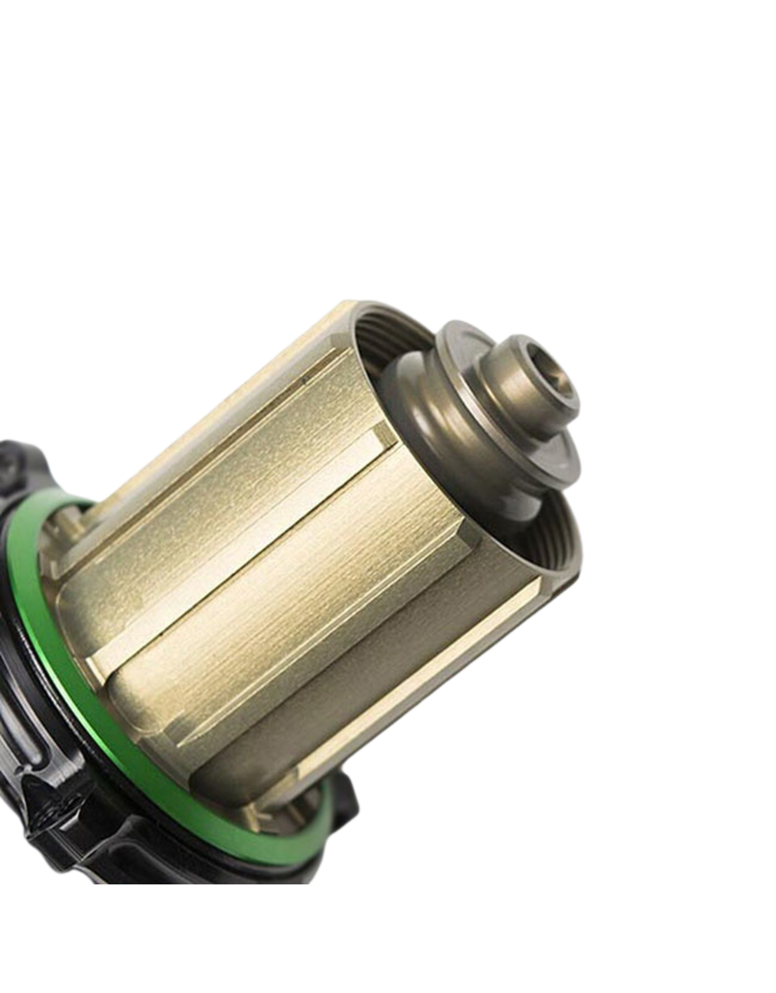

Compatible Freehub Bodies
The CyberRear SP-2+ uses Extralite CyberRear freehub bodies for Shimano HG, SRAM XDR, and Campagnolo cassette standards. Replacement and conversion kits are available for riders changing drivetrains or servicing worn freehub components.
