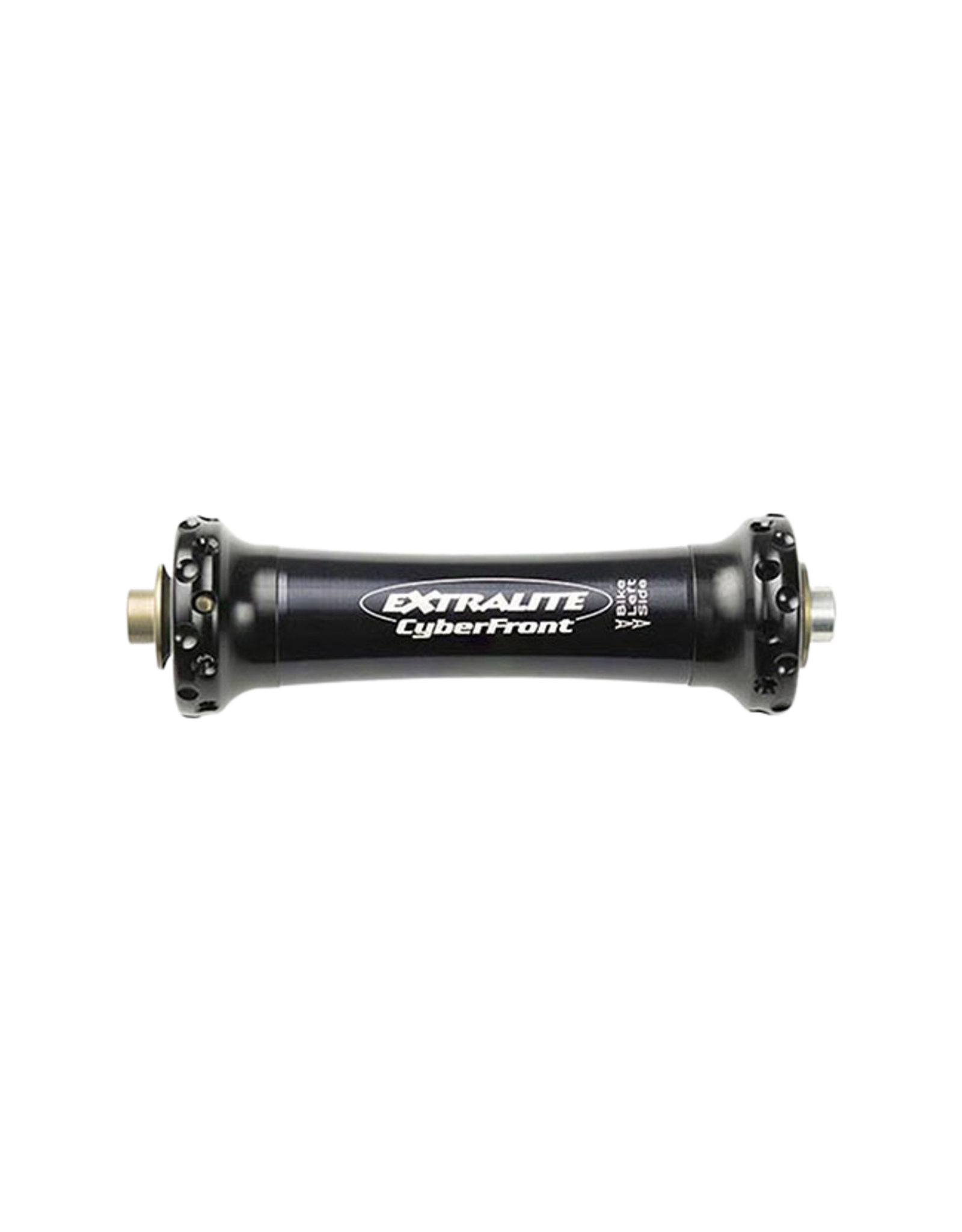

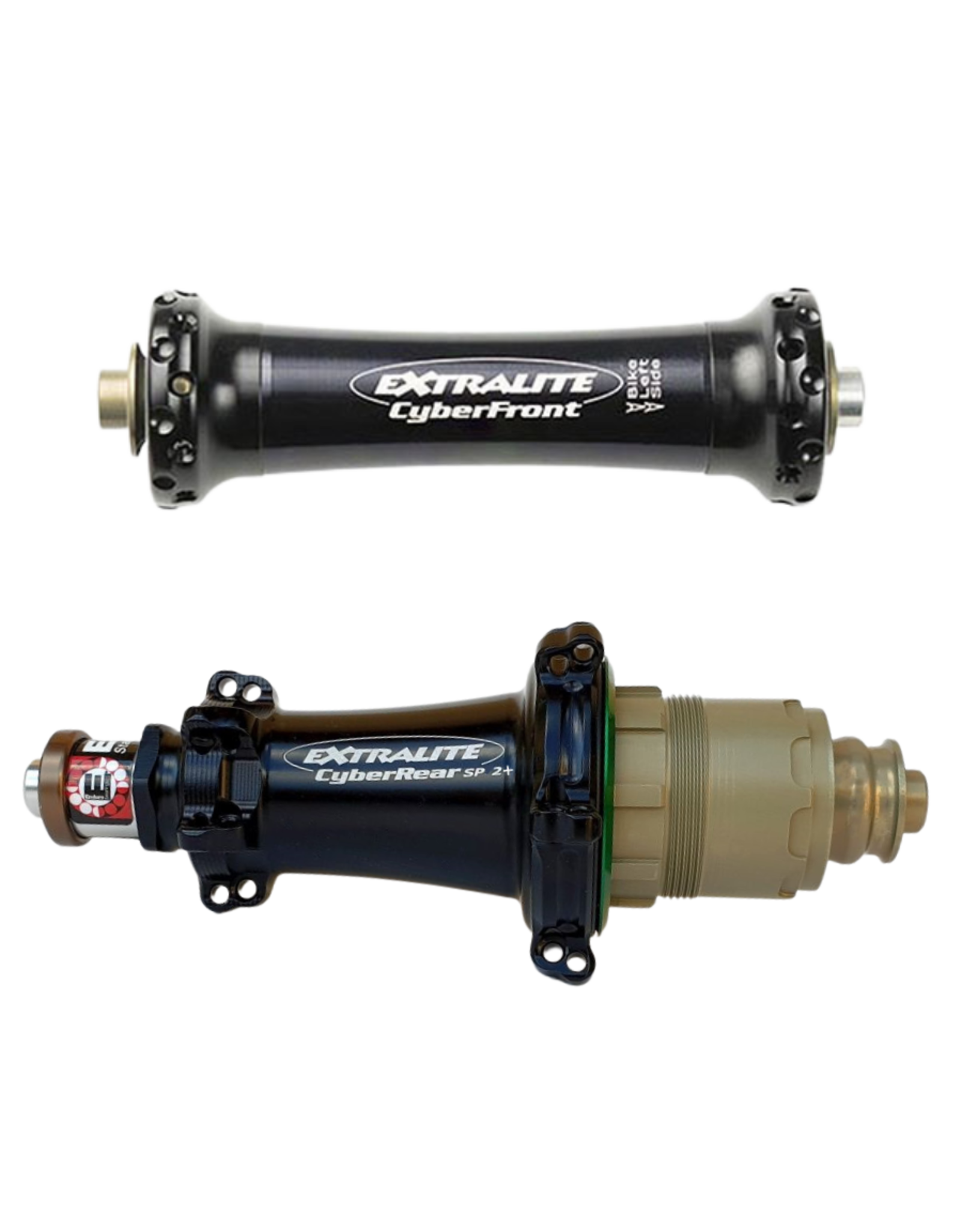

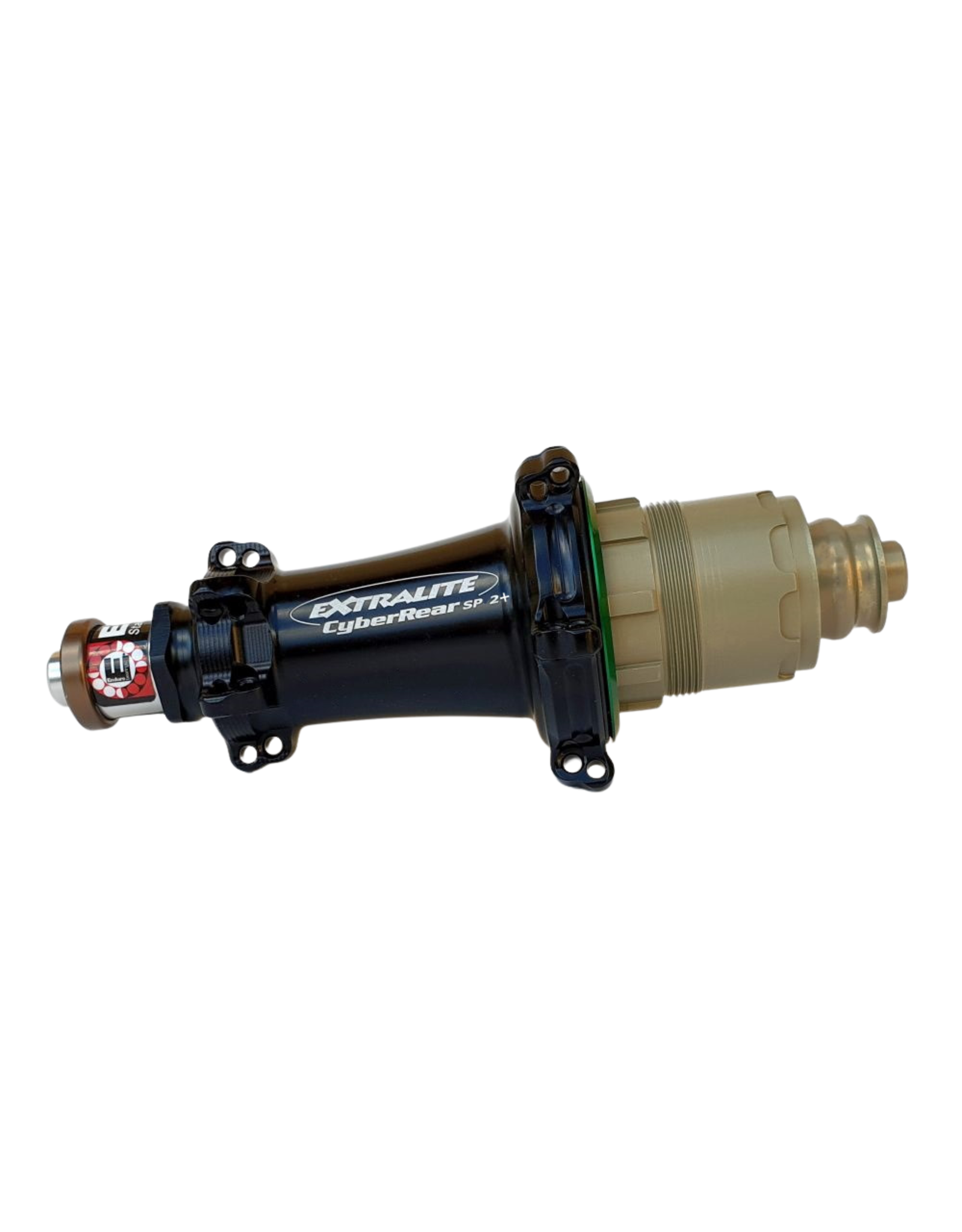

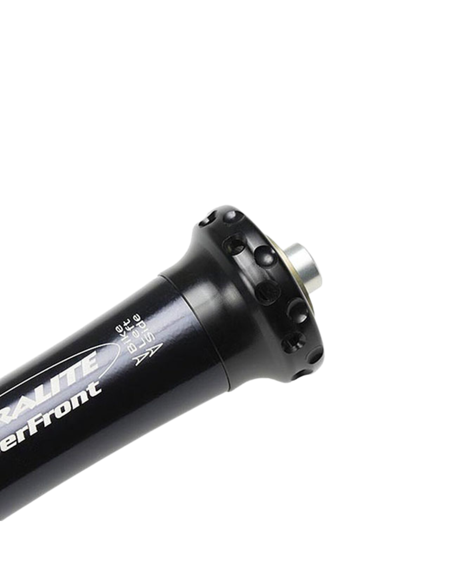

The Extralite Cyber SP-2+ Rim Brake Hubset is built for high-end lightweight rim brake wheel projects where every gram still matters. This hubset pairs the updated CyberFront SP with the CyberRear SP-2+, combining Italian-machined aluminum hub shells, Grade 5 titanium internals, and Extralite’s minimalist hub architecture.
Because rim brake hub availability continues to narrow across the industry, Fair Wheel Bikes offers this product as a complete front and rear hubset only. Available in 20 / 24 hole drilling with either a Shimano 11-speed or SRAM XDR freehub, the Cyber SP-2+ hubset is intended for custom lightweight road, climbing, and rim brake race wheel builds.
Hub Front Rear
Model CyberFront SP CyberRear SP-2+
Weight ~48 g Varies By Freehub
Spoke Holes 20h Front / 24h Rear
Axle Standard QR 5 x 100 mm QR 5 x 130 mm
Brake Interface Rim Brake
Material 7075 Aluminum / Grade 5 Titanium
Freehub Options Shimano 11-Speed or SRAM XDR
Freehub Engagement N / A 32T

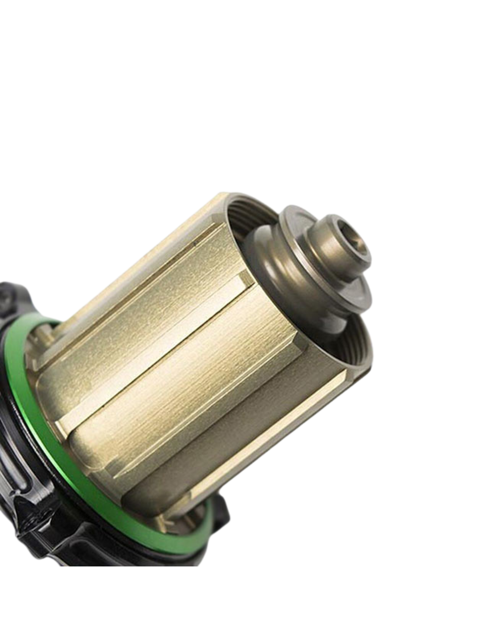

CyberRear Freehub Bodies
The CyberRear SP-2+ is available with either a Shimano 11-speed or SRAM XDR freehub body when purchased as a hubset. Replacement and conversion freehub bodies are also available separately for future drivetrain changes or service.

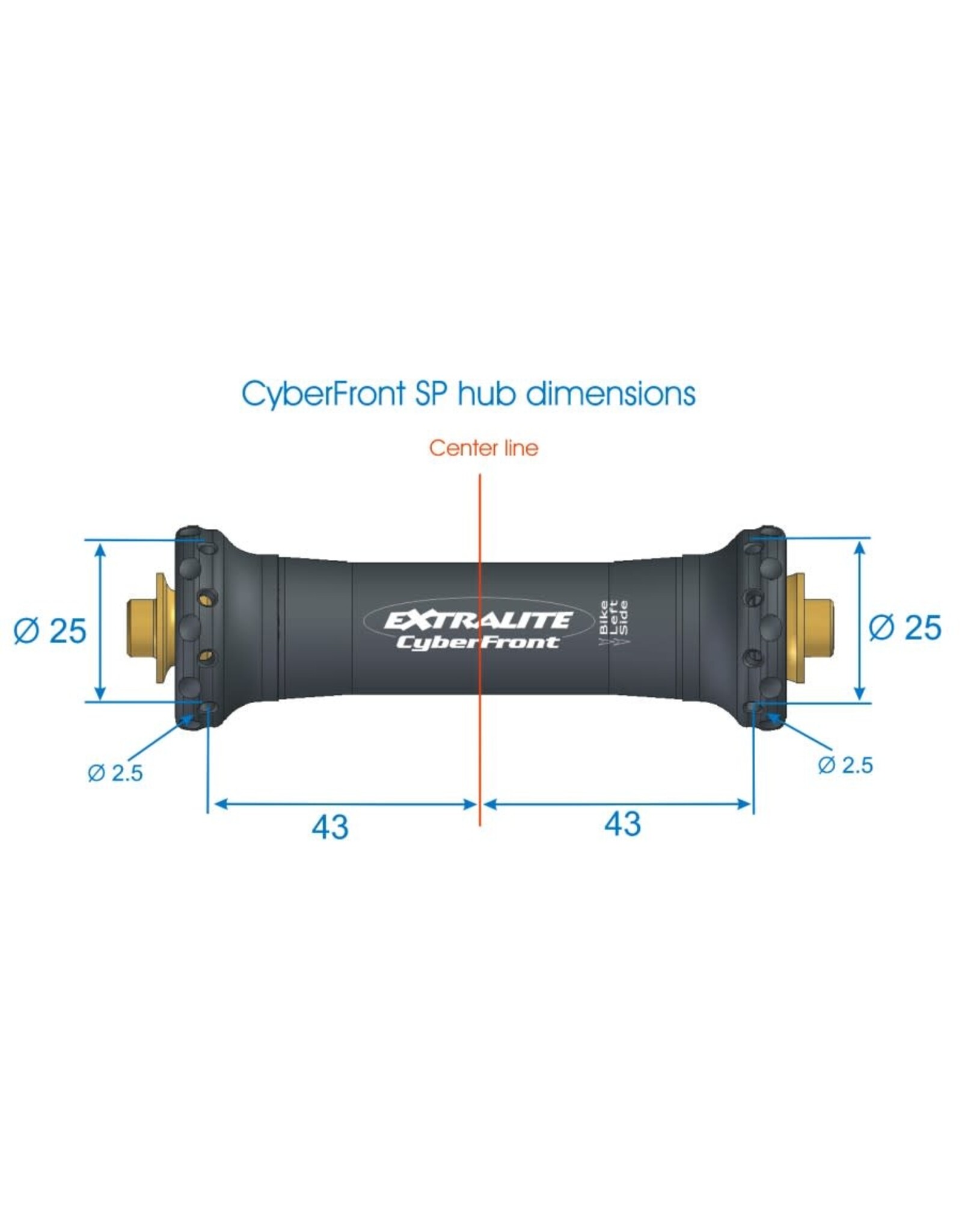

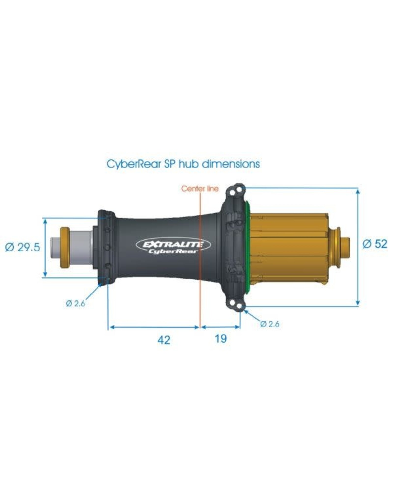

Wheel Building Dimensions Front Left Front Right Rear Left Rear Right
Flange Diameter 25.0 mm 25.0 mm 29.5 mm 52.0 mm
Center To Flange 43.0 mm 43.0 mm 42.0 mm 19.0 mm
Spoke Hole Offset 1.5 mm
Spoke Hole Diameter 2.8 mm
