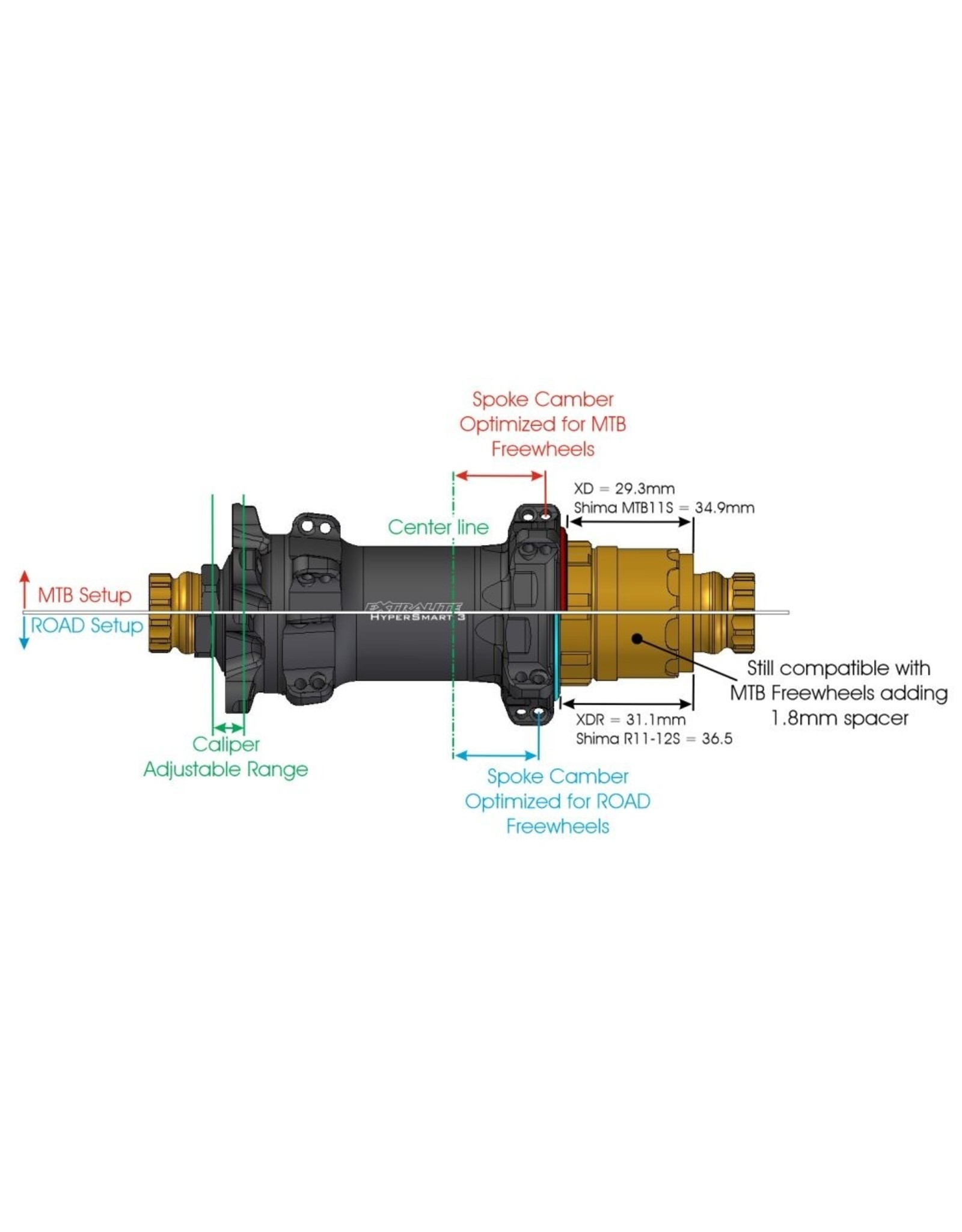

Weight | ~145g |
Spoke Holes | 24h / 28h |
Axle Standard | 12 x 142 mm |
Bearing Size | 6903 - (1)* / 6803 - (1)* |
Brake Interface | 6-Bolt |
*Can be ordered with either XD15 Ceramic, HDC Ceramic, or 440c Stainless Bearings | |
HyperSmart Freehub Options / Engagement | |
R O A D | |
Shimano | Shimano 11Spd - 48t |
SRAM | XDR - 48t |
-- Wheel Building Dimensions -- | ||
LEFT | RIGHT | |
Flange Diameter | 42.0 mm | 48.0 mm |
Center to Flange | 32.0 mm | 22.0 mm |
Spoke Hole Offset | 1.5 mm | |
Spoke Hole Diameter | 2.8 mm | |
*for accurate spoke lengths, please use Extralite's Hyper hub Lacing Instructions |
