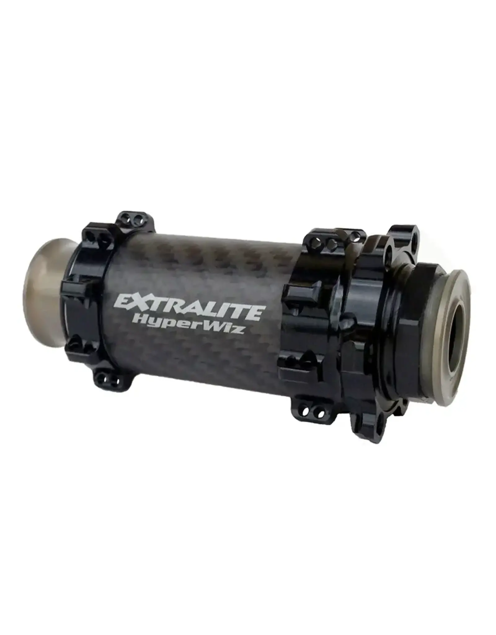

Extralite's RS-1 Hub boasts a unique 27mm composite axle for unrivaled predictive performance in RS-1 forks. With sealed ABEC-5 bearings and straight-pull spokes, it maximizes stiffness and braking torque transmission. The micro-tuner system ensures precise bearing preload, enhancing durability and eliminating rim play. For optimal results, it is advisable to have wheels constructed with Extralite hubs be assembled by a skilled wheel builder. Our team is available to offer tailored advice on rim and spoke selections. Feel free to reach out to us for direct assistance.
Due to the lightweight construction and for optimal performance and durability, service Extralite hubs regularly. Find detailed instructions here. Use Slick Honey for effective lubrication of seals and freehubs.
| Weight | ~87g | |
| Spoke Holes | 24h / 28h / 32h | |
| Axle Standard | T/A 15 x 110 mm | |
| Bearing Size | 27537 - (2) | |
| Brake Interface | 6-Bolt | |
| Compatibility | RS-1 / Boost Torque | |
| *Can be ordered with either XD15 Ceramic, HDC Ceramic, or 440c Stainless Bearings | ||

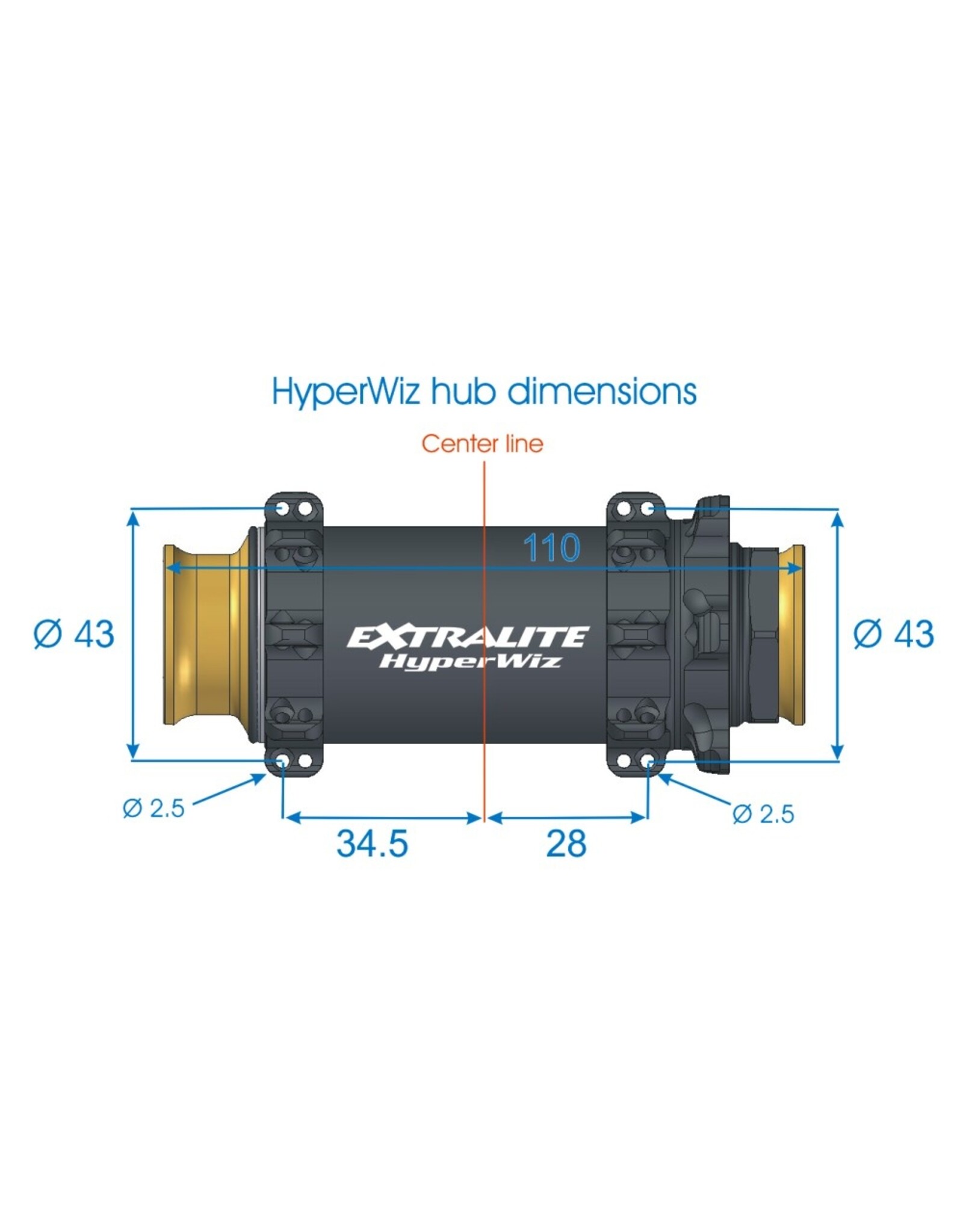

| -- Wheel Building Dimensions -- | ||
| LEFT | RIGHT | |
| Flange Diameter | 43 mm | 43 mm |
| Center to Flange | 28 mm | 34.5 mm |
| Spoke Hole Diameter | 2.5 mm | |
| *for accurate spoke lengths, please use Extralite's HyperWiz Lacing Instructions | ||
