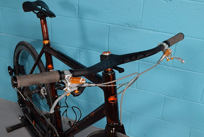

Syncros one-piece handlebar and stem with orange component accents on a custom Crumpton
A Syncros one-piece handlebar and stem, finished with Parts of Passion headset spacers and top cap.
