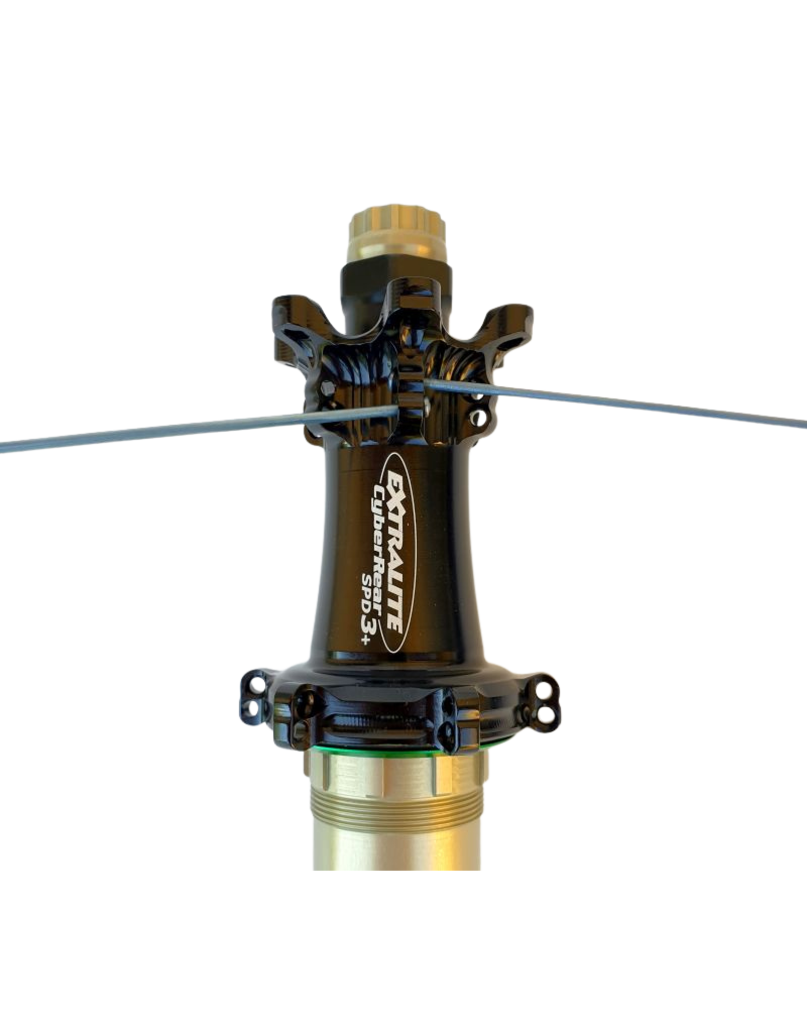

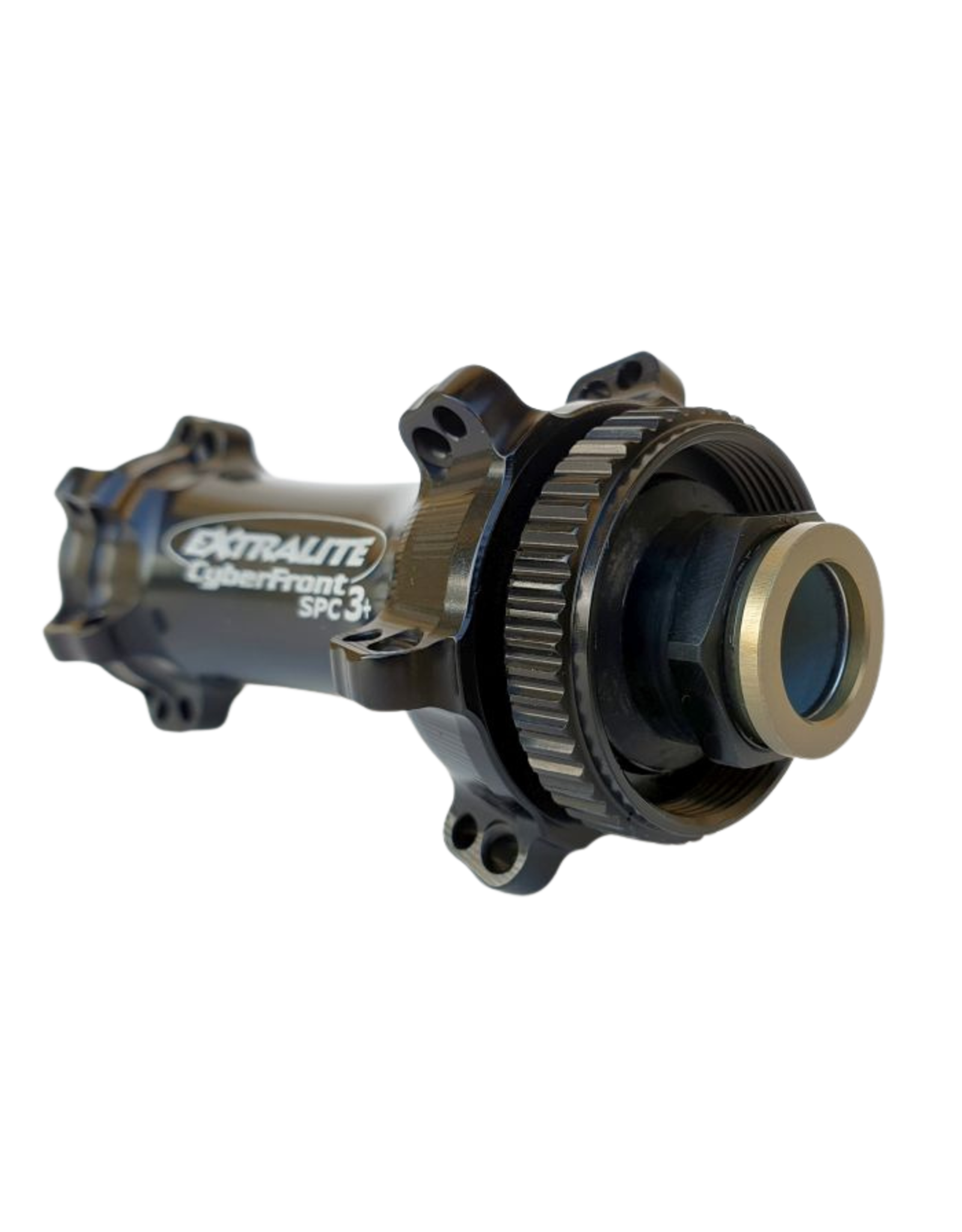

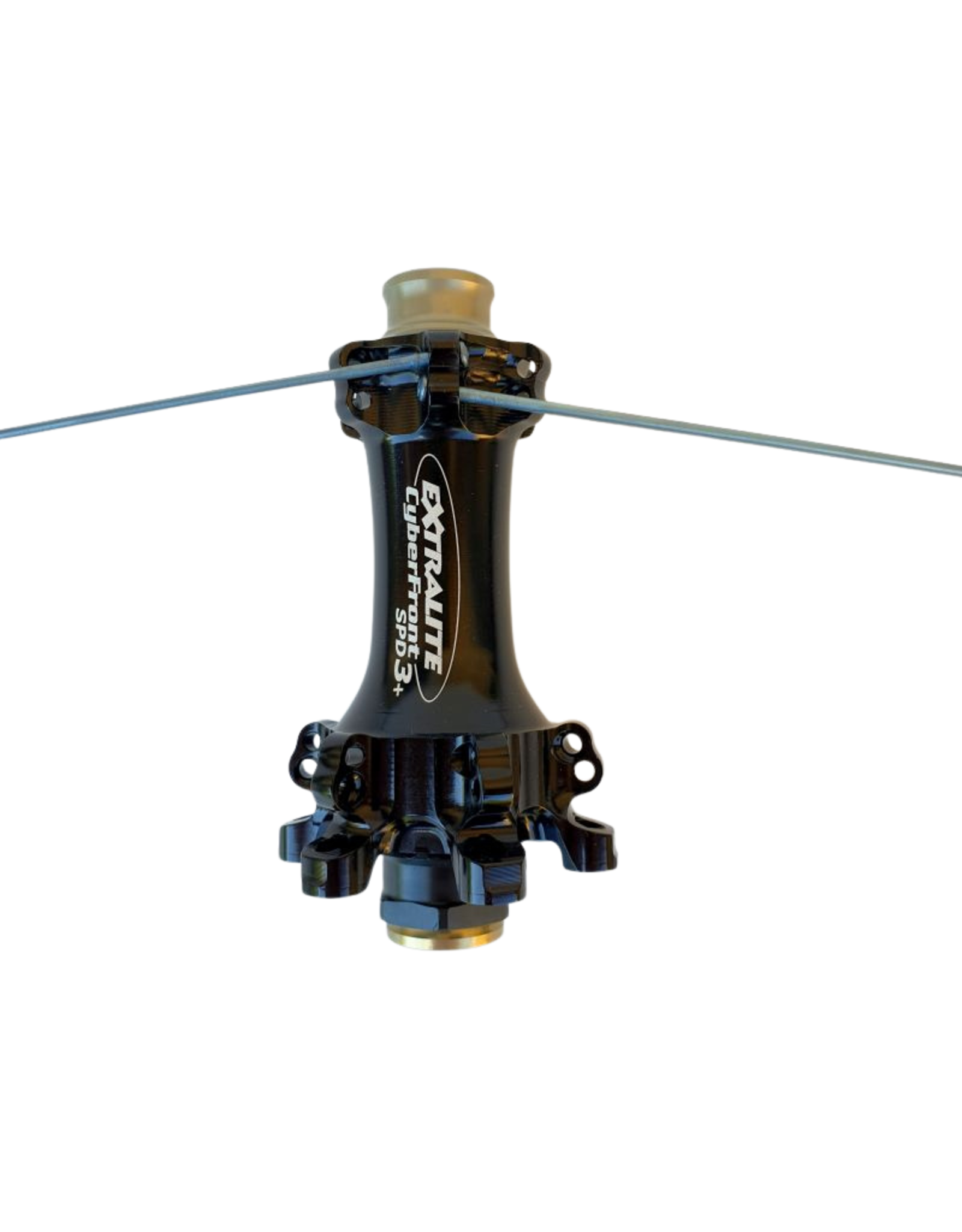

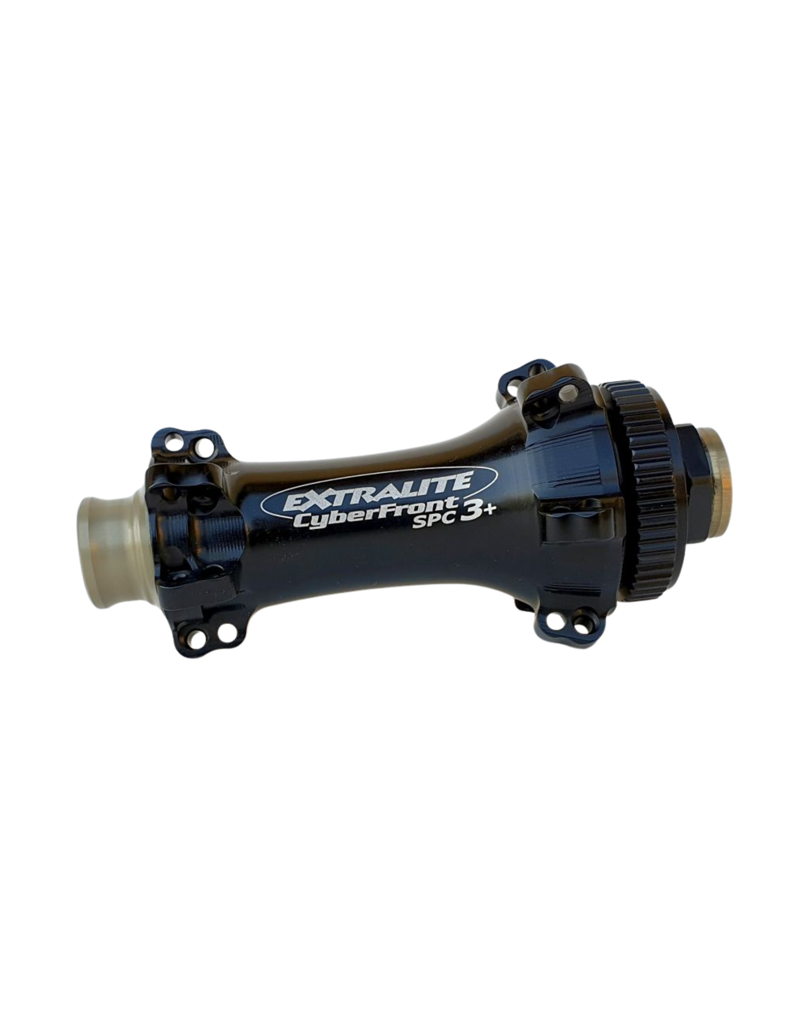

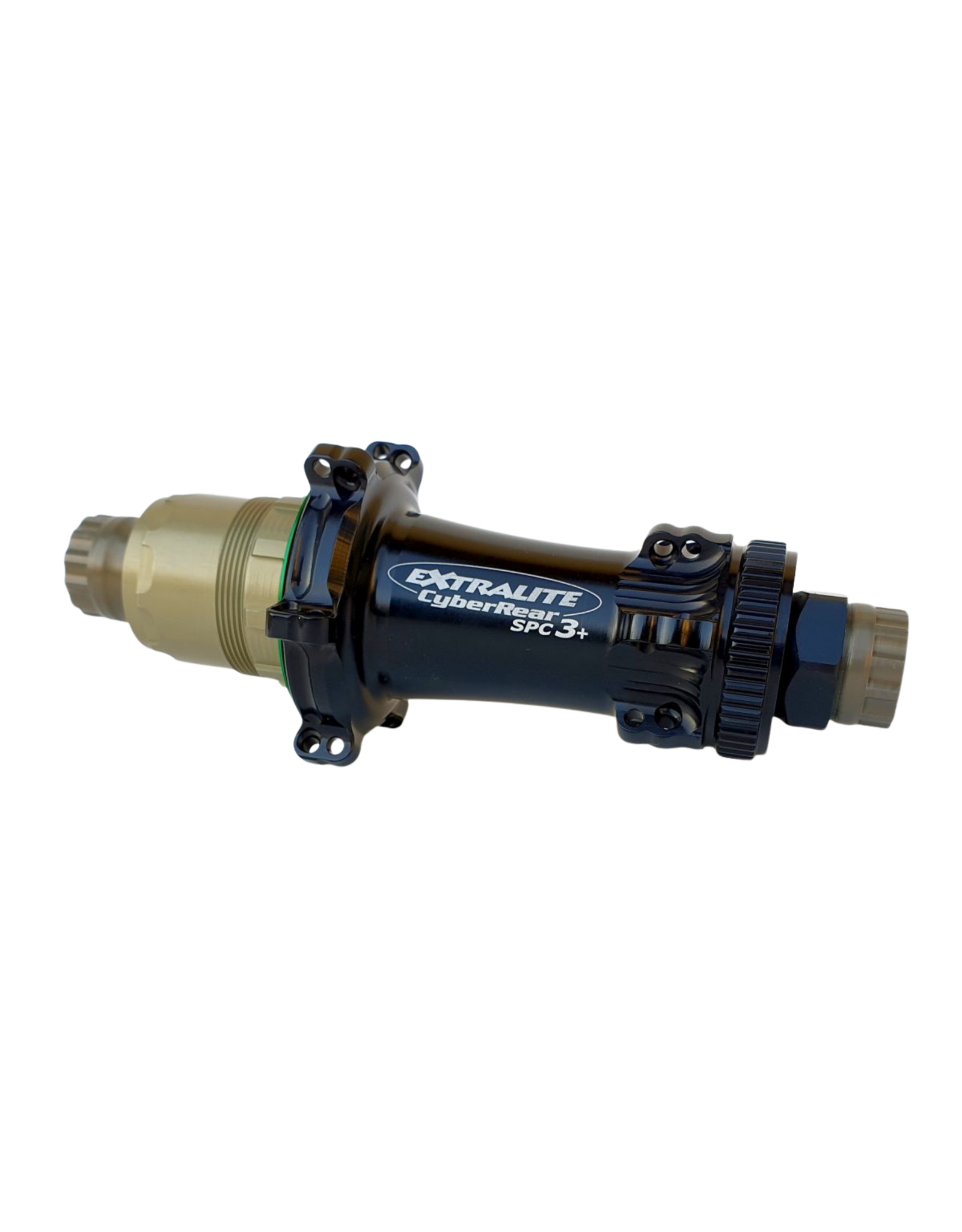

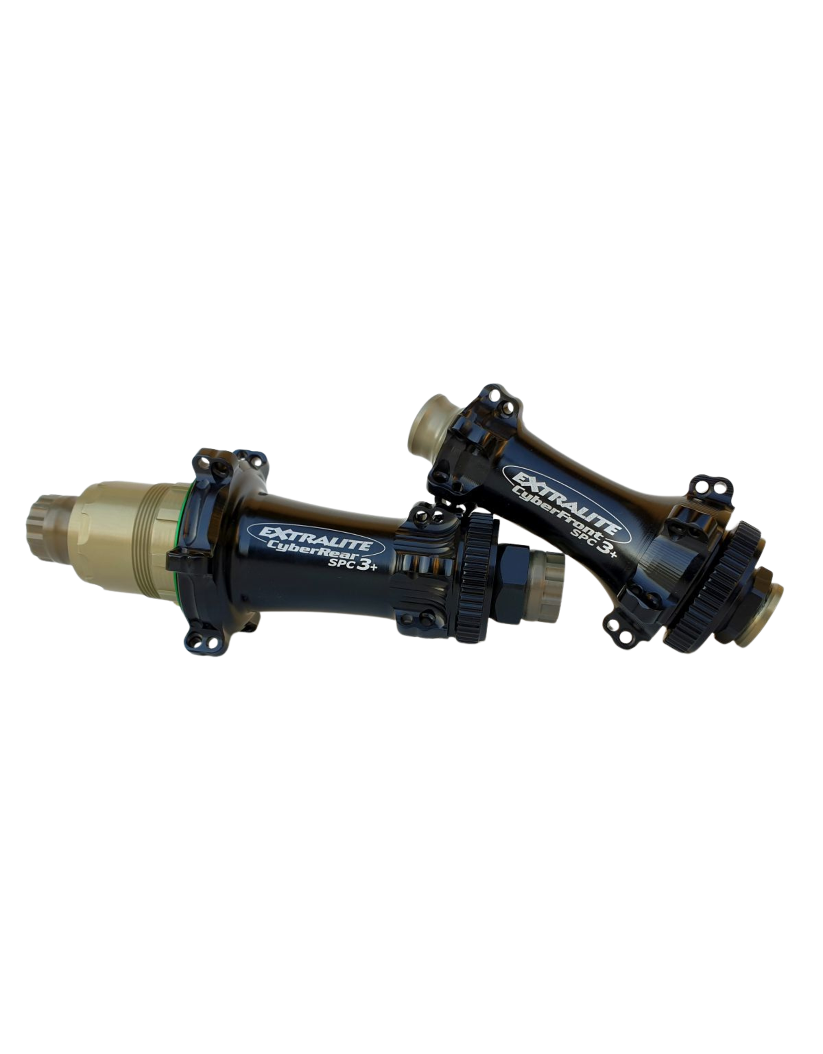

The Extralite Cyber SPC-3+ hubset represents the next evolution of ultralight road disc hubs, now optimized for Centerlock rotor mounting. Combining the CyberFront SPC-3+ (~61g) and CyberRear SPC-3+ (~140–147g depending on freehub), this hubset delivers unmatched stiffness-to-weight for elite road and gravel disc builds.
Machined in Italy from aerospace-grade 7075TXX aluminum and Grade 5 titanium, the SPC-3+ hubs feature cross-laced straight-pull flanges, Extralite’s signature Micro-Tuner preload system, and ceramic or stainless bearing options. Both hubs are EN-tested and approved for riders up to 200 lbs (90 kg).
Together, the pair weighs as little as ~214g, making the Cyber SPC-3+ hubset one of the lightest and most advanced Centerlock options on the market.

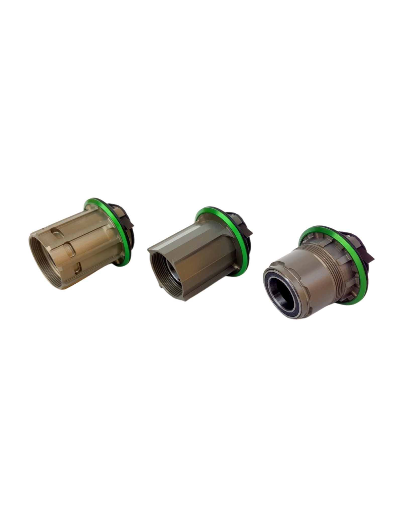

| CyberRear Freehub Options | |
| Shimano | Road 11Spd |
| SRAM | XDR |
| Campagnolo | N3W |
| Road 11 / 12 Speed | |

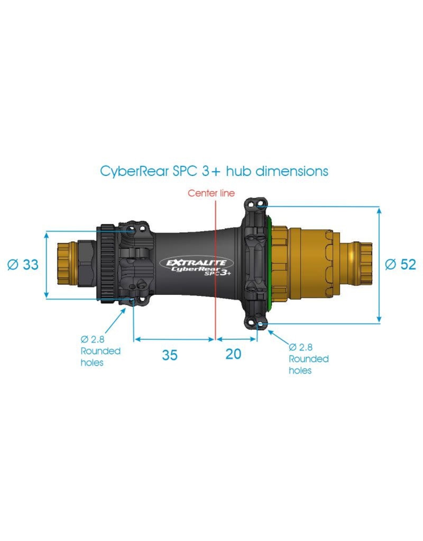

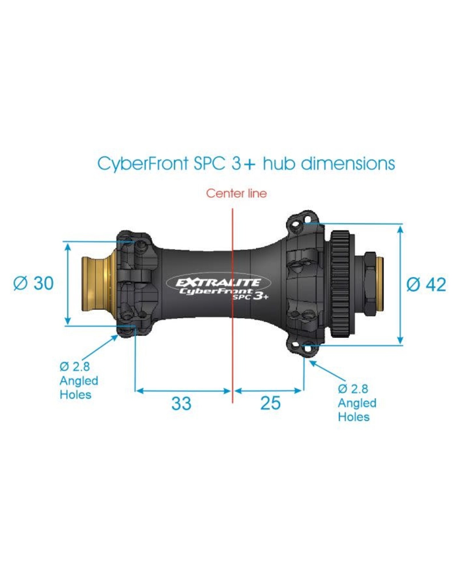

| --Wheel Building Dimensions-- | ||||
| FRONT | REAR | |||
| LEFT | RIGHT | LEFT | RIGHT | |
| Flange Diameter | 30.0 mm | 42.0 mm | 33.0 mm | 52.0 mm |
| Center to Flange | 33.0 mm | 25.0 mm | 35.0 mm | 20.0 mm |

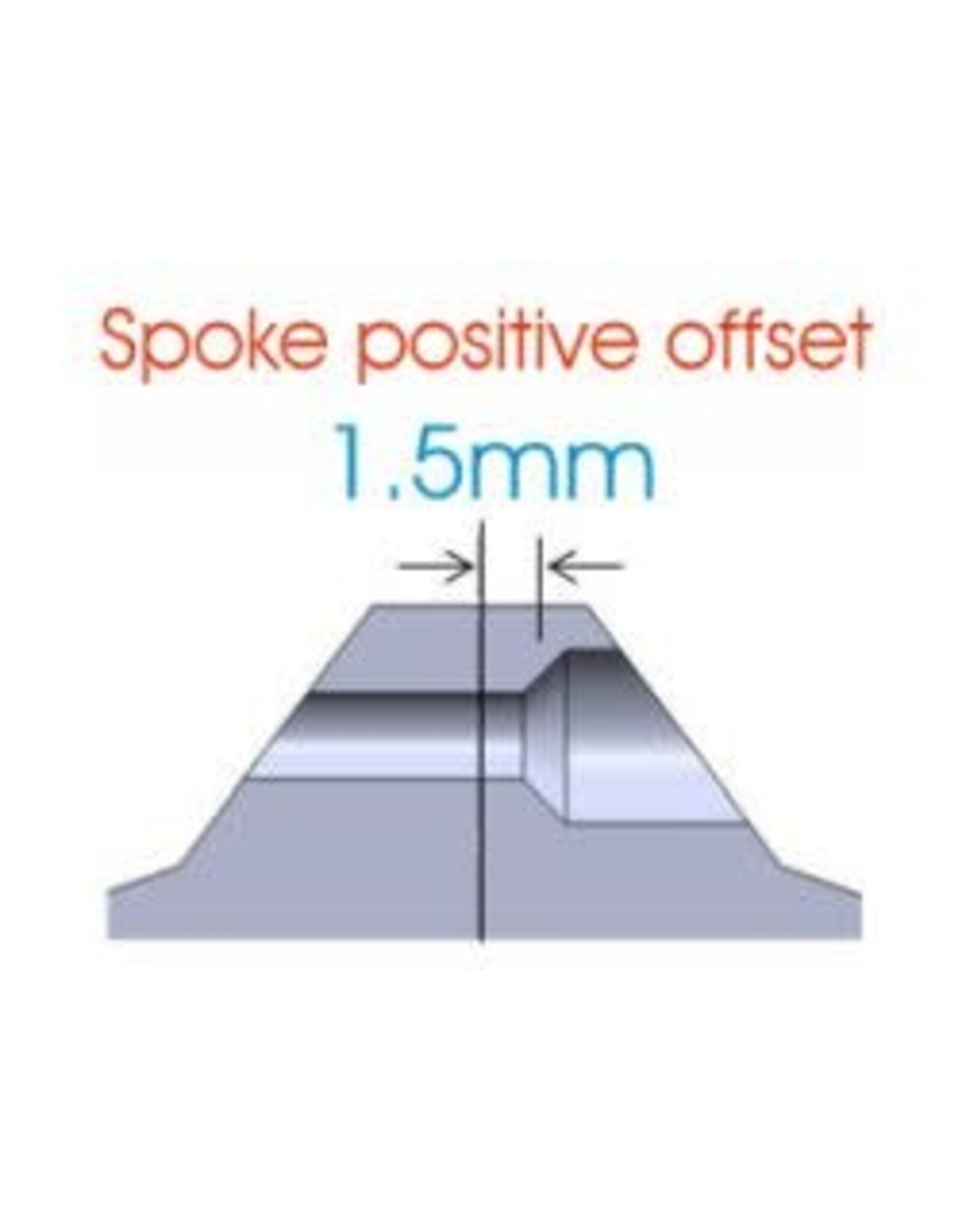

| Spoke Hole Offset | 1.5 mm | |||
| Spoke Hole Diameter | 2.8 mm | |||
| *for accurate spoke lengths, please use Extralite's Cyber SPD3 hub Lacing Instructions | ||||
